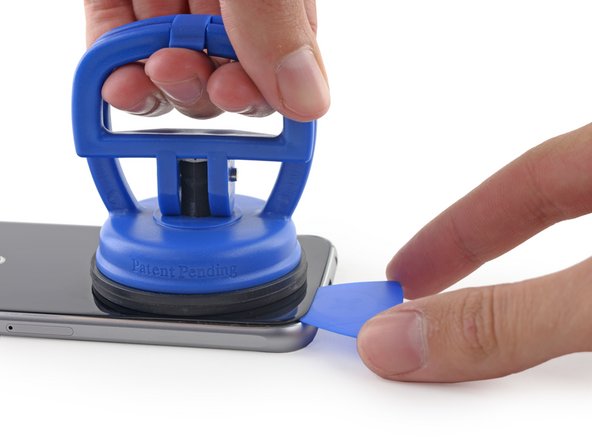

  3. Samsung Galaxy S6 Teardown: crwdns2935265:03crwdnd2935265:01crwdnd2935265:03crwdne2935265:0 Samsung Galaxy S6 Teardown: crwdns2935265:03crwdnd2935265:02crwdnd2935265:03crwdne2935265:0 Samsung Galaxy S6 Teardown: crwdns2935265:03crwdnd2935265:03crwdnd2935265:03crwdne2935265:0
    iOpener
    $24.99
    • The S6 Edge was monstrously hard to open, and odds are the S6 has the same nasty adhesive. This Galaxy looks sleek and talks tough, but we're packing heat—in the form of an iOpener.
    • After wrestling with a brief bout of déjà vu, our trusty Heavy Duty Suction Cup and opening pick get us inside.
    • Looks like the S6 and S6 Edge are going to have a lot in common inside as well as out.

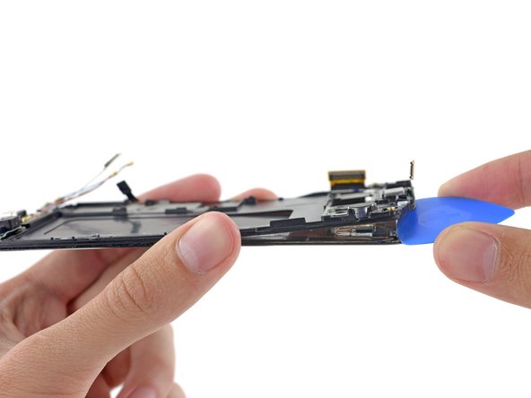

  4. Samsung Galaxy S6 Teardown: crwdns2935265:04crwdnd2935265:01crwdnd2935265:03crwdne2935265:0 Samsung Galaxy S6 Teardown: crwdns2935265:04crwdnd2935265:02crwdnd2935265:03crwdne2935265:0 Samsung Galaxy S6 Teardown: crwdns2935265:04crwdnd2935265:03crwdnd2935265:03crwdne2935265:0
    • The rear panels are so similar we had to put them to the side-by-side comparison test: as we should have expected, the S6 Edge (right) panel is slightly smaller than the standard S6 (left) panel.
    • The adhesive stayed globbed to the midframe this time, hiding the screws. We had a moment of panic, thinking we'd have to go through the display, S5-style.
    • But after peeling up the adhesive, all screws are present and accounted for—and now, removed!

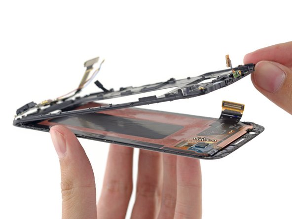

  5. Samsung Galaxy S6 Teardown: crwdns2935265:05crwdnd2935265:01crwdnd2935265:01crwdne2935265:0
    • It's time to blow this Galaxy wide open.
    • Removing the midframe reveals... an S6 Edge?
    • Maybe not—but it takes a keen eye to spot the difference. Apart from a slight rejiggering of the vibrator placement, these internals are a dead ringer for that other flagship Samsung smartphone we tore down recently.

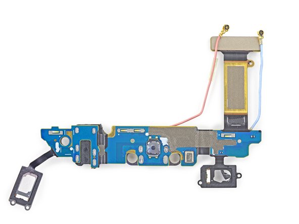

  12. Samsung Galaxy S6 Teardown: crwdns2935265:012crwdnd2935265:01crwdnd2935265:03crwdne2935265:0 Samsung Galaxy S6 Teardown: crwdns2935265:012crwdnd2935265:02crwdnd2935265:03crwdne2935265:0 Samsung Galaxy S6 Teardown: crwdns2935265:012crwdnd2935265:03crwdnd2935265:03crwdne2935265:0
    • We attempt to pry up the daughterboard, but are thwarted by soft button LED cables.
    • The soft button LED cables are trapped between the display and the display backing frame.
    • So we pry up the display frame to release the daughterboard.

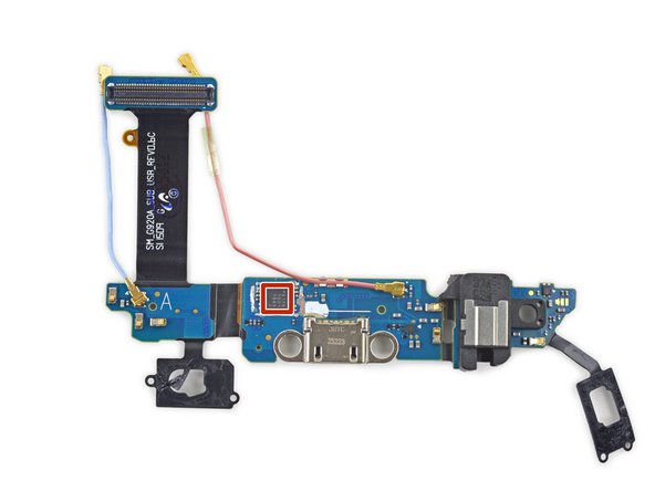

  13. Samsung Galaxy S6 Teardown: crwdns2935265:013crwdnd2935265:01crwdnd2935265:03crwdne2935265:0 Samsung Galaxy S6 Teardown: crwdns2935265:013crwdnd2935265:02crwdnd2935265:03crwdne2935265:0 Samsung Galaxy S6 Teardown: crwdns2935265:013crwdnd2935265:03crwdnd2935265:03crwdne2935265:0
    • Once extricated, the daughterboard provides a clear view of its audio jack and space-aged microUSB (2.0) port.
    • This represents another seeming step backwards from the S5, which packed a 10x faster USB 3.0 port.
    • Onboard, we spy a single IC:
    • Cypress 3175 1501 1885 (likely touch or fingerprint sensor controller)
