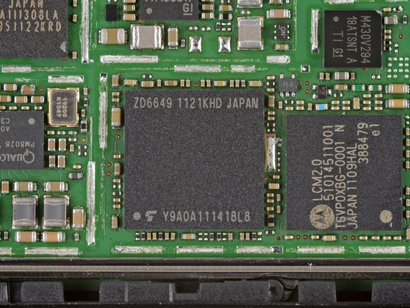

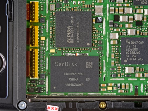

  20. Motorola Droid RAZR Teardown: crwdns2935265:020crwdnd2935265:01crwdnd2935265:03crwdne2935265:0 Motorola Droid RAZR Teardown: crwdns2935265:020crwdnd2935265:02crwdnd2935265:03crwdne2935265:0 Motorola Droid RAZR Teardown: crwdns2935265:020crwdnd2935265:03crwdnd2935265:03crwdne2935265:0
    • Teardown update: We discovered some interesting chip changes inside a newer Droid Razr. They include:
    • SanDisk SDIN5C1-16G NAND flash that replaces the Toshiba THGBM4G7D2GBAIE unit
    • ELPIDA B8164B3PF-8D-F RAM takes place in the Samsung K3PE7E700M-XGC1 RAM location
    • Toshiba Y9AOA111418L8 replaces the Hynix H90H1GH51JMP chip that sits atop the TI OMAP 4430 processor
