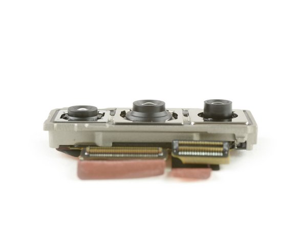

    • The three rear cameras get by with just two connectors—the main camera and the monochrome camera share one port, while the telephoto camera gets the other all to itself.
    • From the side we can compare the relative elevations:
    • Left: 20 MP (monochrome ƒ/1.6). Middle: 40 MP (main camera ƒ/1.8). Right: 8 MP (telephoto ƒ/2.4)
    • Lastly, we've got all four eyes lined up for inspection, including the P20 Pro's selfie cam with only 24 MP.

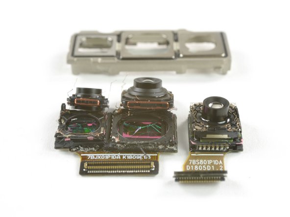

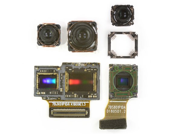

  8. Huawei P20 Pro Teardown: crwdns2935265:09crwdnd2935265:01crwdnd2935265:03crwdne2935265:0 Huawei P20 Pro Teardown: crwdns2935265:09crwdnd2935265:02crwdnd2935265:03crwdne2935265:0 Huawei P20 Pro Teardown: crwdns2935265:09crwdnd2935265:03crwdnd2935265:03crwdne2935265:0
    • Oh what the heck. We're as curious as you are, so here are the triplets completely dissected. You won't get more teardown for your money—wait, this is free.
    • And while we're at it, let's also take a closer look at the sensors.
    • In the middle is the 1/1.7 inch RGB sensor, with the 1/2.7 inch monochrome sensor cozying up to its left. On the right we see the telephoto with a 1/4 inch sensor.
    • Probably some sort of memory near the image sensors for the first two cameras from the left.

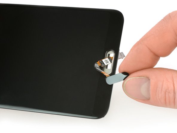

    • Display separated, we're left with not much intel. However, one item does remain.
    • Some gentle prying and the home button is freed!
    • Lacking Face ID hardware or iris scanning, this phone still uses the "archaic" physical button. No word on whether it's locked to its motherboard.
    • In an unusual twist, the proximity and brightness sensor is buried under the display in the midframe—making for a rather anticlimactic end to our teardown.
