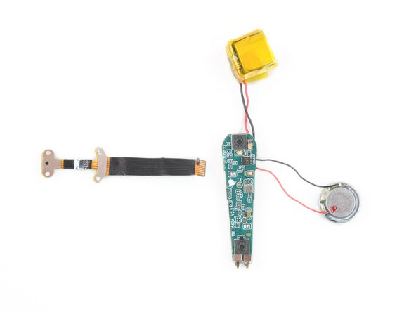

    • Since at first we're not succeeding, we pry, pry again with some heat and a deft spudger. The buds finally give up their (decidedly non-modular) internals: motherboard, driver, and battery.
    • On this side of the motherboard we find:
    • Indicator LED
    • Spring contacts for touch controls
    • Spring contacts for charging the buds in their case

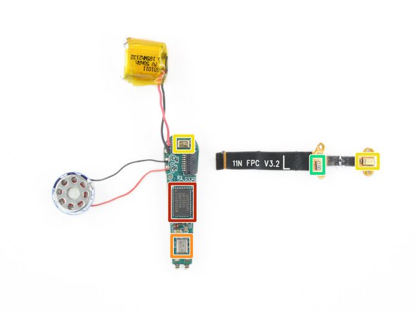

    • The silicon is a little more fun on the reverse side:
    • Airoha AB 1562 Bluetooth audio SoC (single chip solution)
    • Main microphone
    • Active noise cancellation microphones
    • Proximity sensor for in-ear detection
  7. Fairphone True Wireless Earbuds Teardown: crwdns2935265:07crwdnd2935265:01crwdnd2935265:03crwdne2935265:0 Fairphone True Wireless Earbuds Teardown: crwdns2935265:07crwdnd2935265:02crwdnd2935265:03crwdne2935265:0 Fairphone True Wireless Earbuds Teardown: crwdns2935265:07crwdnd2935265:03crwdnd2935265:03crwdne2935265:0

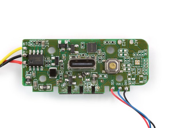

    • No adhesive for its protective sleeve, but this battery is certainly securely soldered.
    • It provides 1.85 Wh (500 mAh @ 3.7 V) which ought to re-juice those twin 0.1 Wh earbud batteries a handful of times.
    • The rest of the cables are similarly soldered, we also spot a simple hall effect sensor up top to track the lid state (open/closed).
    • This charging case seems to have enough room for no-fuss ribbon cables and power connectors, without much risk of disconnection. Fairphone may have fair reasons, but repairs—and device life—will certainly suffer without these aids.

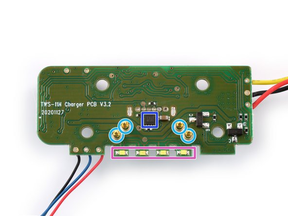

    • Before we go, let's snack on some charging case chips:
    • ETA Solutions ETA9697 linear charger
    • BJL2025
    • USB Type-C charging connector
    • Pairing button
    • Pogo pins for charging earbuds
    • Prisemi P14C1N OVP Load Switch
    • Charge indicator LEDs
