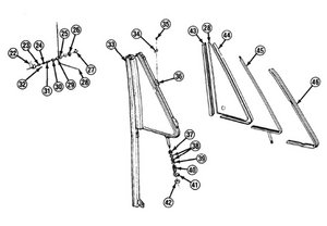

Bob, lets see if this helps a bit:)
"• If replacing vent window, perform DISASSEMBLY steps 2 and 3.
• If removing vent window assembly (17), perform steps 1-4.
1. Remove screw (5) and slide up cover (3). Remove bolt (4), From inside of door, remove bolt (1) and reinforcement (6). Remove spacer (2).
2. Remove 2 screws (10) and spacers (11). Remove screw (12).
3. Remove screw (16). Loosen screw (9). Peel top of window glass run (14) from door (13), Peel edge of window glass run from vent window assembly (17). Pull vent window assembly and window glass run from door, and remove vent window assembly from
window glass run.
4. Remove screw (9), retaining nut (7), and bumper (8) if damaged.
5. Slide window glass (18) forward to disengage forward window regulator assembly roller (21) from notch in sash channel (20). Push window glass forward, then tilt up until rear window regulator assembly roller is disengaged. Place window glass and sash channel assembly in level position and pull straight up and out of door (13).
6. Remove pin (32) and pull off handle (22), plunger (23), and spring (24). Remove screw (31) and stud (30). Remove washer (29), plastic washer (25), plate (27), and spacer (26) from vent window glass (28).
7. Remove rivet (35) and sash hinge (34) from frame hinge (36), Straighten tab on tab washer (41), remove nut (42), tab washer, spring (40), spring retainer washer (39), 2 washers (38), and stop (37). Discard rivet.
8. Remove sash (45) from frame (33). Remove weatherstrip (46) from frame.
Hope this helps, good luck.
