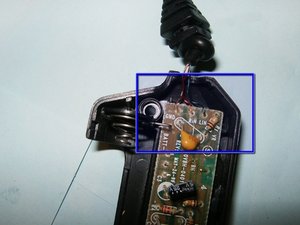

both subs are not working
When i move the wires around they go on and turn off when i move it and i have opened them up and every thing looks fine i do not no what to do.

Adam Thompson,"i move the wires around they go on and turn off when i move it" indicates either a bad solder connection or broken wires. You have not told us where you wiggle the wires to make it work. If it is by the audio connector, replace it using this guide. If it is by the bass amplifier, open it up and take a look at the solder connections on there. I attached a few images that should help you to identify the wires and connections.
Hope this helps, good luck.
