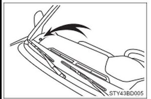

Why don’t my headlights turn off on auto
Headlights will turn on with auto setting on headlights switch but will not turn off

Hi @markduane
Check that the headlight light sensor, located on the passenger side of the dashboard (see image) is not covered or dirty, preventing it from detecting when it is light enough not to have the headlights on.
