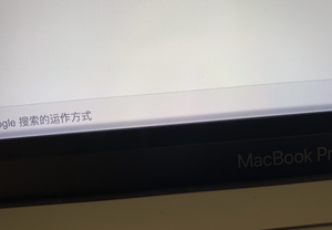

Horizontal lines on top and bottom screen
Hi i have huge horizontal semi transparent lines on top and bottom of my 2016 touchbar retina macbook pro 13inch.
Other symptoms includes No audio devices found(cant play sound)
Is there any possible reasons for this? I highly doubt is a software problem.
Update (04/08/2019)
hey guys an update on my issue, i never went for a fix, the problem went away after i left it to rest for a few days, i believe its an overheat issue. my screen has been working fine for the past few months since reporting this. Not sure it will come back, but this is definitely a faulty hardware, and Apple is not admitting it!
Affected model: 2016 Macbook Pro touch bar
Update (22 July 2020)
I never went for a fix till now and using the same mac, the problem still comes and go, usually happen when overheating/heavy usage. I brought my macbook for de-dusting the fans and apply new heat paste for my processor in hope that it can reduce overheating issues, replacing the whole display costs too much.
Apple did an update for this issue for the FlexGate issue: 13-inch MacBook Pro Display Backlight Service Program. Sadly it doesn’t cover the T-CON issues.
