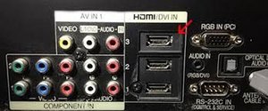

The TV needs to have a HDMI connection available. These connections (ports) can be found, depending on the make and model of the TV, on the back, on either side or behind a panel on the front of the TV.
If it is a full size port that is not a problem. All you need then is a micro HDMI to HDMI cable to connect between the two devices.
This is what the different size HDMI cable plugs look like.
This is what it might look like on the back of your TV
If you do have a HDMI port available on your TV, connect the Asus (make sure it is switched off before you do this) to it with the appropriate cable, switch the input of your TV away from the antenna to the correct HDMI input, (if you have more than one) using the input button on the remote control of the TV and switch on your Asus, you should see on the TV what is being displayed on the Asus.
