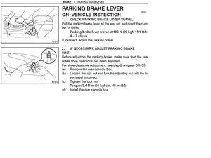

My e brake is not holding my rear wheels anymore. How can I adjust.

Kevin Turcios , besides all the good points that leebeme is making, check the attached image for the adjustment. Hope this helps, good luck.
