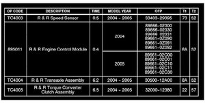

Code p0741 tans converter lockup solenoid. Need how to replace solenoid

P0741 Toyota - Torque Converter Clutch Solenoid Performance
Possible causes
- Low transmission fluid level
- Dirty transmission fluid
- Faulty torque converter clutch solenoid valve
- Torque converter clutch solenoid valve harness or connectors
- Torque converter clutch solenoid valve circuit is open or shorted
- Transmission internal mechanical problem
Befroe doing anything, take it to your dealer and have them check it. There is a service bulletin out that adress this issue specifically. "
TSB number TC008-04
Title:
M.I.L. "ON" DTC P0741
Models:
'04 - '05 Corolla (1ZZ-FE)
November 22, 2004
Introduction
Some 2004 - 2005 model year Corolla vehicles may exhibit M.I.L. "ON" with DTC P0741 (Torque Converter Clutch Solenoid Performance). Production changes have occurred to correct this condition. Follow the repair procedure to address those vehicles that exhibit the condition.
NOTE :The repair procedure must be followed closely to assure that only the affected part is replaced, as multiple possible causes are listed.
Applicable Vehicles
^ 2004 - 2005 model year Corolla vehicles equipped with 1ZZ-FE engine produced BEFORE the Production Change Effective VIN shown below.
SO THAT MEANS BEFORE VIN # 1NXBR3#E#52369427
Production Change Information
Warranty Information
Applicable Warranty*:
R & R of the Speed Sensor, Transaxle, and Torque Converter Clutch Assembly are covered under the Toyota Powertrain Warranty. This warranty is in effect for 60 months or 60,000 miles, whichever occurs first, from the vehicle's in-service date.
R & R of the Engine Control Module is covered under the Toyota Federal Emissions Warranty. This warranty is in effect for 96 months or 80,000 miles, whichever occurs first, from the vehicle's in-service date.
See if you can get anything resolved through Toyota first. Hope this helps, good luck.
