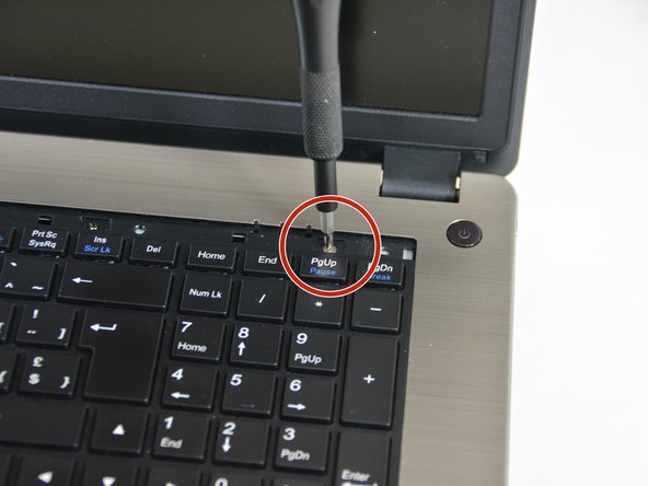

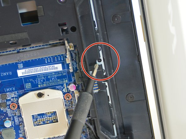

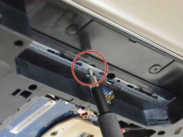

    • Once the bottom cover is removed you can start disassembling the keyboard.
    • Start by turning the computer over and then unscrew the screw shown in image 2 of this step.
    • Then using the screwdriver unscrew the bar that hides the screws fixing the keyboard.

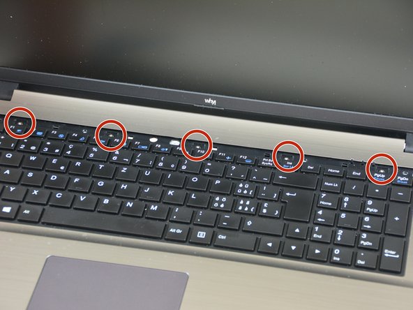

    • Once the bar hiding the fixing screws of the keyboard is unclipped we see the tip of the screwdriver.
    • Now find the 5 screws fixing the keyboard.
    • Unscrew the 5 screws.

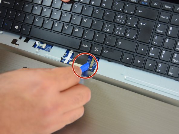

  5. why! W670SZQ1 Keyboard Replacement: crwdns2935265:05crwdnd2935265:01crwdnd2935265:03crwdne2935265:0 why! W670SZQ1 Keyboard Replacement: crwdns2935265:05crwdnd2935265:02crwdnd2935265:03crwdne2935265:0 why! W670SZQ1 Keyboard Replacement: crwdns2935265:05crwdnd2935265:03crwdnd2935265:03crwdne2935265:0

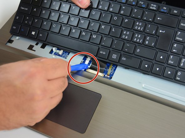

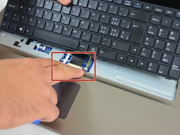

    • Now gently lift the keyboard.
    • Then appear the keyboard connection cable and the keyboard backlight cable
    • Start by unlocking the right latch of the connector securing the backlight cable.
  6. why! W670SZQ1 Keyboard Replacement: crwdns2935265:06crwdnd2935265:01crwdnd2935265:03crwdne2935265:0 why! W670SZQ1 Keyboard Replacement: crwdns2935265:06crwdnd2935265:02crwdnd2935265:03crwdne2935265:0 why! W670SZQ1 Keyboard Replacement: crwdns2935265:06crwdnd2935265:03crwdnd2935265:03crwdne2935265:0
    • Then the one on the left.
    • Do the same with the left latch of the connector securing the main cable.
    • Then with the right latch of the connector fixing the main cable.
  7. why! W670SZQ1 Keyboard Replacement: crwdns2935265:07crwdnd2935265:01crwdnd2935265:01crwdne2935265:0
    • Then remove the keyboard from its location.
