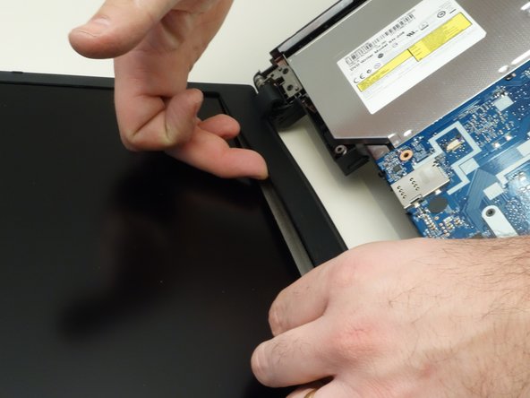

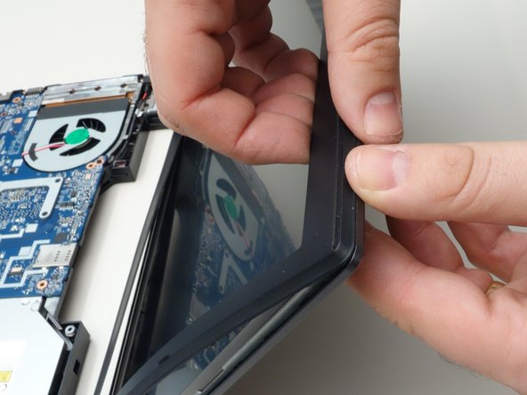

  2. why! W650SZ LCD Screen Replacement, Remove the Bezel: crwdns2935265:02crwdnd2935265:01crwdnd2935265:03crwdne2935265:0 why! W650SZ LCD Screen Replacement, Remove the Bezel: crwdns2935265:02crwdnd2935265:02crwdnd2935265:03crwdne2935265:0 why! W650SZ LCD Screen Replacement, Remove the Bezel: crwdns2935265:02crwdnd2935265:03crwdnd2935265:03crwdne2935265:0
    • Although the photos are shown without a keyboard, it is not necessary to remove the keyboard to replace the screen.

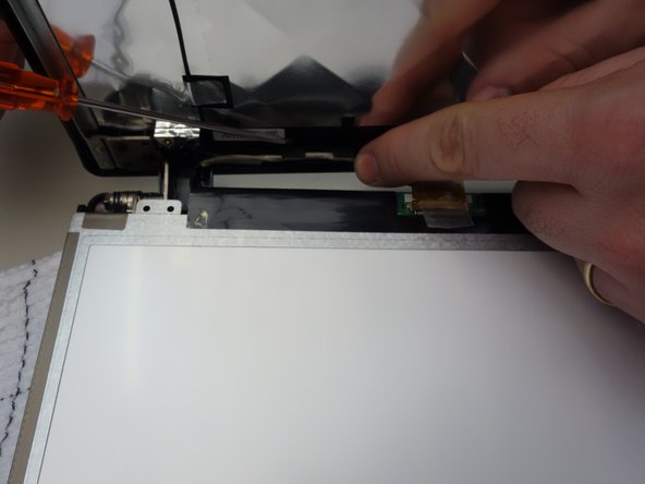

    • Gently insert your fingernail between the display bezel and the LCD.

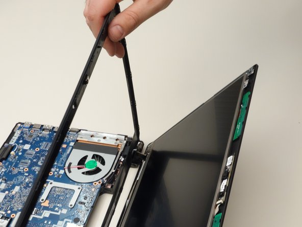

  3. why! W650SZ LCD Screen Replacement, Remove the Bezel (continued): crwdns2935265:03crwdnd2935265:01crwdnd2935265:03crwdne2935265:0 why! W650SZ LCD Screen Replacement, Remove the Bezel (continued): crwdns2935265:03crwdnd2935265:02crwdnd2935265:03crwdne2935265:0 why! W650SZ LCD Screen Replacement, Remove the Bezel (continued): crwdns2935265:03crwdnd2935265:03crwdnd2935265:03crwdne2935265:0
    • Working your way around the frame, unclip the mounting points of the frame surrounding the LCD screen.
  4. why! W650SZ LCD Screen Replacement, Remove the Bezel (continued): crwdns2935265:04crwdnd2935265:01crwdnd2935265:03crwdne2935265:0 why! W650SZ LCD Screen Replacement, Remove the Bezel (continued): crwdns2935265:04crwdnd2935265:02crwdnd2935265:03crwdne2935265:0 why! W650SZ LCD Screen Replacement, Remove the Bezel (continued): crwdns2935265:04crwdnd2935265:03crwdnd2935265:03crwdne2935265:0
    • Remove the bezel surrounding the LCD.

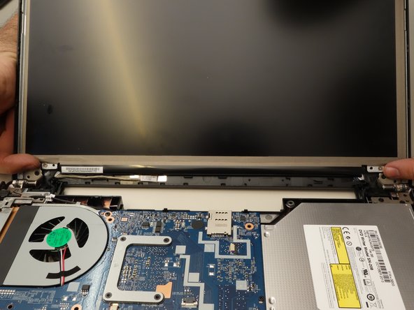

  5. why! W650SZ LCD Screen Replacement, Remove the Screws Securing the LCD: crwdns2935265:05crwdnd2935265:01crwdnd2935265:03crwdne2935265:0 why! W650SZ LCD Screen Replacement, Remove the Screws Securing the LCD: crwdns2935265:05crwdnd2935265:02crwdnd2935265:03crwdne2935265:0 why! W650SZ LCD Screen Replacement, Remove the Screws Securing the LCD: crwdns2935265:05crwdnd2935265:03crwdnd2935265:03crwdne2935265:0
    • Remove the two upper mounting screws securing the LCD to the lid.
    • Remove the two lower mounting screws.

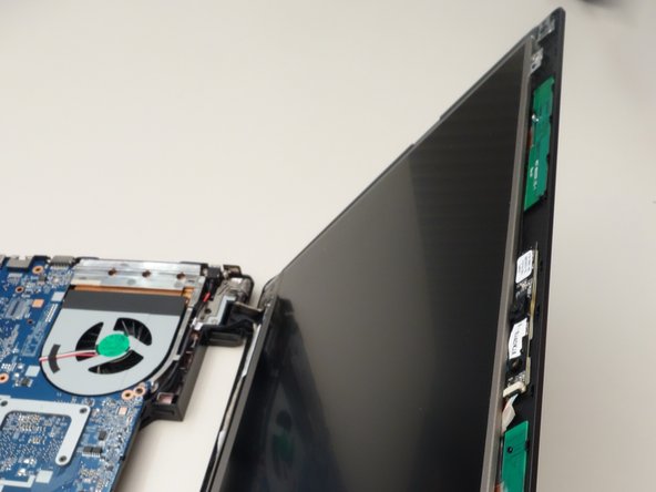

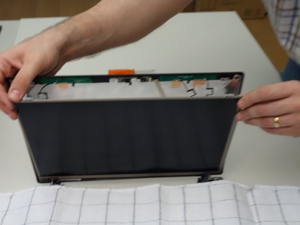

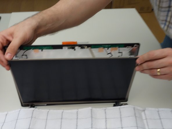

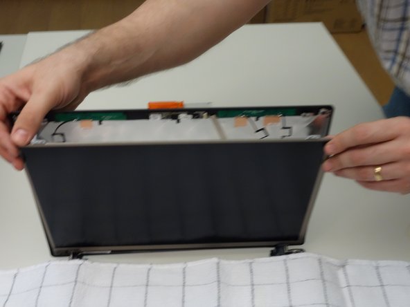

  6. why! W650SZ LCD Screen Replacement, Separate the LCD from the Display: crwdns2935265:06crwdnd2935265:01crwdnd2935265:03crwdne2935265:0 why! W650SZ LCD Screen Replacement, Separate the LCD from the Display: crwdns2935265:06crwdnd2935265:02crwdnd2935265:03crwdne2935265:0 why! W650SZ LCD Screen Replacement, Separate the LCD from the Display: crwdns2935265:06crwdnd2935265:03crwdnd2935265:03crwdne2935265:0

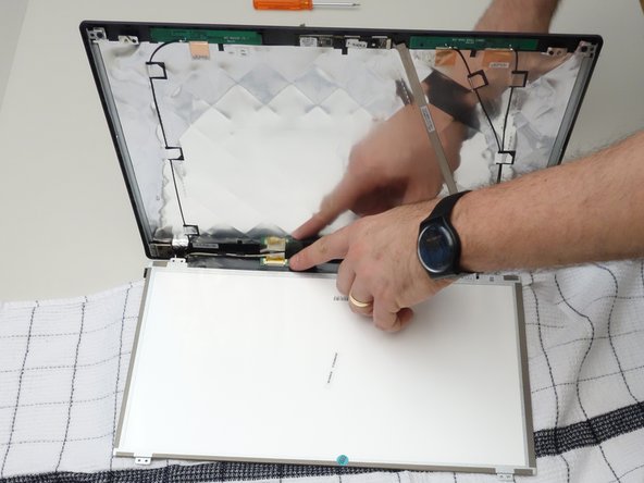

    • Cover the keyboard with a cloth, then carefully lower the LCD screen onto the keyboard.

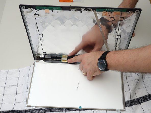

  7. why! W650SZ LCD Screen Replacement, Disconnect the LCD Cable: crwdns2935265:07crwdnd2935265:01crwdnd2935265:03crwdne2935265:0 why! W650SZ LCD Screen Replacement, Disconnect the LCD Cable: crwdns2935265:07crwdnd2935265:02crwdnd2935265:03crwdne2935265:0 why! W650SZ LCD Screen Replacement, Disconnect the LCD Cable: crwdns2935265:07crwdnd2935265:03crwdnd2935265:03crwdne2935265:0

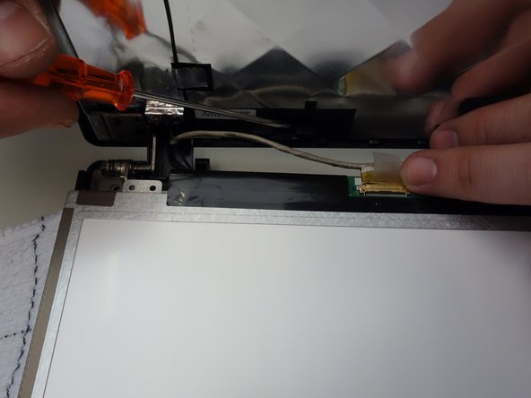

    • Note the location of the LCD screen connector.
  8. why! W650SZ LCD Screen Replacement, Remove the Connector Tape: crwdns2935265:08crwdnd2935265:01crwdnd2935265:03crwdne2935265:0 why! W650SZ LCD Screen Replacement, Remove the Connector Tape: crwdns2935265:08crwdnd2935265:02crwdnd2935265:03crwdne2935265:0 why! W650SZ LCD Screen Replacement, Remove the Connector Tape: crwdns2935265:08crwdnd2935265:03crwdnd2935265:03crwdne2935265:0
    • Using the plastic tab, peel back the tape securing the LCD cable the panel connector.

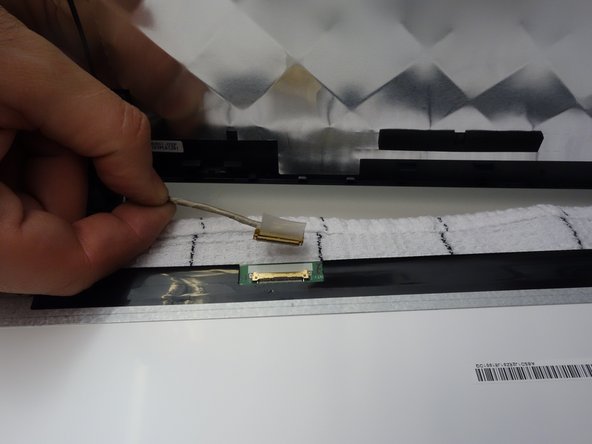

  9. why! W650SZ LCD Screen Replacement, Unplug the LCD and Remove the Screen: crwdns2935265:09crwdnd2935265:01crwdnd2935265:03crwdne2935265:0 why! W650SZ LCD Screen Replacement, Unplug the LCD and Remove the Screen: crwdns2935265:09crwdnd2935265:02crwdnd2935265:03crwdne2935265:0 why! W650SZ LCD Screen Replacement, Unplug the LCD and Remove the Screen: crwdns2935265:09crwdnd2935265:03crwdnd2935265:03crwdne2935265:0
    • Unplug the connector.

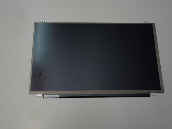

    • The LCD screen can now be removed.
