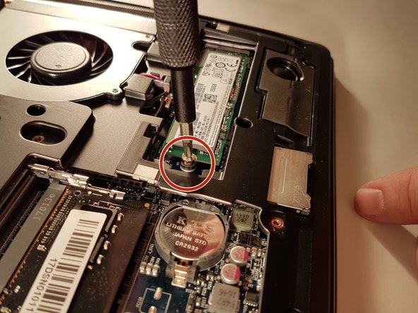

  4. why! N650DU Motherboard, SSD disk: crwdns2935265:04crwdnd2935265:01crwdnd2935265:02crwdne2935265:0 why! N650DU Motherboard, SSD disk: crwdns2935265:04crwdnd2935265:02crwdnd2935265:02crwdne2935265:0
    • Unscrew the screw circled in red
    • Remove the SSD

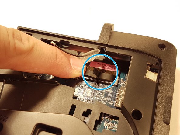

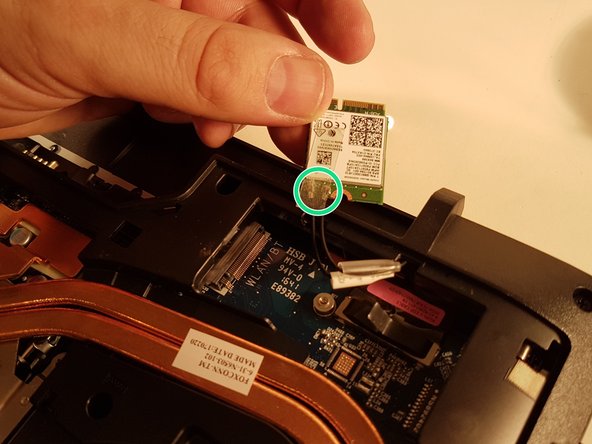

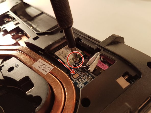

  7. why! N650DU Motherboard, Carte WLAN: crwdns2935265:07crwdnd2935265:01crwdnd2935265:03crwdne2935265:0 why! N650DU Motherboard, Carte WLAN: crwdns2935265:07crwdnd2935265:02crwdnd2935265:03crwdne2935265:0 why! N650DU Motherboard, Carte WLAN: crwdns2935265:07crwdnd2935265:03crwdnd2935265:03crwdne2935265:0
    • Disconnect the WLAN card in the direction of the red arrow
    • Unhook the two connectors circled in green on the WLAN card

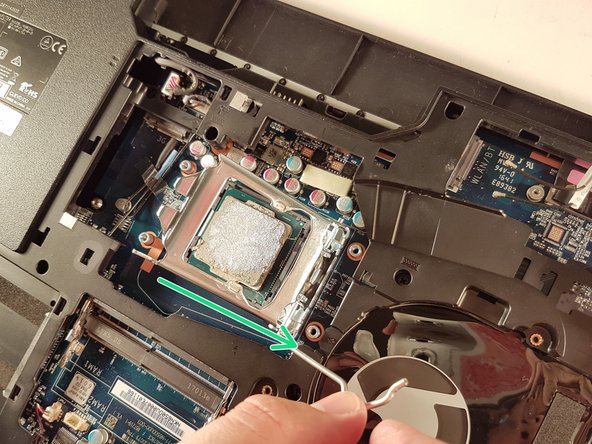

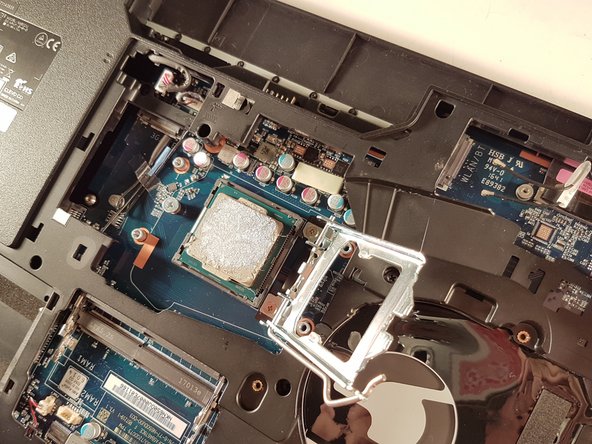

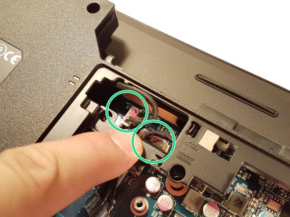

  8. why! N650DU Motherboard, Processor: crwdns2935265:08crwdnd2935265:01crwdnd2935265:03crwdne2935265:0 why! N650DU Motherboard, Processor: crwdns2935265:08crwdnd2935265:02crwdnd2935265:03crwdne2935265:0 why! N650DU Motherboard, Processor: crwdns2935265:08crwdnd2935265:03crwdnd2935265:03crwdne2935265:0
    • Unscrew the four screws circled in red
    • Lift the radiator with the black label
  9. why! N650DU Motherboard: crwdns2935265:09crwdnd2935265:01crwdnd2935265:03crwdne2935265:0 why! N650DU Motherboard: crwdns2935265:09crwdnd2935265:02crwdnd2935265:03crwdne2935265:0 why! N650DU Motherboard: crwdns2935265:09crwdnd2935265:03crwdnd2935265:03crwdne2935265:0
    • Push the lever in the direction of the red arrow while pushing it in
    • Lift the lever in the direction of the green arrow
    • Do not touch the bottom of the processor and take it by the sides

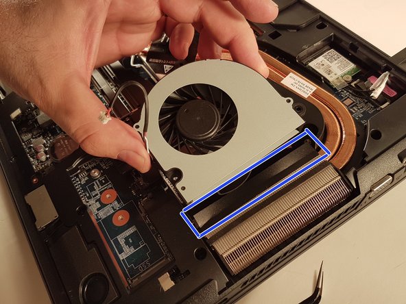

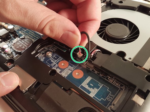

  10. why! N650DU Motherboard, The fan: crwdns2935265:010crwdnd2935265:01crwdnd2935265:03crwdne2935265:0 why! N650DU Motherboard, The fan: crwdns2935265:010crwdnd2935265:02crwdnd2935265:03crwdne2935265:0 why! N650DU Motherboard, The fan: crwdns2935265:010crwdnd2935265:03crwdnd2935265:03crwdne2935265:0
    • Unscrew the two screws circled in red
    • Disconnect the connector surrounded in green
    • Remove the fan by lifting the blue framed tab

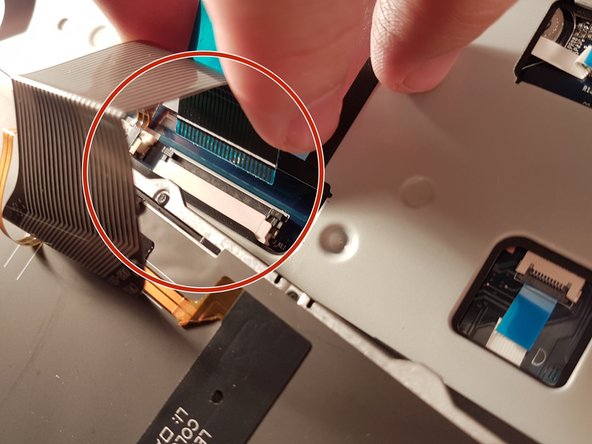

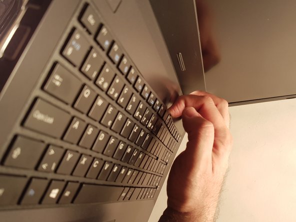

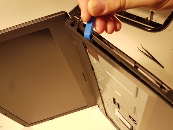

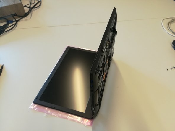

  12. why! N650DU Motherboard, The keyboard: crwdns2935265:012crwdnd2935265:01crwdnd2935265:03crwdne2935265:0 why! N650DU Motherboard, The keyboard: crwdns2935265:012crwdnd2935265:02crwdnd2935265:03crwdne2935265:0 why! N650DU Motherboard, The keyboard: crwdns2935265:012crwdnd2935265:03crwdnd2935265:03crwdne2935265:0
    • Unscrew the circled screws in red and green
    • Put the computer in the position of the second image while pushing a paper clip into the hole of the screw circled in green until you hear a click
    • Lift the keyboard

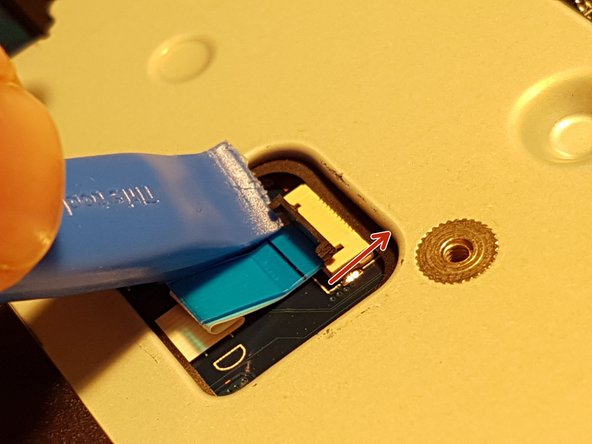

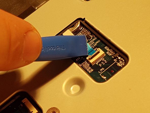

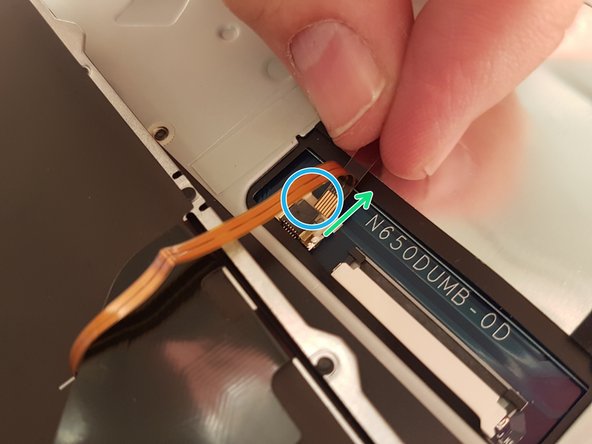

  13. why! N650DU Motherboard: crwdns2935265:013crwdnd2935265:01crwdnd2935265:03crwdne2935265:0 why! N650DU Motherboard: crwdns2935265:013crwdnd2935265:02crwdnd2935265:03crwdne2935265:0 why! N650DU Motherboard: crwdns2935265:013crwdnd2935265:03crwdnd2935265:03crwdne2935265:0
    • Remove the red circled connector
    • Pull the white drawer that holds the connector circled in blue in the direction of the green arrow
    • Remove the connector surrounded in blue

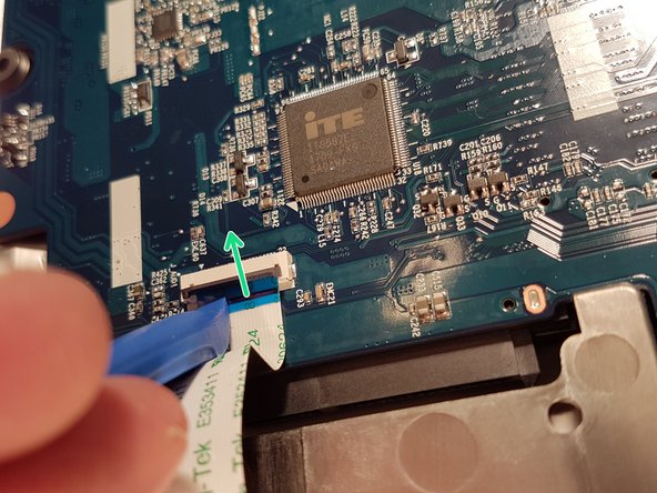

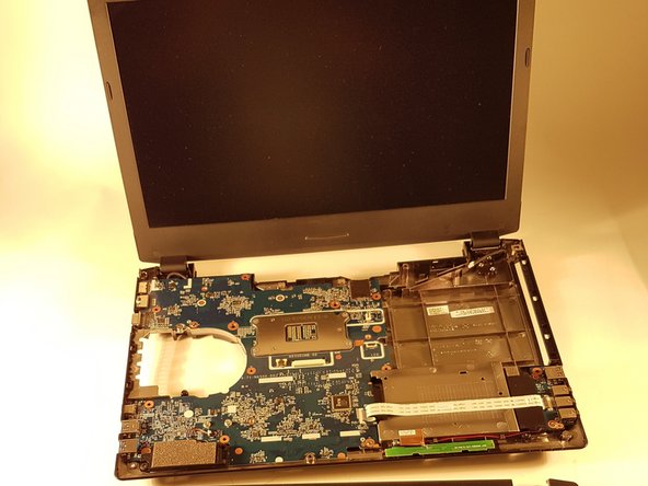

  14. why! N650DU Motherboard, Motherboard: crwdns2935265:014crwdnd2935265:01crwdnd2935265:03crwdne2935265:0 why! N650DU Motherboard, Motherboard: crwdns2935265:014crwdnd2935265:02crwdnd2935265:03crwdne2935265:0 why! N650DU Motherboard, Motherboard: crwdns2935265:014crwdnd2935265:03crwdnd2935265:03crwdne2935265:0
    • Lift the two black flaps
    • Remove the two connectors circled in red
  15. why! N650DU Motherboard: crwdns2935265:015crwdnd2935265:01crwdnd2935265:03crwdne2935265:0 why! N650DU Motherboard: crwdns2935265:015crwdnd2935265:02crwdnd2935265:03crwdne2935265:0 why! N650DU Motherboard: crwdns2935265:015crwdnd2935265:03crwdnd2935265:03crwdne2935265:0
    • Remove the thirteen screws circled in red
    • Remove the top cover

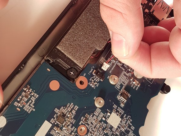

  17. why! N650DU Motherboard: crwdns2935265:017crwdnd2935265:01crwdnd2935265:03crwdne2935265:0 why! N650DU Motherboard: crwdns2935265:017crwdnd2935265:02crwdnd2935265:03crwdne2935265:0 why! N650DU Motherboard: crwdns2935265:017crwdnd2935265:03crwdnd2935265:03crwdne2935265:0
    • Disconnect the two connectors located in the green zone
    • Disconnect the connector surrounded in blue
    • Disconnect the red circled connector

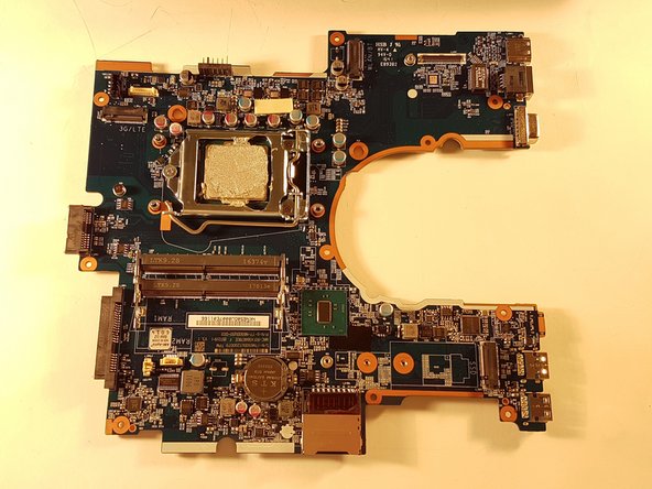

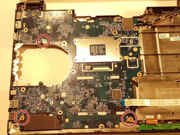

  18. why! N650DU Motherboard: crwdns2935265:018crwdnd2935265:01crwdnd2935265:03crwdne2935265:0 why! N650DU Motherboard: crwdns2935265:018crwdnd2935265:02crwdnd2935265:03crwdne2935265:0 why! N650DU Motherboard: crwdns2935265:018crwdnd2935265:03crwdnd2935265:03crwdne2935265:0
    • Remove the Micro SD port cover that is circled in green if there is one
    • Unscrew the three screws circled in red
    • Carefully remove the motherboard
To reassemble your device, follow the instructions in reverse order.
