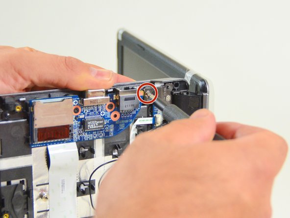

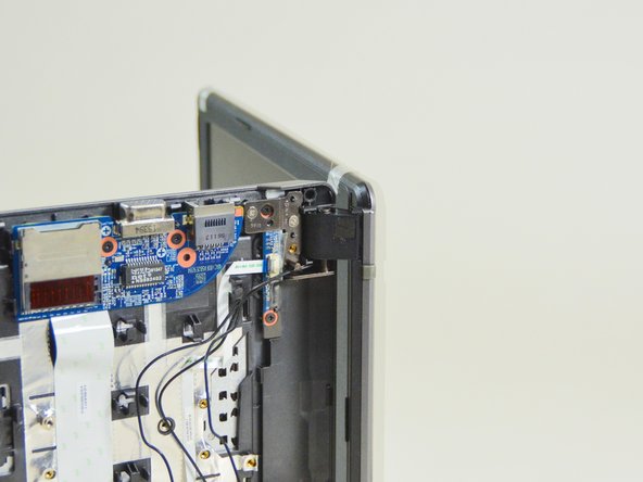

    • Now locate the two screws that secure the screen to the rest of the Laptop (fan side)
  7. why! N240BU Replacing the LCD screen: crwdns2935265:07crwdnd2935265:01crwdnd2935265:03crwdne2935265:0 why! N240BU Replacing the LCD screen: crwdns2935265:07crwdnd2935265:02crwdnd2935265:03crwdne2935265:0 why! N240BU Replacing the LCD screen: crwdns2935265:07crwdnd2935265:03crwdnd2935265:03crwdne2935265:0
    • Now locate the two screws that secure the screen to the rest of the Laptop (the other side).
    • Then lift the Laptop as shown in the second image of this step.
    • Unscrew the first screw.
  8. why! N240BU Replacing the LCD screen: crwdns2935265:08crwdnd2935265:01crwdnd2935265:03crwdne2935265:0 why! N240BU Replacing the LCD screen: crwdns2935265:08crwdnd2935265:02crwdnd2935265:03crwdne2935265:0 why! N240BU Replacing the LCD screen: crwdns2935265:08crwdnd2935265:03crwdnd2935265:03crwdne2935265:0
    • Then unscrew the second screw.
    • Rest the Laptop as shown in the second image of this step and unscrew the third screw.
    • Then the fourth screw.
  9. why! N240BU Replacing the LCD screen: crwdns2935265:09crwdnd2935265:01crwdnd2935265:03crwdne2935265:0 why! N240BU Replacing the LCD screen: crwdns2935265:09crwdnd2935265:02crwdnd2935265:03crwdne2935265:0 why! N240BU Replacing the LCD screen: crwdns2935265:09crwdnd2935265:03crwdnd2935265:03crwdne2935265:0

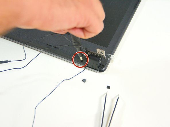

  10. why! N240BU Replacing the LCD screen: crwdns2935265:010crwdnd2935265:01crwdnd2935265:03crwdne2935265:0 why! N240BU Replacing the LCD screen: crwdns2935265:010crwdnd2935265:02crwdnd2935265:03crwdne2935265:0 why! N240BU Replacing the LCD screen: crwdns2935265:010crwdnd2935265:03crwdnd2935265:03crwdne2935265:0
    • Now remove the screw covers near the left hinge.
    • first on the right side of the hinge.
    • then on the left side.
  11. why! N240BU Replacing the LCD screen: crwdns2935265:011crwdnd2935265:01crwdnd2935265:03crwdne2935265:0 why! N240BU Replacing the LCD screen: crwdns2935265:011crwdnd2935265:02crwdnd2935265:03crwdne2935265:0 why! N240BU Replacing the LCD screen: crwdns2935265:011crwdnd2935265:03crwdnd2935265:03crwdne2935265:0
    • Repeat near the right hinge
    • .Now return to the hinge on the left side and unscrew the outer screw.
  12. why! N240BU Replacing the LCD screen: crwdns2935265:012crwdnd2935265:01crwdnd2935265:03crwdne2935265:0 why! N240BU Replacing the LCD screen: crwdns2935265:012crwdnd2935265:02crwdnd2935265:03crwdne2935265:0 why! N240BU Replacing the LCD screen: crwdns2935265:012crwdnd2935265:03crwdnd2935265:03crwdne2935265:0
    • Then unscrew the inner screw.
    • Repeat on the side of the right hinge.

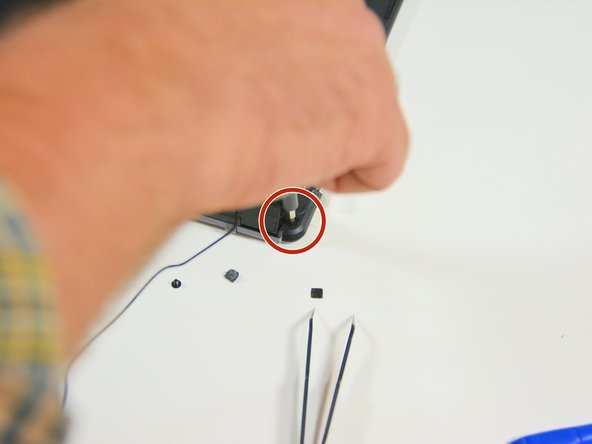

  14. why! N240BU Replacing the LCD screen: crwdns2935265:014crwdnd2935265:01crwdnd2935265:03crwdne2935265:0 why! N240BU Replacing the LCD screen: crwdns2935265:014crwdnd2935265:02crwdnd2935265:03crwdne2935265:0 why! N240BU Replacing the LCD screen: crwdns2935265:014crwdnd2935265:03crwdnd2935265:03crwdne2935265:0
    • Gently remove the screw cover on the left hinge.
    • Also remove the screw cover on the right hinge.
    • Once the screw caps are removed you will see the fixing screws.
  15. why! N240BU Replacing the LCD screen: crwdns2935265:015crwdnd2935265:01crwdnd2935265:03crwdne2935265:0 why! N240BU Replacing the LCD screen: crwdns2935265:015crwdnd2935265:02crwdnd2935265:03crwdne2935265:0 why! N240BU Replacing the LCD screen: crwdns2935265:015crwdnd2935265:03crwdnd2935265:03crwdne2935265:0
    • Now unscrew the screw on the left hinge.
    • Then unscrew the screw on the right hinge.
    • Once this is done you can now remove the hinge cover (left).

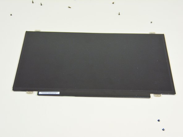

    • once these operations are done you see the LCD screen ready to be dismounted.
    • Now locate the screws that secure the LCD screen to the bracket and unscrew them. Two on the left.
    • Two on the right.
  18. why! N240BU Replacing the LCD screen: crwdns2935265:018crwdnd2935265:01crwdnd2935265:03crwdne2935265:0 why! N240BU Replacing the LCD screen: crwdns2935265:018crwdnd2935265:02crwdnd2935265:03crwdne2935265:0 why! N240BU Replacing the LCD screen: crwdns2935265:018crwdnd2935265:03crwdnd2935265:03crwdne2935265:0
    • Once the screws are unscrewed, lift the LCD screen gently and flip it over.
    • You will then see the connection cable of the screen.
    • Locate its connector.
  19. why! N240BU Replacing the LCD screen: crwdns2935265:019crwdnd2935265:01crwdnd2935265:02crwdne2935265:0 why! N240BU Replacing the LCD screen: crwdns2935265:019crwdnd2935265:02crwdnd2935265:02crwdne2935265:0
    • Disconnect the cable.
    • And here you can now put it on your work plan.
