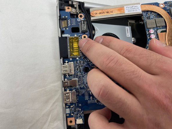

  12. why! N131WU/BU/ZU Upper Case Replacement, Display Connector: crwdns2935265:012crwdnd2935265:01crwdnd2935265:02crwdne2935265:0 why! N131WU/BU/ZU Upper Case Replacement, Display Connector: crwdns2935265:012crwdnd2935265:02crwdnd2935265:02crwdne2935265:0
    • Note: The original instructions call for inserting your thumbnail firmly under the base of the display connector
    • However, the proper way to remove the display connector is to grasp the plastic strap on top of the connector and use it to pull the connector straight up.

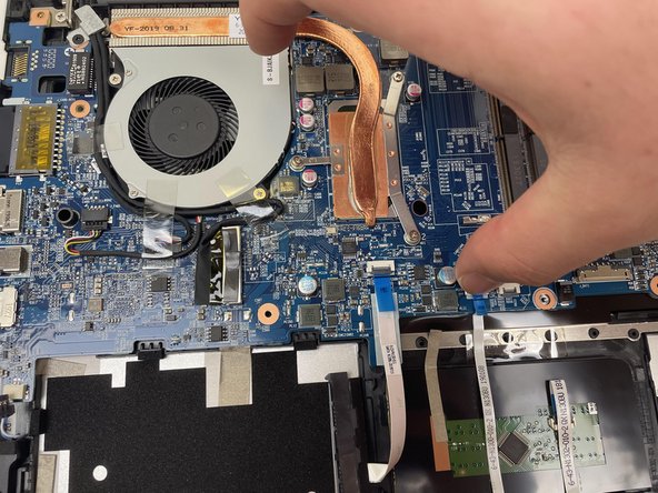

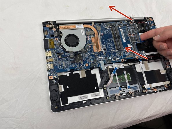

  13. why! N131WU/BU/ZU Upper Case Replacement, Remove the Motherboard: crwdns2935265:013crwdnd2935265:01crwdnd2935265:03crwdne2935265:0 why! N131WU/BU/ZU Upper Case Replacement, Remove the Motherboard: crwdns2935265:013crwdnd2935265:02crwdnd2935265:03crwdne2935265:0 why! N131WU/BU/ZU Upper Case Replacement, Remove the Motherboard: crwdns2935265:013crwdnd2935265:03crwdnd2935265:03crwdne2935265:0
    • Once the screws have been removed, carefully lift the motherboard from the end indicated by the arrows.
    • Remember to disconnect the cables near the fan.
  14. why! N131WU/BU/ZU Upper Case Replacement, Motherboard (continued): crwdns2935265:014crwdnd2935265:01crwdnd2935265:01crwdne2935265:0
    • The motherboard has been successfully removed.

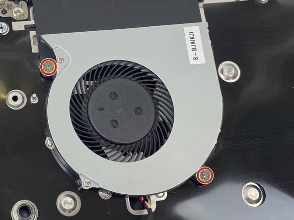

  16. why! N131WU/BU/ZU Upper Case Replacement, Speaker/Fan/Headset connector: crwdns2935265:016crwdnd2935265:01crwdnd2935265:03crwdne2935265:0 why! N131WU/BU/ZU Upper Case Replacement, Speaker/Fan/Headset connector: crwdns2935265:016crwdnd2935265:02crwdnd2935265:03crwdne2935265:0 why! N131WU/BU/ZU Upper Case Replacement, Speaker/Fan/Headset connector: crwdns2935265:016crwdnd2935265:03crwdnd2935265:03crwdne2935265:0
    • Remove the left speaker.
    • Remove the two Phillips screws securing the CPU fan to the case and remove the fan.
    • Remove the two screws securing the audio connector board.

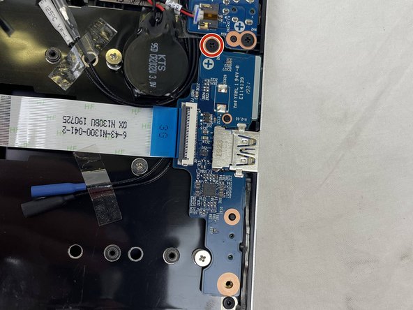

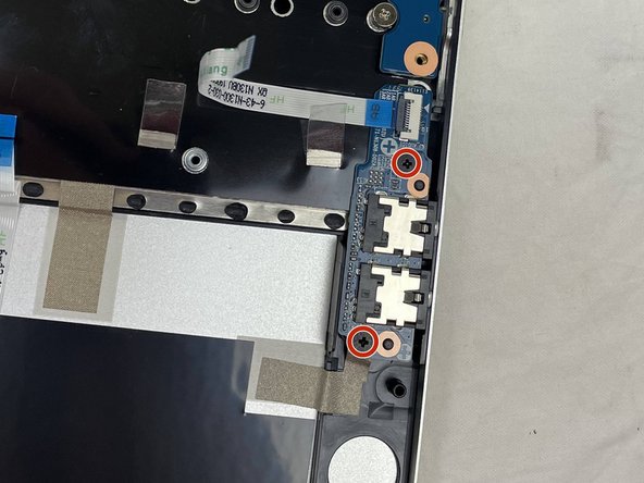

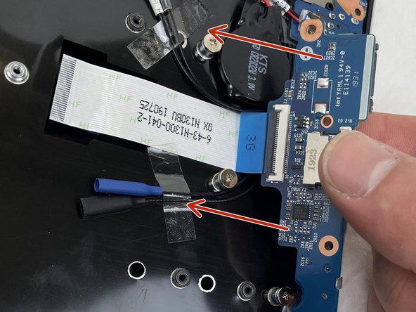

  17. why! N131WU/BU/ZU Upper Case Replacement, Headset and USB Boards: crwdns2935265:017crwdnd2935265:01crwdnd2935265:03crwdne2935265:0 why! N131WU/BU/ZU Upper Case Replacement, Headset and USB Boards: crwdns2935265:017crwdnd2935265:02crwdnd2935265:03crwdne2935265:0 why! N131WU/BU/ZU Upper Case Replacement, Headset and USB Boards: crwdns2935265:017crwdnd2935265:03crwdnd2935265:03crwdne2935265:0
    • Lift the audio board at the point indicated by the red arrow and slide it away from the chassis in the direction of the orange arrow.
    • Remove the Phillips screw securing the power connector board.
    • Lift out the USB connector board in the direction indicated by the arrows.
    • The ribbon cable is secured to the upper case with adhesive. It is not necessary to disconnect it from the USB board; just carefully peel the entire assembly from the case in the direction of the arrows.

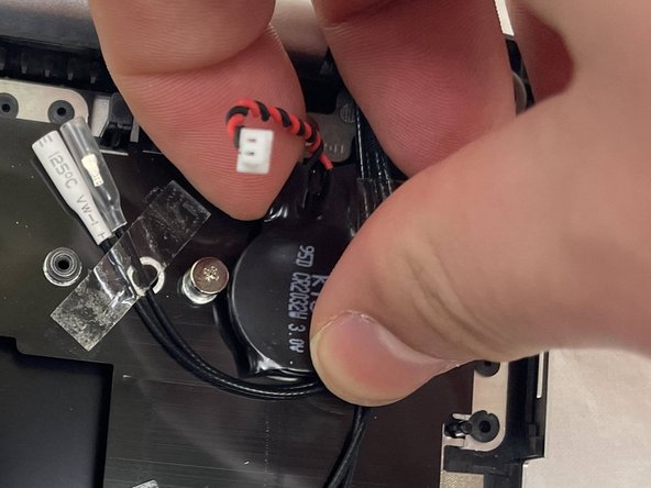

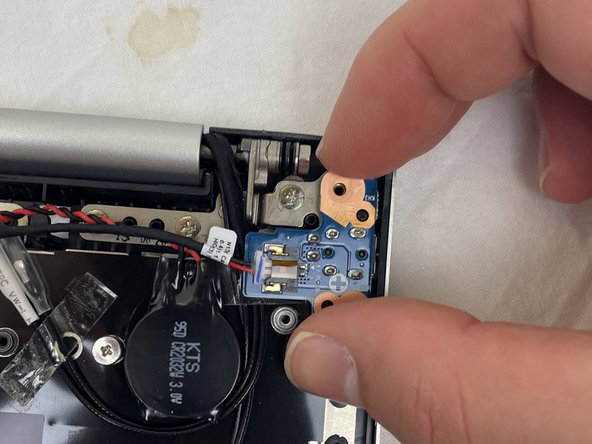

  18. why! N131WU/BU/ZU Upper Case Replacement, DC Board and CMOS Battery: crwdns2935265:018crwdnd2935265:01crwdnd2935265:03crwdne2935265:0 why! N131WU/BU/ZU Upper Case Replacement, DC Board and CMOS Battery: crwdns2935265:018crwdnd2935265:02crwdnd2935265:03crwdne2935265:0 why! N131WU/BU/ZU Upper Case Replacement, DC Board and CMOS Battery: crwdns2935265:018crwdnd2935265:03crwdnd2935265:03crwdne2935265:0
    • Unplug the DC input board, remove the single Phillips screw securing it and remove it.
    • The DC power wires can remain in place.
    • The CMOS battery is secured to the case with adhesive. Simply peel it off to remove it.

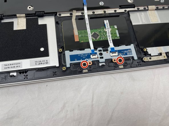

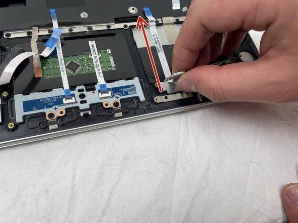

  19. why! N131WU/BU/ZU Upper Case Replacement, LED Board / Touchpad Button Plate: crwdns2935265:019crwdnd2935265:01crwdnd2935265:03crwdne2935265:0 why! N131WU/BU/ZU Upper Case Replacement, LED Board / Touchpad Button Plate: crwdns2935265:019crwdnd2935265:02crwdnd2935265:03crwdne2935265:0 why! N131WU/BU/ZU Upper Case Replacement, LED Board / Touchpad Button Plate: crwdns2935265:019crwdnd2935265:03crwdnd2935265:03crwdne2935265:0
    • Remove the two screws holding the LED board on the chassis and remove it along with the ribbon cable.
    • No force is necessary; it is lightly adhered to the board and can easily be peeled off.
    • Remove the two screws securing the touchpad button plate.

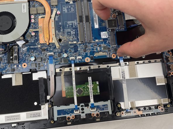

  20. why! N131WU/BU/ZU Upper Case Replacement, Touchpad Button Board: crwdns2935265:020crwdnd2935265:01crwdnd2935265:03crwdne2935265:0 why! N131WU/BU/ZU Upper Case Replacement, Touchpad Button Board: crwdns2935265:020crwdnd2935265:02crwdnd2935265:03crwdne2935265:0 why! N131WU/BU/ZU Upper Case Replacement, Touchpad Button Board: crwdns2935265:020crwdnd2935265:03crwdnd2935265:03crwdne2935265:0
    • Lift the ZIF connector retaining tab and unplug the button cable on the right.
    • Grasp the LED board between the two cables.
    • Following the direction of the red arrow, peel the two cables from the case.
