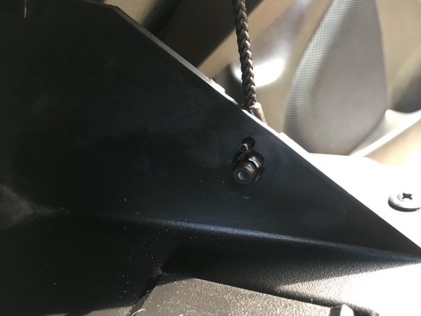

Right Glove Compartment Door Support Cable
  • To remove the right-side cable, you must push the center pin out of the clip first.
  • Now, the clip can be removed from the door. Just push it through the hole.
  • The door should now be fully disconnected from the car.
