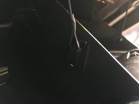

Left Glove Compartment Door Support Cable
  • The left side supporting wire is pretty easy to remove.
  • Pushing the clip down will allow you to slide it out of the door, releasing the cable.
  • This cable is spring loaded, and will retract upwards into the dash.
