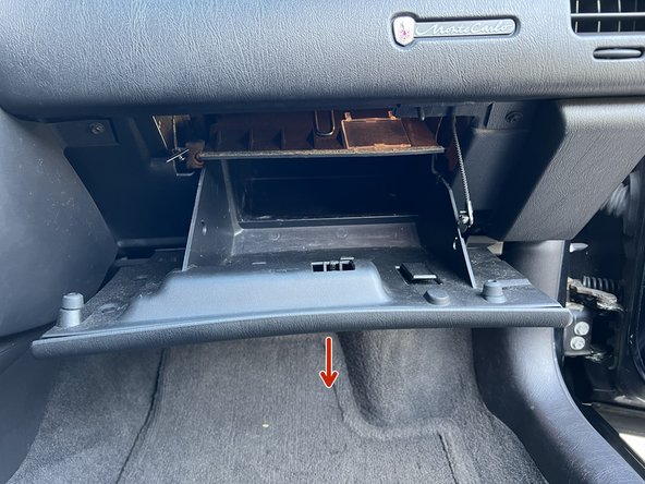

Door Removal
  • With everything disconnected, the door is still captive in the dash. There's a small plastic tab on the left side of the door that must be bent to release it.
  • A swift yank downwards on the door should be enough to release it.
  • These images were taken with the hinge screws still attached, normally the door would come completely loose.
