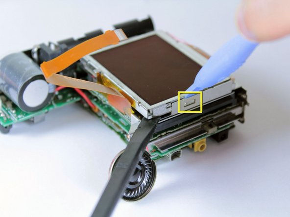

  • Wedge the plastic opening tool between the edge of the screen and the metal bracket, on the opposite side of the battery compartment.
  • Use the spudger to pry up the corner of the screen adjacent to the metal bracket.
  • The best place to wedge the tool is directly above the rectangular space in the bracket.
  • The screen should come out easily. If it doesn't, jiggle it a little bit. If jiggling doesn't work, use the plastic opening tool to create a larger gap between the screen and the bracket.
