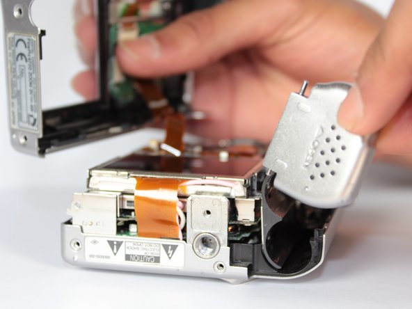

  4. Fujifilm FinePix 4700 Zoom Display Screen Replacement: crwdns2935265:04crwdnd2935265:01crwdnd2935265:02crwdne2935265:0 Fujifilm FinePix 4700 Zoom Display Screen Replacement: crwdns2935265:04crwdnd2935265:02crwdnd2935265:02crwdne2935265:0
    • Watch out for the orange ribbon that is still attached to the back cover when you lift it up. It is very delicate and might rip.
    • Slowly lift the back cover straight up, lightly jiggling it if necessary.
    • Remove the battery compartment cover.
  5. Fujifilm FinePix 4700 Zoom Display Screen Replacement: crwdns2935265:05crwdnd2935265:01crwdnd2935265:01crwdne2935265:0
    • Gently insert the spudger under the clip holding the orange ribbon. The clip should lift up and the ribbon will slide out.
    • This step will free the back cover from the rest of the camera.

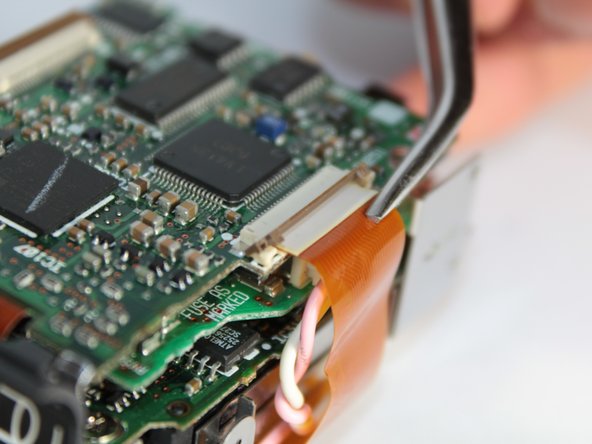

  12. Fujifilm FinePix 4700 Zoom Display Screen Replacement, Display Screen: crwdns2935265:012crwdnd2935265:01crwdnd2935265:03crwdne2935265:0 Fujifilm FinePix 4700 Zoom Display Screen Replacement, Display Screen: crwdns2935265:012crwdnd2935265:02crwdnd2935265:03crwdne2935265:0 Fujifilm FinePix 4700 Zoom Display Screen Replacement, Display Screen: crwdns2935265:012crwdnd2935265:03crwdnd2935265:03crwdne2935265:0
    • Be gentle when undoing the ribbon clip. It breaks easily.
    • Locate the orange ribbon that goes from the screen to the bottom side of the motherboard.
    • Stick the spudger under the ribbon clip connecting and lift it up. Use the tweezers to pull out the ribbon.
    • Use the pointed end of the spudger to unplug the connector for the pink and white screen wires by pulling it straight out.

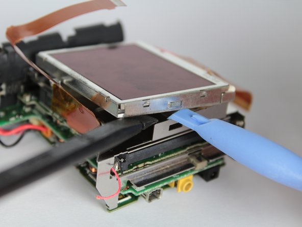

  13. Fujifilm FinePix 4700 Zoom Display Screen Replacement: crwdns2935265:013crwdnd2935265:01crwdnd2935265:03crwdne2935265:0 Fujifilm FinePix 4700 Zoom Display Screen Replacement: crwdns2935265:013crwdnd2935265:02crwdnd2935265:03crwdne2935265:0 Fujifilm FinePix 4700 Zoom Display Screen Replacement: crwdns2935265:013crwdnd2935265:03crwdnd2935265:03crwdne2935265:0

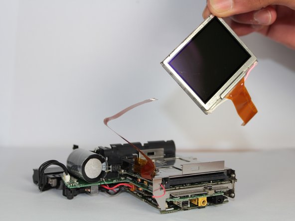

    • Wedge the plastic opening tool between the edge of the screen and the metal bracket, on the opposite side of the battery compartment.
    • Use the spudger to pry up the corner of the screen adjacent to the metal bracket.
    • The best place to wedge the tool is directly above the rectangular space in the bracket.
    • The screen should come out easily. If it doesn't, jiggle it a little bit. If jiggling doesn't work, use the plastic opening tool to create a larger gap between the screen and the bracket.
