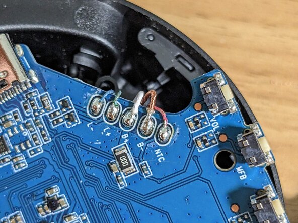

JBL Tune 510BT Ear cup holder replacement, Unsolder the power and data cable: crwdns2935265:00crwdnd2935265:01crwdnd2935265:03crwdne2935265:0 JBL Tune 510BT Ear cup holder replacement, Unsolder the power and data cable: crwdns2935265:00crwdnd2935265:02crwdnd2935265:03crwdne2935265:0 JBL Tune 510BT Ear cup holder replacement, Unsolder the power and data cable: crwdns2935265:00crwdnd2935265:03crwdnd2935265:03crwdne2935265:0
  • Now that the board is movable (you can pray it a bit using the spatula tool in the I fix it kit), warm up your soldering iron as you will have to de-solder all 5 power and data cables.
  • Be careful not to detach the microphone that is held in place with glue when moving the board.
  • Once done, you should be able to lift the board entirely (careful with the microphone).
