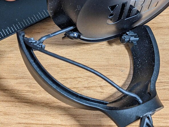

Detach the earpiece
  • Careful pry the earpiece out of the ear cup holder. The holder flex just enough for it to get out of its sockets.
  • Note: if the piece does not want to come out, I recommend pushing it with the spatula, just to get it to start getting out. It has a small lip that get stuck easily. You should not need to use much force.
  • Pull slowly the cable from the earpiece entirely.
