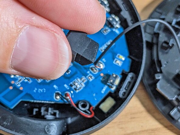

Remove the led cover and unscrew the board
  • Remove the small plastic that cover the leds for the power and put it aside.
  • Then remove the screw that hold the board to the bottom of the earpiece.
