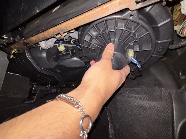

  • Pull the blower motor out of its housing, with care not to strain the connected wire bundle.
  • You may need to rotate the motor clockwise to remove it.
