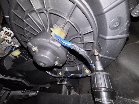

  • Use a T20 Torx screwdriver to remove the three 20 mm screws securing the blower motor.
  • A 4 mm flat head screwdriver can also be used.
