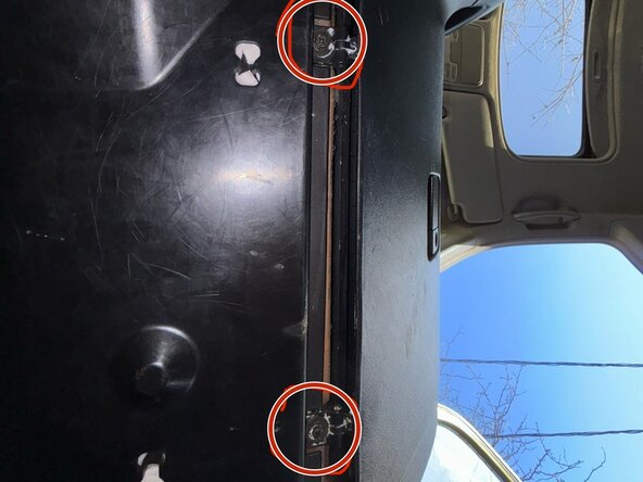

    • Remove the two 20 mm Phillips #3 screws under the glove box on the passenger side of the vehicle.
    • An 8 mm socket wrench can also be used to remove these bolts

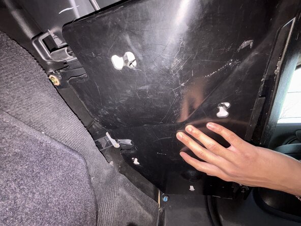

  2. 2002-2006 Honda CR-V Blower Motor Replacement: crwdns2935265:02crwdnd2935265:01crwdnd2935265:02crwdne2935265:0 2002-2006 Honda CR-V Blower Motor Replacement: crwdns2935265:02crwdnd2935265:02crwdnd2935265:02crwdne2935265:0
    • Push the panel up and back to remove it.
    • The panel will fall out, revealing the blower motor underneath.
