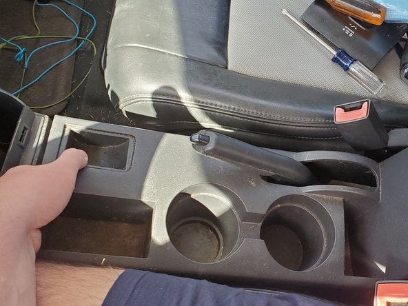

Opening the Console for Removal
  • Pull up on your emergency brake as high as you can get it.
  • Remove the middle and rear section of the console to remove the front section.
  • Grab the sides of the console and start to wiggle it until you hear the sections unsnap from each other.
