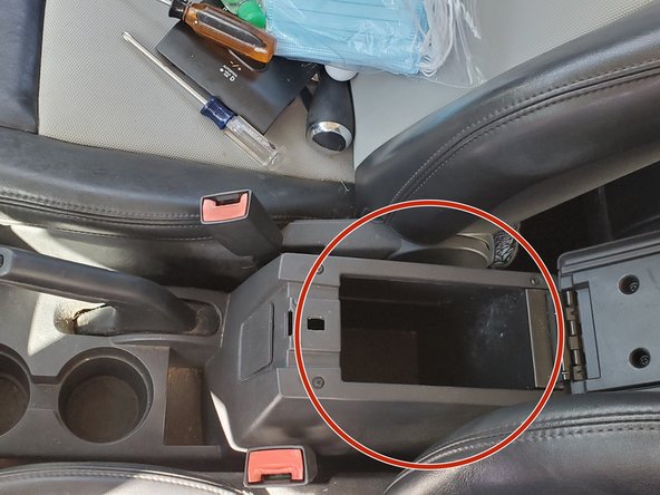

Remove the Screws From the Storage Compartment
  • Unscrew the two 19mm screws within the storage compartment using the Phillips #1 screwdriver.
