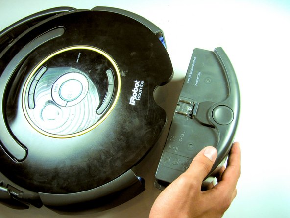

  5. iRobot Roomba 650 Bumper Sensor IR Transmitter Replacement: crwdns2935265:05crwdnd2935265:01crwdnd2935265:02crwdne2935265:0 iRobot Roomba 650 Bumper Sensor IR Transmitter Replacement: crwdns2935265:05crwdnd2935265:02crwdnd2935265:02crwdne2935265:0
    • Pull out the bin while pressing down on the release button. Set aside.

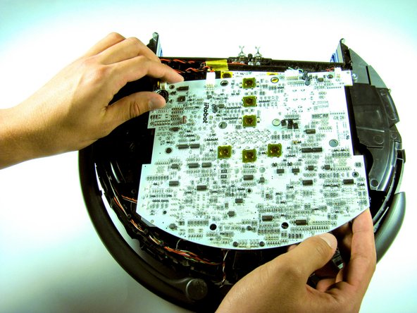

  10. iRobot Roomba 650 Bumper Sensor IR Transmitter Replacement: crwdns2935265:010crwdnd2935265:01crwdnd2935265:02crwdne2935265:0 iRobot Roomba 650 Bumper Sensor IR Transmitter Replacement: crwdns2935265:010crwdnd2935265:02crwdnd2935265:02crwdne2935265:0
    • Use the Phillip's Head #1 Screwdriver to remove the five 5.5 mm motherboard screws.
    • Gently lift the motherboard up off the Roomba about half an inch.

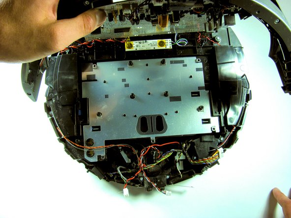

  11. iRobot Roomba 650 Bumper Sensor IR Transmitter Replacement: crwdns2935265:011crwdnd2935265:01crwdnd2935265:01crwdne2935265:0
    • Remove the round cliff sensor belt by pulling it up off of the front edge of the Roomba.
  12. iRobot Roomba 650 Bumper Sensor IR Transmitter Replacement: crwdns2935265:012crwdnd2935265:01crwdnd2935265:02crwdne2935265:0 iRobot Roomba 650 Bumper Sensor IR Transmitter Replacement: crwdns2935265:012crwdnd2935265:02crwdnd2935265:02crwdne2935265:0
    • Disconnect the three cables that attach the motherboard to the front of the Roomba.
    • Lift up the motherboard, cliff sensor belt, and front bumper up and out of the way.

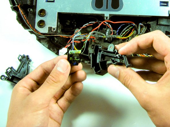

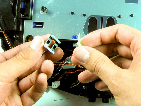

    • Remove the rubber cover on the bumper sensor.
  14. iRobot Roomba 650 Bumper Sensor IR Transmitter Replacement: crwdns2935265:014crwdnd2935265:01crwdnd2935265:03crwdne2935265:0 iRobot Roomba 650 Bumper Sensor IR Transmitter Replacement: crwdns2935265:014crwdnd2935265:02crwdnd2935265:03crwdne2935265:0 iRobot Roomba 650 Bumper Sensor IR Transmitter Replacement: crwdns2935265:014crwdnd2935265:03crwdnd2935265:03crwdne2935265:0
    • Use the Phillip's #1 screwdriver to remove the two 7.5 mm screws from the bumper sensor module.
    • Pry the module clips open with a spudger or your finger.
    • Open the sensor module.

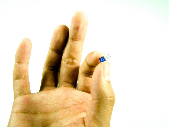

  15. iRobot Roomba 650 Bumper Sensor IR Transmitter Replacement: crwdns2935265:015crwdnd2935265:01crwdnd2935265:03crwdne2935265:0 iRobot Roomba 650 Bumper Sensor IR Transmitter Replacement: crwdns2935265:015crwdnd2935265:02crwdnd2935265:03crwdne2935265:0 iRobot Roomba 650 Bumper Sensor IR Transmitter Replacement: crwdns2935265:015crwdnd2935265:03crwdnd2935265:03crwdne2935265:0
    • Once the bumper sensor module is open, remove the small IR chip.
    • Pull off the black protector surrounding the chip.
  16. iRobot Roomba 650 Bumper Sensor IR Transmitter Replacement: crwdns2935265:016crwdnd2935265:01crwdnd2935265:02crwdne2935265:0 iRobot Roomba 650 Bumper Sensor IR Transmitter Replacement: crwdns2935265:016crwdnd2935265:02crwdnd2935265:02crwdne2935265:0
    • For this next step, it might be helpful to have another set of hands.
    • Use a soldering iron to desolder pins on the blue IR receiver. Try repeatedly warming each pin up and giving a tug on the receiver. It should eventually slide out.
    • You will need to then solder in a new receiver in the exact same place you took the old one out.
