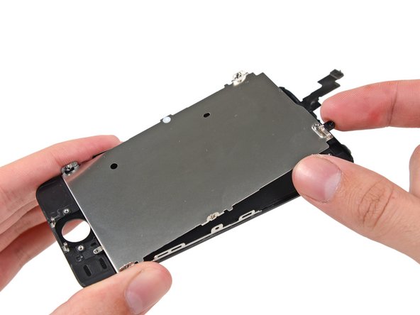

    Removed board. I ended up with a small shiny metal plate. Shown clearly in the above last posted photos just under the power button switch. Where does this goes?
    Malcolm - crwdns2934203:0crwdne2934203:0
    I was wondering the same thing. Did you ever figure out where this goes?
    paul -
    This has probably been replied to, but see step 31 :) Should be re installed with the pokey out bits pointing down.

    @malcom @paul if you are referring to step 31 the plate needs to be placed as it comes out on the picture. Long flat part towards the top of the casing with the tab facing the right.

  9. iPhone SE LCD and Digitizer Replacement, Removing the Touch ID cable bracket: crwdns2935265:09crwdnd2935265:01crwdnd2935265:03crwdne2935265:0 iPhone SE LCD and Digitizer Replacement, Removing the Touch ID cable bracket: crwdns2935265:09crwdnd2935265:02crwdnd2935265:03crwdne2935265:0 iPhone SE LCD and Digitizer Replacement, Removing the Touch ID cable bracket: crwdns2935265:09crwdnd2935265:03crwdnd2935265:03crwdne2935265:0
    • Open the phone just enough to reveal the metal bracket covering the home button cable.
    • Do not open the phone too far or you risk damaging the home button cable, or the socket it plugs into. Keep the cable loose—if it is stretched out, that's too far.
    • Only the phone's original home button assembly will be capable of using the Touch ID functionality. If you rip the cable, installing a new home button will only restore ordinary home button functions, not the Touch ID features.
    • Use the tip of a spudger to push the bracket free and remove it with tweezers.
    • The next two steps apply to reassembly. Skip them and continue to Step 12 until reassembly.

    Reinstallation: Getting the Touch ID cable and metal shield both clipped back into place was a real PITA. The best advice I can give is to take it slowly and with lashings of patience. The first effort was no good. The shield and plug weren't properly home. The second effort was better - everything works now. Hurrah!
    Thole whole job took 2h 45m. It's my first iPhone battery replacement.
    Next job is my iPhone 7....
    Tony Houlihan - crwdns2934203:0crwdne2934203:0
  11. iPhone SE LCD and Digitizer Replacement: crwdns2935265:011crwdnd2935265:01crwdnd2935265:02crwdne2935265:0 iPhone SE LCD and Digitizer Replacement: crwdns2935265:011crwdnd2935265:02crwdnd2935265:02crwdne2935265:0
    • During reassembly, use the flat end of a spudger to snap the front portion of the Touch ID cable bracket down over the cable connector.
    • If the bracket does not snap down flush, you may need to remove the bracket and slide it over the cable connector again for a better fit.

    STEPS 9-12 need a re-working - Re-assembly instructions should be put just under the disassembly instructions so that when you scroll back up the page, you’re re-assembling in step order ;)
    Ashley Lahm - crwdns2934203:0crwdne2934203:0
    The little clip is an utter “#*+}{ to refit. I gave up and put a drop of hot glue on or you could use blue tack. Makes no difference. Phone works fine.
    blackettfenwicks - crwdns2934203:0crwdne2934203:0
    I gave up assembling this little bracket and left it out. phone’s been working fine for past 10 minutes. I wonder if this will be a problem later though.
    rkain.kim - crwdns2934203:0crwdne2934203:0
    As has been well noted, reassembly of this clip is not self-evident. The clip itself is not a symmetrical piece; rather, it has a small tab on one side. What is its purpose and what is the correct alignment of the tab as it’s placed over the connector? Moreover, the available iFixit tools are not adequate to align and place into correct position, especially considering the restricted space (and light) to work in. After studying the problem, I decided to use a piece of rope caulk (used for weatherstripping) with its sticky texture to hold the clip in correct alignment before pressing it into final position.
    Peter Hartwick - crwdns2934203:0crwdne2934203:0
    As put so eloquently by many wise ones before me, that bracket is a %^#* to get back in. My approach was to put the needlenose tweezer tips through the two holes in the top, and push gently in the direction of the top of the phone as I applied downward pressure. With luck, I had it lined up JUST right on my 947th try, and it snapped right into place. Yikes.
    Max Discher - crwdns2934203:0crwdne2934203:0
    Got a message saying Touch ID couldn’t be activated. Reseated and back to normal.
    Instead of just lifting the screen to reassemble the clip you can turn the screen sideways so that it’s no longer covered.
    Stephen Shaw - crwdns2934203:0crwdne2934203:0
    The clip is not symmetrical! The side with one snap goes towards the speakers. CAREFULLY use the tweezers to gently set the clip down with the correct orientation. Then use the spudger to press it into place. (Sometimes one side, then the other side.)
    Take your time.
    Annette - crwdns2934203:0crwdne2934203:0
    Reassembly: It’s very often that you get the cable to snap to the connector on the board, but find that the device doesn't work properly. In most cases, re-seating the cable fixes the problem. S
    Sometimes, it's a bent pin on the connector, and then you have a problem… While I have been able to fix desktop CPU socket pins, I have never tried to fix a busted surfaces mount connector like these. I don't know if that's possible.

  18. iPhone SE LCD and Digitizer Replacement: crwdns2935265:018crwdnd2935265:01crwdnd2935265:01crwdne2935265:0
    • Remove the front panel assembly cable bracket from the logic board.
    At my iPhone 5s this part is missing!
    Michael Schöttner - crwdns2934203:0crwdne2934203:0
    Vor dem wiedereinsetzten des Bleches ist es ratsam den Monitor und den Touchsreen zu testen. Ich habe bis hier alles wiederholen müssen wegen Balken im oberen Bereich des Monitors und hackelnder Touchfunktion.
    mit_dt - crwdns2934203:0crwdne2934203:0

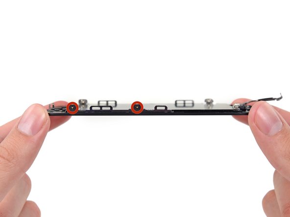

  24. iPhone SE LCD and Digitizer Replacement: crwdns2935265:024crwdnd2935265:01crwdnd2935265:03crwdne2935265:0 iPhone SE LCD and Digitizer Replacement: crwdns2935265:024crwdnd2935265:02crwdnd2935265:03crwdne2935265:0 iPhone SE LCD and Digitizer Replacement: crwdns2935265:024crwdnd2935265:03crwdnd2935265:03crwdne2935265:0
    • Orient the phone as shown, with the home button on top and the earpiece speaker on bottom.
    • Gently dislodge the clip, near the bottom left corner of the earpiece speaker bracket, outwards from its recess on the front panel assembly.
    • Do not pry with excessive force, as the earpiece speaker bracket is fragile and malleable.
    • With a set of tweezers, shift the bracket to the left to unclip it.
    I have found that the shield over the speaker needs to be reassembled precisely if transferring to a new screen. There is very little clearance for the vibrating motor to whip around and if the shield is even a smidge shifted towards it, it will block it and not vibrate. Just something to check when done.
    Matt Endress - crwdns2934203:0crwdne2934203:0
    Wow, thanks for this comment, this saved my hide. I suspected that I was a bit offset after reattaching the shield and sure enough it was slightly hitting the vibrator. It took a while but I was able to get the shield all the way to the left by hooking the little metal clip on the left side of the shield under some plastic that its supposed to go under. (Recall that when you take off the shield you have to slide it out a bit to the right.) This shield and all the stuff under it is very difficult to get right when closing up the phone.

  28. iPhone SE LCD and Digitizer Replacement, Front Facing Camera and Sensor Cable Assembly: crwdns2935265:028crwdnd2935265:01crwdnd2935265:01crwdne2935265:0
    iOpener
    $24.99
    • This step requires removing the front facing camera and sensor cable from your front panel assembly.
    • The front facing camera and sensor cable is adhered to the display assembly with mild adhesive.
    • Using an iOpener to soften the adhesive will help safely remove it. Follow our iOpener instructions to use it.
    If you just want to get underneath the LCD plate, e.g. to clean water/drinks that got in there, skip to step 34. There's no need to peel off those connectors or use the iOpener heat. Here's a photo: http://imgur.com/AKlFWed
    Dan Dascalescu - crwdns2934203:0crwdne2934203:0
    In my case, my front facing camera was just foggy, and I suspected dust had got in there (was correct in the end). In this step I had to remove the shield (which you can see still attached in Step 16), which is over the camera itself. It was then possible to gently lift the camera out of it's socket and clean.
    Robert Colvin - crwdns2934203:0crwdne2934203:0
    Robert -You were able to lift the camera just by itself? I would think the cable doesn't have any extra slack to allow the camera to move without detaching the cable on one end.
    Paul Astrachan -
    I had a foggy front camera too due to lots of dust ingress into the front camera housing. This was clearly visible in the front camera lens above the earpiece aperture - it was white instead of the pinpoint of blue lens. The best way to lift without the tricky lifting of the entire camera assembly is to peel back the large black sticky pad attached to the back of the metal display shield. Then you can roll the camera lens and proximity sensor out of the way and carbon fibre brush or air blast the dust out.
    Simon -
    Quick tip: if you can't afford/wait for/don't want the iOpener, filling a small portion of an ankle cut cotton sock with rice (to about the size of a golf ball), tying it closed, and putting it in the microwave for about 25-30 seconds can work just as well!
    ndauphin583 - crwdns2934203:0crwdne2934203:0
    I used a cherry stone pillow to heat up the display. I though it could be nearly the same as the iOpener one. It worked out very well
    Denis Kiesel - crwdns2934203:0crwdne2934203:0
    Do not skip this step. The proximity sensor is very easy to peel off the flexible circuit board if the adhesive isn't loosened.
    Cedric - crwdns2934203:0crwdne2934203:0
    I always use UNDU adhesive remover instead of heat. Works great for all adhesively mounted parts. I have used on numerous iphones and an iPad. If the glue stays stuck to the right part, then it is reusable still sticky when the UNDU dries out. When used on Home/TouchID button, it made the rubber membrane soft and misshapen, but it returned to normal shape when it dried out.
    3M thin VHB tape 5908 can be used to replace any needed little sticky bits.
    B Louis - crwdns2934203:0crwdne2934203:0
    If you don’t have a heating pad, a hair dryer or heatgun on a low setting also works well for heating up this area.
    markfiorentino - crwdns2934203:0crwdne2934203:0
    Here an important tip no one thought to include: Opposed to other connectors, this one happens to be Paper Thin!
    Yes! Do consider that, prior to prying the entire lens out of the housing!

  32. iPhone SE LCD and Digitizer Replacement: crwdns2935265:032crwdnd2935265:01crwdnd2935265:03crwdne2935265:0 iPhone SE LCD and Digitizer Replacement: crwdns2935265:032crwdnd2935265:02crwdnd2935265:03crwdne2935265:0 iPhone SE LCD and Digitizer Replacement: crwdns2935265:032crwdnd2935265:03crwdnd2935265:03crwdne2935265:0
    • If you are reattaching the same shield plate to a new display, there is no need to peel the cable assembly off the LCD shield plate. Skip this step.
    • Carefully peel the cable assembly off of the LCD shield plate to remove it from the display.
    • Be careful not to grab the digitizer cable while peeling up the front facing camera and sensor assembly cable.
    I would skip Step 24. Why would you remove the very delicate cable assembly from the LCD shield plate only to reattach it to the same shield plate after fastening the shield plate to your new display assembly...
    kevindfrye - crwdns2934203:0crwdne2934203:0
    Indeed. I just did one today and realized it would have been fine to leave it. Better even.
    Paul Jerome -
    Only minor thing: It's step 25 you should skip. I replaced my wife's last night and skipped it. Skipping Step 25 was definitely a wise thing to do, since you're simply putting it right back on the same piece once you put the phone back together.
    pbpope -
    Does anyone know what the copper sticker is for? I accidentally ripped mine apart trying to get it off, it tore easier than paper, being that I didn't even notice I did it until I noticed it was ripped. I also thought to myself, why the heck did I remove this thing when I didn't need to. I've been trying to google it. it might be "iPhone 5S Rear Camera Cooling Copper Adhesive Sticker" but there is no reference as to how big that is. Anyway, I assembled it as normal and the phone works perfectly fine. So any help would be appreciated.
    aaron - crwdns2934203:0crwdne2934203:0
    I got the same problem with the copper sticker,it has been tore! Is anybody can explain what does it for and where can i get it?!! Because the phone not working properly. Any help would be appreciated.
    Mark - crwdns2934203:0crwdne2934203:0
    Didn`t tear it , but there is no use in removing it since reusing LCD protector later, !@#$%^ me off. :-)
    eriwolde - crwdns2934203:0crwdne2934203:0
    Why remove the copper sticker? Why not leave it attached since your are going to reuse LCD protector. Remove the home button before the camera and light sensor and save the LCD protector for last with everything attached to it.
    Marshall - crwdns2934203:0crwdne2934203:0
    I thirdly will ask for what the copper sticker is for!? I thought some kind of grounding?? I tore mine and the front facing camera is fuzzy now. It looks grainy. Almost like it isn't grounded good. ANY advice here would be appreciated.
    Thanks
    Kent - crwdns2934203:0crwdne2934203:0
    Agreed. Skip step 25. I can't fathom why it's in these otherwise excellent instructions.
    leanit - crwdns2934203:0crwdne2934203:0
    Agreed - you don't need to do this step
    kevinhay - crwdns2934203:0crwdne2934203:0
    Also skipped this step.
    jonl - crwdns2934203:0crwdne2934203:0
    I tore mine also...wish I would have come here and read these helpful tips first.
    Michael Huber - crwdns2934203:0crwdne2934203:0
    The copper sticker is some kind of ground connection, and is therefore probably very important given the frequencies present inside the phone, and that the phone is itself a radio transmitter and receiver. I too followed the instructions and removed it but I was super careful and didn't tear it, and was able to reattach it. I used the spudger to smooth it and ensure that it makes good contact with the shield. It didn't even occur to me to skip the removal step! But I agree with that advice.
    Mark Cousins - crwdns2934203:0crwdne2934203:0
    Replacement Front Camera and Sensor Cable didn't have such sticker. Where this sticker should be reattached?
    fedor -
    step 32:while removing that piece on the LCD shield plate , I sheared that cable which is connected to the shield plate, so I skiped it and completed fixing, after that I found out that my iphone is not working .. I don't understand the problem from this cable or from the new screen ..
    please help ..

  35. iPhone SE LCD and Digitizer Replacement: crwdns2935265:035crwdnd2935265:01crwdnd2935265:01crwdne2935265:0
    • Remove the two 1.4 mm Phillips #000 screws from the home button bracket.
    Screws are stuck...! no way that I can unscrew them :-(
    Sumit Bhatnagar - crwdns2934203:0crwdne2934203:0
    I had this issue, screws were so tight my screwdriver was starting to strip them. I managed to get one side off by applying massive pressure. I then wiggled the plate around to loosen the other side.
    mrnoxious -
    Had this problem. Used something like this to get them out: Screw Extracting Pliers
    Calion -
    Hi every body! I would know much pressure the iphone 5s 's lcd can resist approximately !!? Have you ever stand on it?this happend for me , and in some positions under the direct sun light when the screen is ON , it seems that there is some pits on lcd ! ;-( please help ! If you had the same case! Help Thank You***
    Bryan - crwdns2934203:0crwdne2934203:0
    I could not get a phillips #000 to release these, but a phillips #00 did the trick perfectly. South African version of the phone, if that makes a difference.

  42. iPhone SE LCD and Digitizer Replacement: crwdns2935265:042crwdnd2935265:01crwdnd2935265:02crwdne2935265:0 iPhone SE LCD and Digitizer Replacement: crwdns2935265:042crwdnd2935265:02crwdnd2935265:02crwdne2935265:0
    • Remove two 1.2 mm Phillips screws from each side of the LCD frame (four total).
    • To avoid stripping the final screw, it may be helpful to first slightly loosen all four screws before removing any.
    screws are too tight, they won’t come out
    Cameron Bell - crwdns2934203:0crwdne2934203:0
  43. iPhone SE LCD and Digitizer Replacement: crwdns2935265:043crwdnd2935265:01crwdnd2935265:02crwdne2935265:0 iPhone SE LCD and Digitizer Replacement: crwdns2935265:043crwdnd2935265:02crwdnd2935265:02crwdne2935265:0
    • Remove the LCD shield plate from the display assembly.
    • The LCD and digitizer remains.
    Tip: If you're replacing with an aftermarket screen and it doesn't fit very well, sligtly trim the top and bottom edges of the plastic screen bezel (the edge facing inwards into the phone so that its not visible after assembly). You can also trim .25mm or so off the top slot protrusions that lead the screen into the housing. Lastly, if the screen assy is bulging or loose near the volume buttons, apply some thin double-sided tape to the screen assy metal brackets (the ones that slot into the housing). This will create a very tight fit, but allow removal if neccessary.
    Paul - crwdns2934203:0crwdne2934203:0

    how do you get the LCD off from the screen and put it on the new screen because I can that it shows you removing the LCD metal plate but not removing the LCD that’s under the LCD plate?? can anyone give me any ideas coz every time I look it up on the net it only shows me ppl replacing the whole screen im not after that.. on a iPhone 5
    Richard - crwdns2934203:0crwdne2934203:0
    I think you mean “how to get the LCD of the glass” you cannot remove it form the glass easilly as it is glued, you’ll just have to replace the entire front diplay assambly.
    Andrés Salan -
    Hi Richard,
    Andres is correct. The LCD is laminated onto the front glass, making non-repair shop repairs very difficult. You can check this video out to see what it would need, or search for “iPhone 5 glass only repair”.
