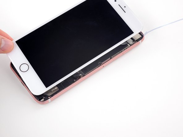

    • Begin by removing all the old display adhesive around the perimeter of your iPhone's case.
    • You can pull the adhesive off with tweezers, or roll it up on the tip of a spudger with a roll-and-pull motion.
    When you do not really want to get rid of the glue, but you do not have it, you can tie the glue off and pick it up with tweezers! You can remove it.

  5. iPhone Display Adhesive Replacement: crwdns2935265:05crwdnd2935265:01crwdnd2935265:02crwdne2935265:0 iPhone Display Adhesive Replacement: crwdns2935265:05crwdnd2935265:02crwdnd2935265:02crwdne2935265:0
    • Begin peeling the large backing from your replacement adhesive, starting from the bottom edge.
    • You'll usually find a large tab of some kind on the bottom edge.

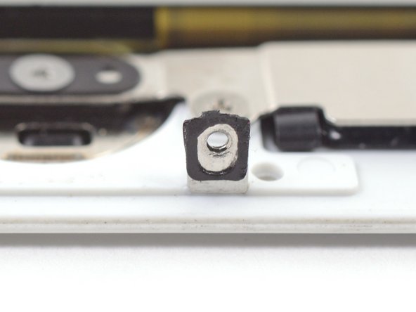

  6. iPhone Display Adhesive Replacement: crwdns2935265:06crwdnd2935265:01crwdnd2935265:03crwdne2935265:0 iPhone Display Adhesive Replacement: crwdns2935265:06crwdnd2935265:02crwdnd2935265:03crwdne2935265:0 iPhone Display Adhesive Replacement: crwdns2935265:06crwdnd2935265:03crwdnd2935265:03crwdne2935265:0
    • Before applying the adhesive, make sure your iPhone's battery connector lays flat so it doesn't press against the blue release liner. It's okay to temporarily reconnect the battery if needed—just be sure to disconnect it again before installing the display.
    • Carefully align the exposed lower edge of the adhesive strip with the bottom edge of your iPhone's case.
    • Once the adhesive is pressed into place, you can't reposition it—you'll have to remove it and start over with new adhesive.
    • When it's correctly aligned, gently press the exposed lower adhesive strip into place.
    The three pictures show him peeling the adhesive backing away as he lays the adhisive in the phone. I found it easier to peel the whole backing away and then very carefully align the whole adhesive before gently pressing any of it in place. This way, you can be sure it will line up perfectly and avoid having to redo it.

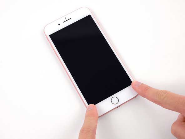

  11. iPhone Display Adhesive Replacement: crwdns2935265:011crwdnd2935265:01crwdnd2935265:03crwdne2935265:0 iPhone Display Adhesive Replacement: crwdns2935265:011crwdnd2935265:02crwdnd2935265:03crwdne2935265:0 iPhone Display Adhesive Replacement: crwdns2935265:011crwdnd2935265:03crwdnd2935265:03crwdne2935265:0
    • Grab the small pull tab (located at one of the corners) and peel off the large front liner from the adhesive.
    • On some versions, this liner may consist of up to four smaller pieces rather than a large single piece.
    Make sure you pull the tab as close to the phone as possible, parallel to the phone. This should lower the probability of the adhesive in the corner separating from the frame. Do NOT pull up and away from the frame!
    If it does separate, just put it back and press it firmly in with the spudger and try again.

    • iPhone 7 / 7 Plus only: Before installing your display, check the condition of the black gaskets on the two small screw bosses on the bottom edge of your display, near the home button.
    • If the gaskets are misaligned, use tweezers to carefully recenter them.
    • iPhone 6s and 6s Plus models don't have these gaskets.
    The gaskets on my iPhone 7 are actually sleeves that slide onto the screw bosses, covering both sides. Be sure both gaskets are fully in place, not only pressed on one side of the boss. This is not shown in the pictures here.
    zachcramer - crwdns2934203:0crwdne2934203:0
    My iPhone 7+ didn’t have gaskets or sleeves, bought directly from Apple, SIM free/unlocked. I’m the 1st to open it.
    jeffrey griffith - crwdns2934203:0crwdne2934203:0
    same case for my iPhone 7+ Model A1784 , it didn’t have gaskets or sleeves, bought directly from Apple, SIM free/unlocked. I’m the 1st to open it also.
    Xavier LESTEVEN -
    No bottom hole gaskets or sleeves for my 7+, either. 1st time opened. The adhesive did not stick to the case frame, even after multiple passes with the spudger. I had to carefully push and tack the unstuck adhesive onto the case rails (thin side channels) with the tweezers.
    Eyan Lee - crwdns2934203:0crwdne2934203:0
    Mon iphone 7 + pas de joints ou les manchons de vis aussi.
    Serge 26 mars 2023

    • Carefully align the top edge of the display with the top edge of the phone body.
    • Position the display so that the tabs along the top edge fit into place just underneath the top edge of the iPhone's case.
    Make sure to not push the screen upwards too hard, mine ended up sticking up a bit at the top.
    Richard Kraus - crwdns2934203:0crwdne2934203:0

    • As you lower the display into place, apply gentle pressure against the display's bottom edge so that the top edge stays flush with the top edge of the iPhone.
    • This also prevents the two small gaskets near the home button from scraping against the iPhone's lower edge.
    • Press on the sides of the display near the top of the iPhone, and work your way down to click the display into place.
    My new LCD screen part didn’t come with gaskets! And I forgot about the ones on the old cracked screen until too late.
    Therese Peffer - crwdns2934203:0crwdne2934203:0
    Does anyone know where to buy replacement gaskets?
    Redding - crwdns2934203:0crwdne2934203:0
    Oddly enough, my iPhone 7+ never had these foam gaskets from the factory.
    I bought it new online, SIM free/unlocked from Apple and I’m the 1st to open it up.

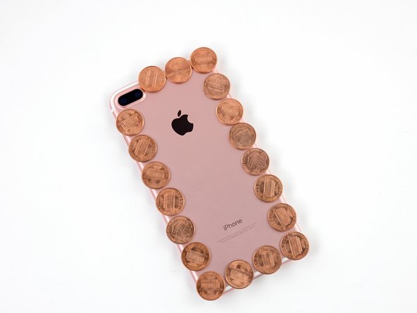

    • In order for the adhesive to bond correctly, you'll need to apply even pressure around the perimeter of your iPhone. The camera bump complicates matters, but you can compensate by laying your iPhone face-down and placing coins around the perimeter.
    • Alternatively, you can use screen vise clamps around the perimeter of your device to set the new adhesive.
    • You can use coins of any denomination, so long as they are as thick or slightly thicker than the camera bump.
    • If your iPhone has a high-gloss finish, such as Jet Black, add a strip of tape around the perimeter to protect the finish before placing any coins.
    • Place a coin at each corner of your iPhone, and place two coins on either side of the camera bump.
    • Place additional coins around the entire perimeter of your iPhone.
    • Using a hair dryer or heat gun, evenly heat the side edges all the way around the iPhone until they are slightly too hot to touch. The heat will help the adhesive form a more complete bond. Don't overheat the iPhone, or you may cause the battery to ignite or damage other heat-sensitive components, like the display.
    What happens if I skip this step of heating the phone and just placing some heavy books on my iPhone 6s? I have this question because I don’t own neither a heat gun nor a hair dryer. Pls help
    Sreeram ASRK - crwdns2934203:0crwdne2934203:0
    Your phone will work fine. This step is more about getting the adhesive to bond securely to help create a waterproof seal. If you don’t have any way to heat it, using more weight and leaving it there for a longer period of time may help.
    Jeff Suovanen -
    You can set you iphone screen UP in the sun for a while to heat it up pretty well before the pressure/weight step
    John - crwdns2934203:0crwdne2934203:0
    With the potential of electronics, I would like to have seen an quantitative temperate referenced as well as the qualitative (subjective).
    Thomas Tritt - crwdns2934203:0crwdne2934203:0
    Also, an actual spacer would helped - coins kept sliding off as I was heating them.
    I just put a soft cover book on the bottom and stacked other books on it. Worked just fine for me :)
    Richard Kraus -
    Pennies are light enough that my hair dryer just blew them off. I just heated the phone and then put the coins and books on as quickly as I could. Still worked just as well.
    Maxwell Osborn - crwdns2934203:0crwdne2934203:0
    I just used the box the iPhone came in which has a perfect cradle for the phone. Glad I saved it!
    Martin Salem - crwdns2934203:0crwdne2934203:0
    Thank you so much for the advice on this and the suggestion of heating coins and using books. I did as suggested and three weeks later my phone was knocked into a bath of water. It had a mophie case around it which helped bit I immediately fished out the phone, turned it off and dried it. Tapped out water in ports, removed the SIM card and then placed in front of a fan to dry put for 24 hours. I wanted to wait longer but I needed my phone for a long trip so prayed and turned it on. It was fine. Nothing wrong with it abs I can only thank you foe your suggestions to improve the seal that made the difference.
    David Gordon - crwdns2934203:0crwdne2934203:0
    Instead of using a heat gun/hair dryer (I do not have one) — I used the coins trick, and put a kettle on top that I filled with hot water. I used water at around 80ºC. The weight of the kettle also provides additional pressure, making sure you get a good seal. To cool it down, simply add some additional cold water to the kettle.
    steinmb - crwdns2934203:0crwdne2934203:0
    Cut a piece of styrofoam to roughly the shape of your phone. Place it on the phone, and press down over the camera bump to mark its location. Then shave out a bit from this spot so the styrofoam will sit more or less flat on the phone. You can now heat the phone and then quickly toss the styrofoam and weights on top. SO much easier than juggling all those coins.
    Vin T - crwdns2934203:0crwdne2934203:0

    • Remove the books and use your fingers to press firmly on all four corners of the display.
    • Press for about 3 seconds and then release.
    • Remember to install your iPhone's two pentalobe screws.

If you heat too much with a pad or dryer
-or-
add books or other stuff on top that are too heavy,
you could leave a permanent discoloration spot at the bottom right of your new screen, as on mine.
