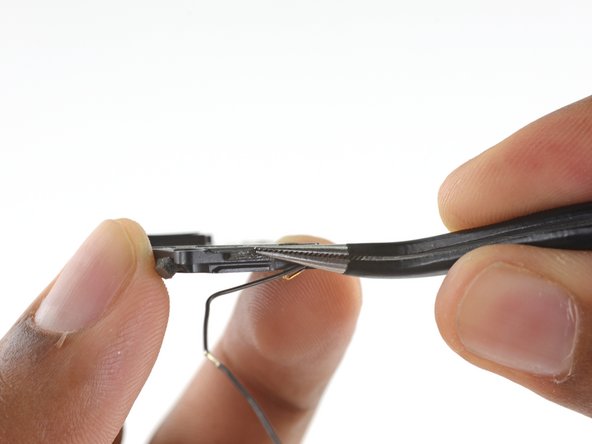

  35. iPhone 6s Wi-Fi Diversity Antenna Replacement: crwdns2935265:035crwdnd2935265:01crwdnd2935265:03crwdne2935265:0 iPhone 6s Wi-Fi Diversity Antenna Replacement: crwdns2935265:035crwdnd2935265:02crwdnd2935265:03crwdne2935265:0 iPhone 6s Wi-Fi Diversity Antenna Replacement: crwdns2935265:035crwdnd2935265:03crwdnd2935265:03crwdne2935265:0
    • Prepare an iOpener and lay it over the antenna to soften the adhesive securing it to the speaker.
    • Use a plastic opening pick to break up the adhesive securing the antenna to the speaker.
  36. iPhone 6s Wi-Fi Diversity Antenna Replacement: crwdns2935265:036crwdnd2935265:01crwdnd2935265:01crwdne2935265:0
    • Remove the antenna from the speaker.
Compare your new replacement part to the original part. You may need to transfer remaining components or remove adhesive backings from the new part before installing.
