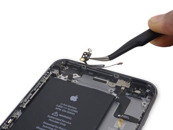

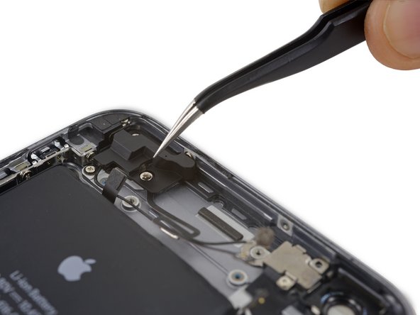

    • Deroute the antenna cable from the two clips on the right edge of the logic board.
  44. iPhone 6s Plus Wi-Fi/Bluetooth Antenna Replacement: crwdns2935265:044crwdnd2935265:01crwdnd2935265:02crwdne2935265:0 iPhone 6s Plus Wi-Fi/Bluetooth Antenna Replacement: crwdns2935265:044crwdnd2935265:02crwdnd2935265:02crwdne2935265:0
    Standoff Screwdriver for iPhones
    $5.49
    • Remove the following screws:
    • One 1.3 mm Phillips screw
    • One 2.6 mm Phillips screw
    • One 2.2 mm standoff screw
    • Standoff screws are best removed using a standoff screwdriver or bit.
    • In a pinch, a small flathead screwdriver will do the job—but use extra caution to ensure it doesn't slip and damage surrounding components.
  45. iPhone 6s Plus Wi-Fi/Bluetooth Antenna Replacement: crwdns2935265:045crwdnd2935265:01crwdnd2935265:02crwdne2935265:0 iPhone 6s Plus Wi-Fi/Bluetooth Antenna Replacement: crwdns2935265:045crwdnd2935265:02crwdnd2935265:02crwdne2935265:0

  55. iPhone 6s Plus Wi-Fi/Bluetooth Antenna Replacement: crwdns2935265:055crwdnd2935265:01crwdnd2935265:02crwdne2935265:0 iPhone 6s Plus Wi-Fi/Bluetooth Antenna Replacement: crwdns2935265:055crwdnd2935265:02crwdnd2935265:02crwdne2935265:0
    • Remove the cellular antenna.
  56. iPhone 6s Plus Wi-Fi/Bluetooth Antenna Replacement: crwdns2935265:056crwdnd2935265:01crwdnd2935265:01crwdne2935265:0
    • Remove the single 1.3 mm Phillips screw securing the antenna to the rear case.
  57. iPhone 6s Plus Wi-Fi/Bluetooth Antenna Replacement: crwdns2935265:057crwdnd2935265:01crwdnd2935265:02crwdne2935265:0 iPhone 6s Plus Wi-Fi/Bluetooth Antenna Replacement: crwdns2935265:057crwdnd2935265:02crwdnd2935265:02crwdne2935265:0
    • Remove the Wi-Fi/Bluetooth antenna.
