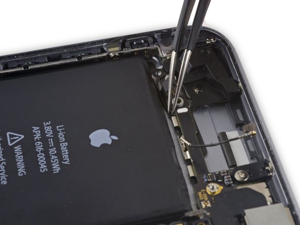

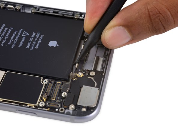

  25. iPhone 6s Plus Top Left Wi-Fi Antenna Replacement, Top left Wi-Fi Antenna: crwdns2935265:025crwdnd2935265:01crwdnd2935265:02crwdne2935265:0 iPhone 6s Plus Top Left Wi-Fi Antenna Replacement, Top left Wi-Fi Antenna: crwdns2935265:025crwdnd2935265:02crwdnd2935265:02crwdne2935265:0
    • Use the pointed end of a spudger to disconnect the top left antenna cable from the logic board.
  26. iPhone 6s Plus Top Left Wi-Fi Antenna Replacement: crwdns2935265:026crwdnd2935265:01crwdnd2935265:03crwdne2935265:0 iPhone 6s Plus Top Left Wi-Fi Antenna Replacement: crwdns2935265:026crwdnd2935265:02crwdnd2935265:03crwdne2935265:0 iPhone 6s Plus Top Left Wi-Fi Antenna Replacement: crwdns2935265:026crwdnd2935265:03crwdnd2935265:03crwdne2935265:0

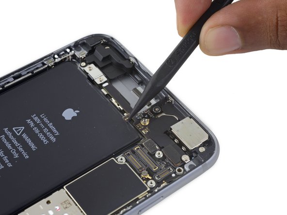

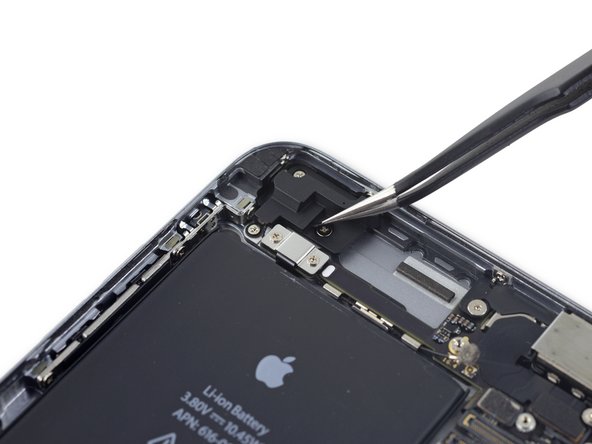

    • Remove the sticker covering the third screw securing the top left antenna to the rear case.
  27. iPhone 6s Plus Top Left Wi-Fi Antenna Replacement: crwdns2935265:027crwdnd2935265:01crwdnd2935265:01crwdne2935265:0

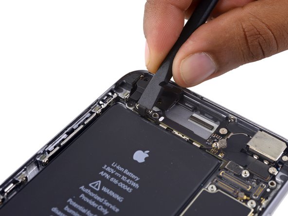

    • Remove the following five Phillips screws:
    • Three 2.7 mm screws
    • One 1.3 mm screw
    • One 1.7 mm screw

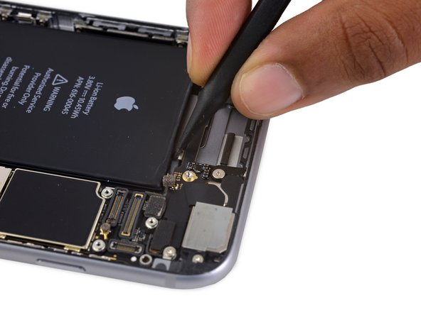

  28. iPhone 6s Plus Top Left Wi-Fi Antenna Replacement: crwdns2935265:028crwdnd2935265:01crwdnd2935265:02crwdne2935265:0 iPhone 6s Plus Top Left Wi-Fi Antenna Replacement: crwdns2935265:028crwdnd2935265:02crwdnd2935265:02crwdne2935265:0
    • Remove the audio control cable bracket.
  29. iPhone 6s Plus Top Left Wi-Fi Antenna Replacement: crwdns2935265:029crwdnd2935265:01crwdnd2935265:02crwdne2935265:0 iPhone 6s Plus Top Left Wi-Fi Antenna Replacement: crwdns2935265:029crwdnd2935265:02crwdnd2935265:02crwdne2935265:0
    • Disconnect the audio control flex cable.

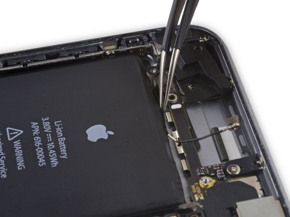

  30. iPhone 6s Plus Top Left Wi-Fi Antenna Replacement: crwdns2935265:030crwdnd2935265:01crwdnd2935265:03crwdne2935265:0 iPhone 6s Plus Top Left Wi-Fi Antenna Replacement: crwdns2935265:030crwdnd2935265:02crwdnd2935265:03crwdne2935265:0 iPhone 6s Plus Top Left Wi-Fi Antenna Replacement: crwdns2935265:030crwdnd2935265:03crwdnd2935265:03crwdne2935265:0

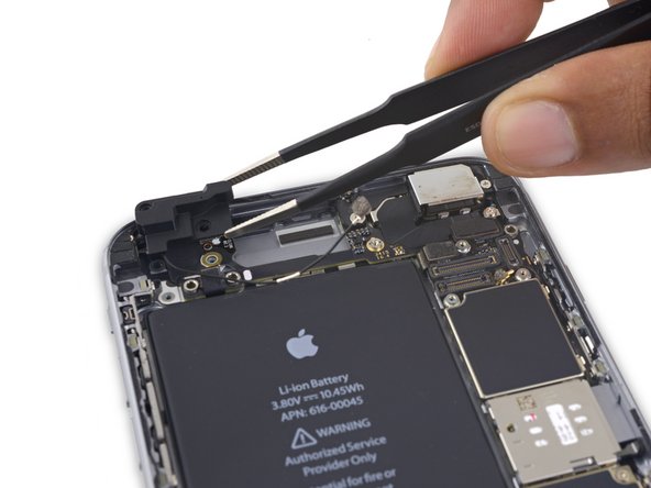

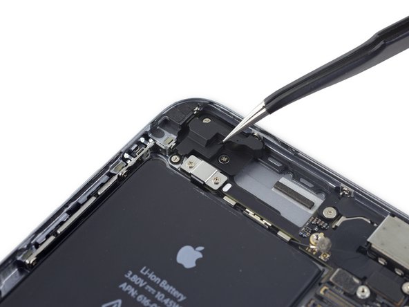

    • Use the pointed end of a spudger to gently nudge the top left antenna cable out from under the rightmost clip on the logic board.
  31. iPhone 6s Plus Top Left Wi-Fi Antenna Replacement: crwdns2935265:031crwdnd2935265:01crwdnd2935265:03crwdne2935265:0 iPhone 6s Plus Top Left Wi-Fi Antenna Replacement: crwdns2935265:031crwdnd2935265:02crwdnd2935265:03crwdne2935265:0 iPhone 6s Plus Top Left Wi-Fi Antenna Replacement: crwdns2935265:031crwdnd2935265:03crwdnd2935265:03crwdne2935265:0
    • Continue derouting the top left antenna cable from the second and third logic board clips.
    • Do not pull the cable out of the center clip, as it will tear easily. Instead, use the pointed tip of a spudger to gently pry it from the clip.
    • In order for the cable to reach its socket on the logic board, you must route it between the logic board and the audio control cable bracket, and underneath the audio control flex cable.
  32. iPhone 6s Plus Top Left Wi-Fi Antenna Replacement: crwdns2935265:032crwdnd2935265:01crwdnd2935265:02crwdne2935265:0 iPhone 6s Plus Top Left Wi-Fi Antenna Replacement: crwdns2935265:032crwdnd2935265:02crwdnd2935265:02crwdne2935265:0
    • Remove the top left antenna.
