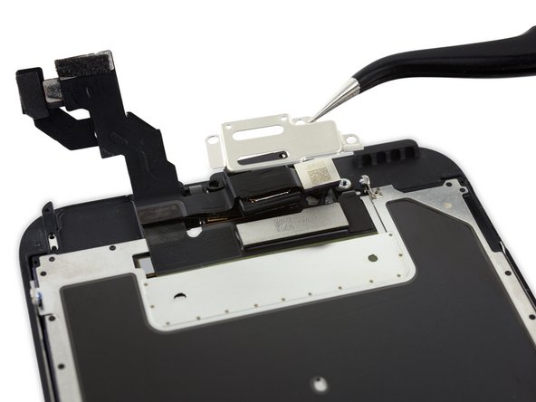

  33. iPhone 6s Plus LCD and Digitizer Replacement: crwdns2935265:033crwdnd2935265:01crwdnd2935265:02crwdne2935265:0 iPhone 6s Plus LCD and Digitizer Replacement: crwdns2935265:033crwdnd2935265:02crwdnd2935265:02crwdne2935265:0
    • Remove the earpiece speaker bracket.
  34. iPhone 6s Plus LCD and Digitizer Replacement: crwdns2935265:034crwdnd2935265:01crwdnd2935265:02crwdne2935265:0 iPhone 6s Plus LCD and Digitizer Replacement: crwdns2935265:034crwdnd2935265:02crwdnd2935265:02crwdne2935265:0

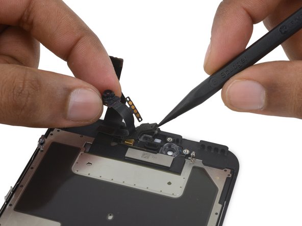

    • Use the flat end of a spudger to lift the FaceTime camera out of its housing.
  35. iPhone 6s Plus LCD and Digitizer Replacement: crwdns2935265:035crwdnd2935265:01crwdnd2935265:02crwdne2935265:0 iPhone 6s Plus LCD and Digitizer Replacement: crwdns2935265:035crwdnd2935265:02crwdnd2935265:02crwdne2935265:0
    • Pull the FaceTime camera back and remove the earpiece speaker.
  36. iPhone 6s Plus LCD and Digitizer Replacement, FaceTime Camera and Sensor Assembly: crwdns2935265:036crwdnd2935265:01crwdnd2935265:02crwdne2935265:0 iPhone 6s Plus LCD and Digitizer Replacement, FaceTime Camera and Sensor Assembly: crwdns2935265:036crwdnd2935265:02crwdnd2935265:02crwdne2935265:0

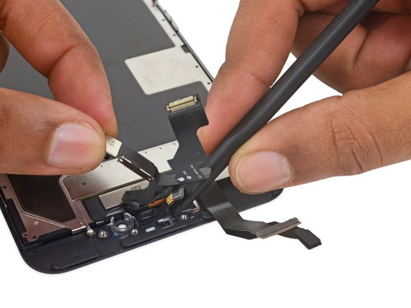

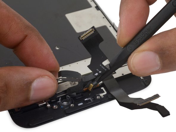

    • Use the pointed tip of a spudger to lift the ambient light sensor from its housing in the front panel.
  37. iPhone 6s Plus LCD and Digitizer Replacement: crwdns2935265:037crwdnd2935265:01crwdnd2935265:02crwdne2935265:0 iPhone 6s Plus LCD and Digitizer Replacement: crwdns2935265:037crwdnd2935265:02crwdnd2935265:02crwdne2935265:0

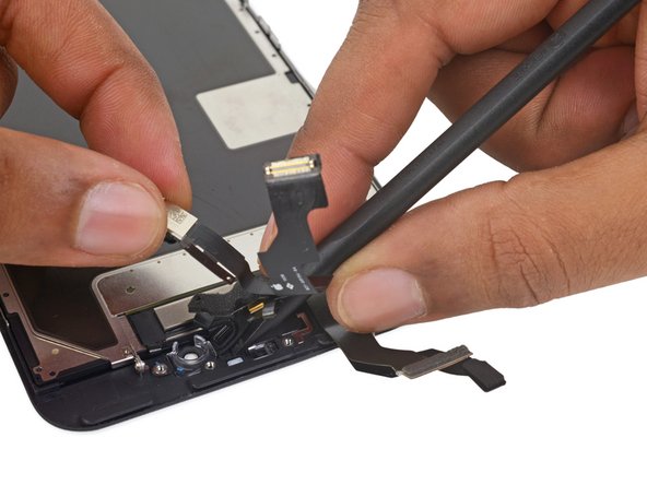

    • Insert the pointed tip of a spudger between the microphone flex cable and the front panel to break the adhesive holding it in place.
  38. iPhone 6s Plus LCD and Digitizer Replacement: crwdns2935265:038crwdnd2935265:01crwdnd2935265:03crwdne2935265:0 iPhone 6s Plus LCD and Digitizer Replacement: crwdns2935265:038crwdnd2935265:02crwdnd2935265:03crwdne2935265:0 iPhone 6s Plus LCD and Digitizer Replacement: crwdns2935265:038crwdnd2935265:03crwdnd2935265:03crwdne2935265:0
    • Use the flat tip of a spudger to lift up the microphone and earpiece gasket.
  39. iPhone 6s Plus LCD and Digitizer Replacement: crwdns2935265:039crwdnd2935265:01crwdnd2935265:02crwdne2935265:0 iPhone 6s Plus LCD and Digitizer Replacement: crwdns2935265:039crwdnd2935265:02crwdnd2935265:02crwdne2935265:0
    • Remove the FaceTime camera and sensor assembly.

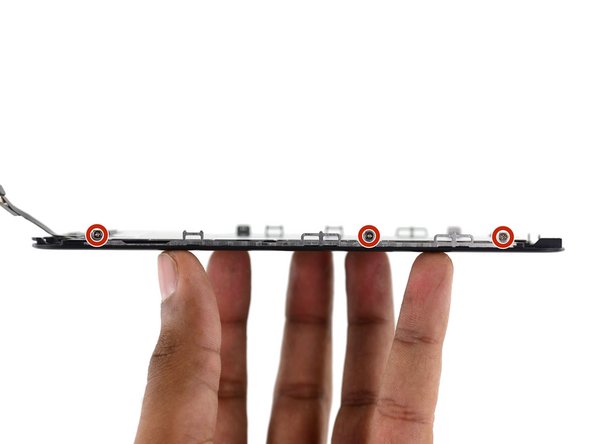

  40. iPhone 6s Plus LCD and Digitizer Replacement, Display EMI Shield: crwdns2935265:040crwdnd2935265:01crwdnd2935265:02crwdne2935265:0 iPhone 6s Plus LCD and Digitizer Replacement, Display EMI Shield: crwdns2935265:040crwdnd2935265:02crwdnd2935265:02crwdne2935265:0
    • Remove the seven 1.5 mm Phillips screws holding the display EMI shield in place.
    • The screw on the far right in the first photo is recessed about 1.8 cm from the edge of the display.
