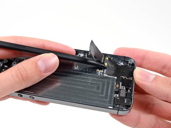

  25. iPhone 5s Rear Case Replacement, Logic Board: crwdns2935265:025crwdnd2935265:01crwdnd2935265:02crwdne2935265:0 iPhone 5s Rear Case Replacement, Logic Board: crwdns2935265:025crwdnd2935265:02crwdnd2935265:02crwdne2935265:0
    • Use a spudger to gently pry the button assembly cable up from its socket on the logic board.
    • Be very careful to only pry up on the connector and not the socket on the logic board. If you pry up on the logic board socket, you may break the connector entirely.
  26. iPhone 5s Rear Case Replacement: crwdns2935265:026crwdnd2935265:01crwdnd2935265:03crwdne2935265:0 iPhone 5s Rear Case Replacement: crwdns2935265:026crwdnd2935265:02crwdnd2935265:03crwdne2935265:0 iPhone 5s Rear Case Replacement: crwdns2935265:026crwdnd2935265:03crwdnd2935265:03crwdne2935265:0
    • Use a spudger to pry the Lightning connector cable up from its socket on the logic board.
    • Fold the Lightning connector cable out of the way of the logic board.

    • Slide the flat end of a spudger under the right-hand side of the lightning connector cable assembly to free it from the rear case.
  71. iPhone 5s Rear Case Replacement: crwdns2935265:071crwdnd2935265:01crwdnd2935265:02crwdne2935265:0 iPhone 5s Rear Case Replacement: crwdns2935265:071crwdnd2935265:02crwdnd2935265:02crwdne2935265:0
    • Continue to detach the lightning cable assembly by sliding the spudger under the port components.
  72. iPhone 5s Rear Case Replacement: crwdns2935265:072crwdnd2935265:01crwdnd2935265:01crwdne2935265:0
    • Remove the lightning cable assembly from the rear case.
  73. iPhone 5s Rear Case Replacement: crwdns2935265:073crwdnd2935265:01crwdnd2935265:02crwdne2935265:0 iPhone 5s Rear Case Replacement: crwdns2935265:073crwdnd2935265:02crwdnd2935265:02crwdne2935265:0
    • There are two small metal pieces—a bracket and washer that may come loose and fall out of the phone with the Lightning connector assembly removed.
    • Take these pieces out and set them aside for safe keeping.
