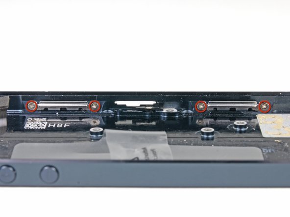

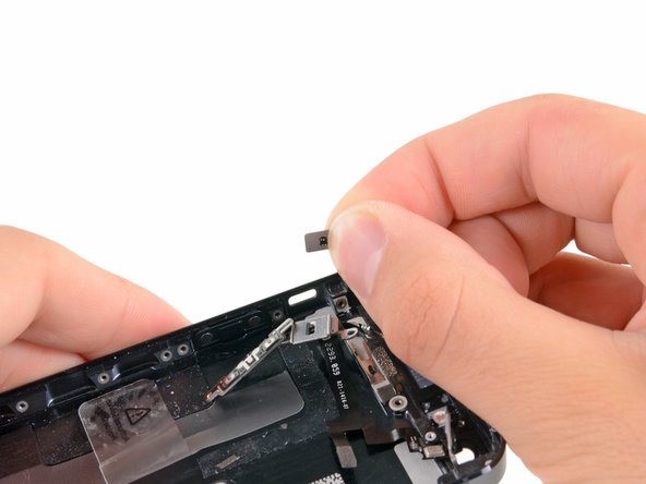

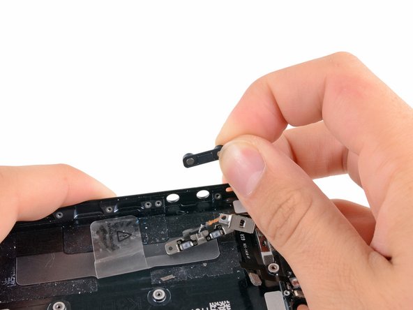

    1. iPhone 5 Rear Case Replacement, Logic Board Assembly: crwdns2935265:020crwdnd2935265:01crwdnd2935265:01crwdne2935265:0
      • Use the tip of a spudger to pry the cellular data antenna cable connector up from its socket on the logic board, just above the speaker enclosure.
    2. iPhone 5 Rear Case Replacement: crwdns2935265:021crwdnd2935265:01crwdnd2935265:01crwdne2935265:0
      • Remove the following two screws securing the top logic board bracket to the rear case:
      • One 1.5 mm Phillips screw
      • One 2.3 mm Phillips screw
    3. iPhone 5 Rear Case Replacement: crwdns2935265:022crwdnd2935265:01crwdnd2935265:02crwdne2935265:0 iPhone 5 Rear Case Replacement: crwdns2935265:022crwdnd2935265:02crwdnd2935265:02crwdne2935265:0
      • Remove the bracket from the top of the logic board.
      • Be sure not to break off the tiny grounding tab that sticks up off of the bracket next to the rear facing camera.
      • On newer models, the bracket may be attached to the camera housing and will not come completely out.
    4. iPhone 5 Rear Case Replacement: crwdns2935265:023crwdnd2935265:01crwdnd2935265:03crwdne2935265:0 iPhone 5 Rear Case Replacement: crwdns2935265:023crwdnd2935265:02crwdnd2935265:03crwdne2935265:0 iPhone 5 Rear Case Replacement: crwdns2935265:023crwdnd2935265:03crwdnd2935265:03crwdne2935265:0
      • Use the flat end of a spudger to disconnect the following three cables from the logic board:
      • Upper interconnect cable
      • Button assembly cable
      • Lower interconnect cable
    5. iPhone 5 Rear Case Replacement: crwdns2935265:024crwdnd2935265:01crwdnd2935265:01crwdne2935265:0
      • Remove the two 1.3 mm Phillips screws from the inner top of the rear case.
    6. iPhone 5 Rear Case Replacement: crwdns2935265:025crwdnd2935265:01crwdnd2935265:01crwdne2935265:0
      • Remove the single 1.2 mm Phillips screw remaining in the mid-section logic board bracket.
    7. iPhone 5 Rear Case Replacement: crwdns2935265:026crwdnd2935265:01crwdnd2935265:02crwdne2935265:0 iPhone 5 Rear Case Replacement: crwdns2935265:026crwdnd2935265:02crwdnd2935265:02crwdne2935265:0
      • Remove the mid-section bracket from the logic board.
    8. iPhone 5 Rear Case Replacement: crwdns2935265:027crwdnd2935265:01crwdnd2935265:02crwdne2935265:0 iPhone 5 Rear Case Replacement: crwdns2935265:027crwdnd2935265:02crwdnd2935265:02crwdne2935265:0
      • Use a spudger to pry the Lightning connector cable connector up from its socket on the logic board.
      • Gently peel the cable back and out of the way of the logic board.
    9. iPhone 5 Rear Case Replacement: crwdns2935265:028crwdnd2935265:01crwdnd2935265:03crwdne2935265:0 iPhone 5 Rear Case Replacement: crwdns2935265:028crwdnd2935265:02crwdnd2935265:03crwdne2935265:0 iPhone 5 Rear Case Replacement: crwdns2935265:028crwdnd2935265:03crwdnd2935265:03crwdne2935265:0
      • Depress the SIM card release on the right side of the iPhone with a SIM card eject tool or a bent paperclip to eject the SIM card tray.
      • Alternatively, you can press the SIM card eject lever from the inside with the flat end of a spudger.
      • Remove the SIM card tray from the iPhone.
    10. iPhone 5 Rear Case Replacement: crwdns2935265:029crwdnd2935265:01crwdnd2935265:01crwdne2935265:0
      Standoff Screwdriver for iPhones
      $5.49
      • Remove the following screws securing the logic board to the rear case:
      • Two 2.3 mm Phillips screws
      • Two 2.7 mm standoff screws
      • Standoff screws are best removed using a standoff screwdriver or bit.
      • In a pinch, a small flathead screwdriver will do the job—but use extra caution to ensure it doesn't slip and damage surrounding components.

    4. iPhone 5 Rear Case Replacement: crwdns2935265:043crwdnd2935265:01crwdnd2935265:01crwdne2935265:0
      • Use the tip of a spudger to press the power button cover in and lift it off of its hinge in the rear case.
    5. iPhone 5 Rear Case Replacement: crwdns2935265:044crwdnd2935265:01crwdnd2935265:01crwdne2935265:0
      • Remove the following screws securing the volume and silence buttons to the side of the rear case:
      • One 1.3 mm Phillips screw
      • Two 1.8 mm Phillips screws
    6. iPhone 5 Rear Case Replacement: crwdns2935265:045crwdnd2935265:01crwdnd2935265:03crwdne2935265:0 iPhone 5 Rear Case Replacement: crwdns2935265:045crwdnd2935265:02crwdnd2935265:03crwdne2935265:0 iPhone 5 Rear Case Replacement: crwdns2935265:045crwdnd2935265:03crwdnd2935265:03crwdne2935265:0
      • Pry the button cable away from the side of the rear case to expose the silence and volume buttons.
      • Remove the silence and volume buttons from the rear case.
