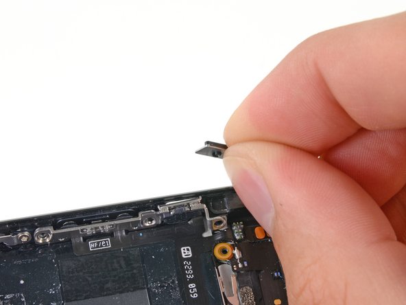

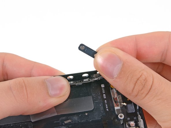

    10. iPhone 5 Audio Control and Power Button Cable Replacement: crwdns2935265:029crwdnd2935265:01crwdnd2935265:01crwdne2935265:0
      Standoff Screwdriver for iPhones
      $5.49
      • Remove the following screws securing the logic board to the rear case:
      • Two 2.3 mm Phillips screws

    3. iPhone 5 Audio Control and Power Button Cable Replacement: crwdns2935265:035crwdnd2935265:01crwdnd2935265:01crwdne2935265:0
      • Remove the metal bracket between the rear facing flash and camera windows.
    4. iPhone 5 Audio Control and Power Button Cable Replacement: crwdns2935265:036crwdnd2935265:01crwdnd2935265:02crwdne2935265:0 iPhone 5 Audio Control and Power Button Cable Replacement: crwdns2935265:036crwdnd2935265:02crwdnd2935265:02crwdne2935265:0
      • Use the tip of a spudger to flip the metal bracket holding the power switch away from the top of the rear case.
    5. iPhone 5 Audio Control and Power Button Cable Replacement: crwdns2935265:037crwdnd2935265:01crwdnd2935265:03crwdne2935265:0 iPhone 5 Audio Control and Power Button Cable Replacement: crwdns2935265:037crwdnd2935265:02crwdnd2935265:03crwdne2935265:0 iPhone 5 Audio Control and Power Button Cable Replacement: crwdns2935265:037crwdnd2935265:03crwdnd2935265:03crwdne2935265:0
      • Press the power button into the rear case from the outside of the phone with the tip of a spudger.
      • Remove the power button.

    4. iPhone 5 Audio Control and Power Button Cable Replacement: crwdns2935265:041crwdnd2935265:01crwdnd2935265:02crwdne2935265:0 iPhone 5 Audio Control and Power Button Cable Replacement: crwdns2935265:041crwdnd2935265:02crwdnd2935265:02crwdne2935265:0
      • Use the tip of a spudger to pry the ringer switch bracket from the side of the rear case.
      • Remove the ringer switch.
    5. iPhone 5 Audio Control and Power Button Cable Replacement: crwdns2935265:042crwdnd2935265:01crwdnd2935265:02crwdne2935265:0 iPhone 5 Audio Control and Power Button Cable Replacement: crwdns2935265:042crwdnd2935265:02crwdnd2935265:02crwdne2935265:0
      • Use a spudger to pry the volume button bracket from the side of the rear case.
      • Remove the volume buttons.
