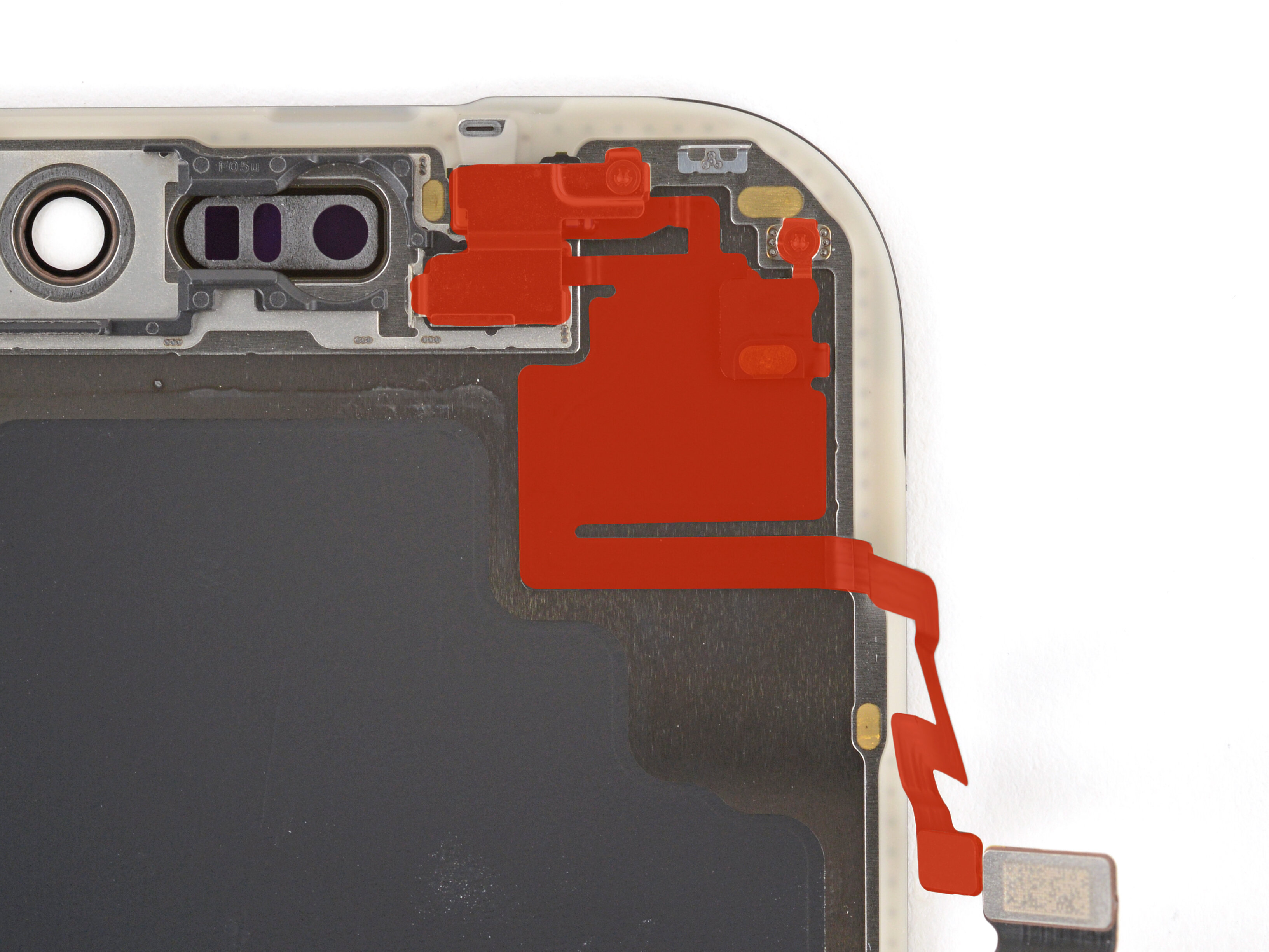

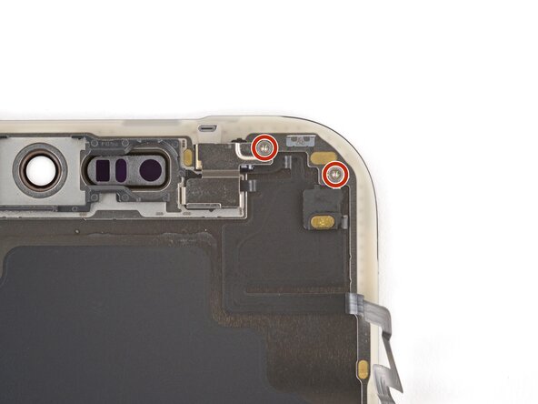

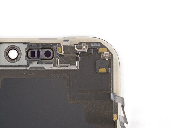

    1. iPhone 17 Pro Screen Replacement, Remove the front sensors screws: crwdns2935265:024crwdnd2935265:01crwdnd2935265:02crwdne2935265:0 iPhone 17 Pro Screen Replacement, Remove the front sensors screws: crwdns2935265:024crwdnd2935265:02crwdnd2935265:02crwdne2935265:0
      • If your replacement screen doesn't have front sensors installed, follow the next five steps to remove them—they'll need to be transferred to your replacement screen.
      • Use a tri‑point Y000 screwdriver to remove the two 1.0 mm‑long front sensors screws.

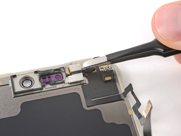

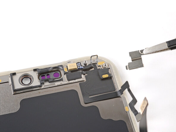

    2. iPhone 17 Pro Screen Replacement, Remove the bracket: crwdns2935265:025crwdnd2935265:01crwdnd2935265:02crwdne2935265:0 iPhone 17 Pro Screen Replacement, Remove the bracket: crwdns2935265:025crwdnd2935265:02crwdnd2935265:02crwdne2935265:0
      • Remove the front sensors bracket.

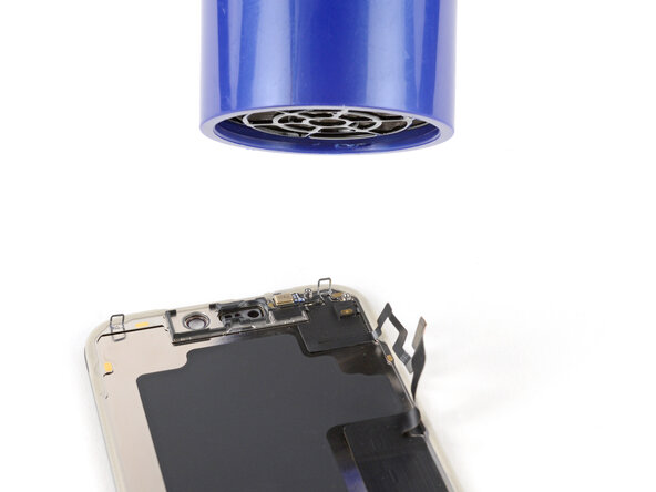

    3. iPhone 17 Pro Screen Replacement, Heat the front sensors: crwdns2935265:026crwdnd2935265:01crwdnd2935265:01crwdne2935265:0
      • Use a hair dryer or heat gun to heat the front sensors.
      • You can heat the sensor directly, or heat its corresponding spot on the front of the screen.

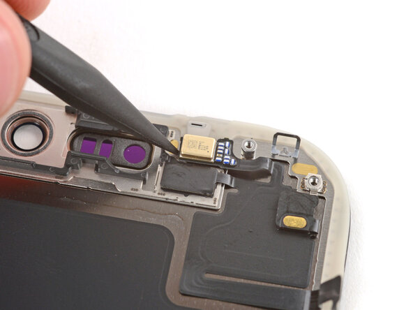

    4. iPhone 17 Pro Screen Replacement, Pry up the sensors: crwdns2935265:027crwdnd2935265:01crwdnd2935265:03crwdne2935265:0 iPhone 17 Pro Screen Replacement, Pry up the sensors: crwdns2935265:027crwdnd2935265:02crwdnd2935265:03crwdne2935265:0 iPhone 17 Pro Screen Replacement, Pry up the sensors: crwdns2935265:027crwdnd2935265:03crwdnd2935265:03crwdne2935265:0
      • The front sensors are very fragile and can easily rip—be very gentle while removing them. If you're having trouble, apply more heat and try again.
      • Use the point of a spudger to pry up both front sensors.
      • Pry on the tab under the sensors—not the sensors themselves—or you may damage them.

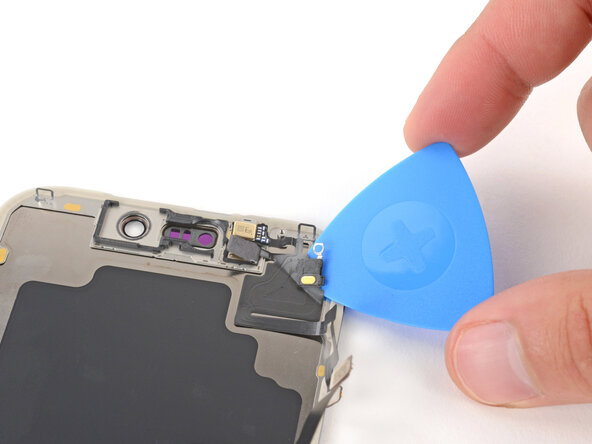

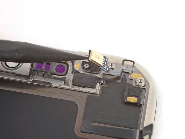

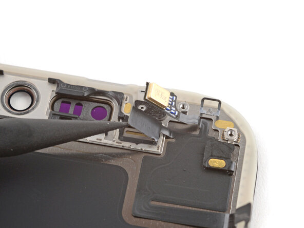

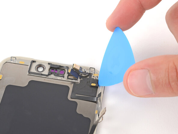

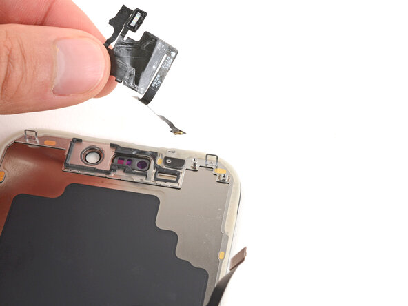

    5. iPhone 17 Pro Screen Replacement, Remove the sensors: crwdns2935265:028crwdnd2935265:01crwdnd2935265:03crwdne2935265:0 iPhone 17 Pro Screen Replacement, Remove the sensors: crwdns2935265:028crwdnd2935265:02crwdnd2935265:03crwdne2935265:0 iPhone 17 Pro Screen Replacement, Remove the sensors: crwdns2935265:028crwdnd2935265:03crwdnd2935265:03crwdne2935265:0
      • Insert the tip of an opening pick under the top right corner of the front sensors large, glued-down cable.
      • Slowly slide the pick under the cable and lift until you can grip it with your fingers.
      • Use your fingers to peel up the cable and remove the sensors.
      • You can now transfer the sensors to your replacement screen.

    1. iPhone 17 Pro Screen Replacement, Attach the front sensors: crwdns2935265:030crwdnd2935265:01crwdnd2935265:02crwdne2935265:0 iPhone 17 Pro Screen Replacement, Attach the front sensors: crwdns2935265:030crwdnd2935265:02crwdnd2935265:02crwdne2935265:0
      Tesa 61395 Tape
      $2.95
      • The next four steps show how to attach the front sensors to the replacement screen. If your screen comes with front sensors preinstalled, skip down four steps.
      • Use your finger to press the rectangular section of the front sensors cable onto the screen.
      • Use a hair dryer or iOpener to soften the adhesive under the cable to help it stick. It only needs to be warm—not hot.
      • If the cable isn't sticking, apply a small piece of double-sided tape to the back of the cable.
    2. iPhone 17 Pro Screen Replacement: crwdns2935265:031crwdnd2935265:01crwdnd2935265:02crwdne2935265:0 iPhone 17 Pro Screen Replacement: crwdns2935265:031crwdnd2935265:02crwdnd2935265:02crwdne2935265:0
      • Use your finger or a spudger to press the ambient light sensor and microphone into their recesses.
    3. iPhone 17 Pro Screen Replacement: crwdns2935265:032crwdnd2935265:01crwdnd2935265:02crwdne2935265:0 iPhone 17 Pro Screen Replacement: crwdns2935265:032crwdnd2935265:02crwdnd2935265:02crwdne2935265:0
      • Hook the left tab of the front sensors bracket onto the screen and set it into place.
    4. iPhone 17 Pro Screen Replacement: crwdns2935265:033crwdnd2935265:01crwdnd2935265:01crwdne2935265:0
      • Use a tri‑point Y000 screwdriver to install the two 1.0 mm‑long front sensors screws.

    6. iPhone 17 Pro Screen Replacement: crwdns2935265:039crwdnd2935265:01crwdnd2935265:02crwdne2935265:0 iPhone 17 Pro Screen Replacement: crwdns2935265:039crwdnd2935265:02crwdnd2935265:02crwdne2935265:0
      • Once the adhesive is pressed into place, you can't reposition it—you'll have to remove it and start over with new adhesive.
      • Carefully align the exposed edge of the adhesive strip with the corresponding edge of the iPhone's frame.
      • When it's correctly aligned, gently press the exposed adhesive strip onto the frame.
    7. iPhone 17 Pro Screen Replacement: crwdns2935265:040crwdnd2935265:01crwdnd2935265:03crwdne2935265:0 iPhone 17 Pro Screen Replacement: crwdns2935265:040crwdnd2935265:02crwdnd2935265:03crwdne2935265:0 iPhone 17 Pro Screen Replacement: crwdns2935265:040crwdnd2935265:03crwdnd2935265:03crwdne2935265:0
      • Continue peeling away the liner from the adhesive, gently pressing the adhesive into place.
      • If you've correctly aligned the adhesive, the edges will fall perfectly into place.
      • If your adhesive is slightly misaligned, gently pull the long edges into alignment with the frame.
      • If the adhesive begins to crease or wrinkle, remove it and start over with fresh adhesive.
      • If you don't have another set of adhesive strips handy, it's okay to temporarily put your iPhone back together and use it normally without any adhesive. Just keep in mind that your iPhone's water resistance will be compromised until you replace the adhesive.
    8. iPhone 17 Pro Screen Replacement: crwdns2935265:041crwdnd2935265:01crwdnd2935265:02crwdne2935265:0 iPhone 17 Pro Screen Replacement: crwdns2935265:041crwdnd2935265:02crwdnd2935265:02crwdne2935265:0
      • Use a spudger to press the adhesive around the entire perimeter of your iPhone.
      • Work around the fragile grounding clips. If you bend one out of place, gently bend it back with your fingers or tweezers.
      • Don't press too hard, or you'll stretch and deform the adhesive.
    9. iPhone 17 Pro Screen Replacement: crwdns2935265:042crwdnd2935265:01crwdnd2935265:03crwdne2935265:0 iPhone 17 Pro Screen Replacement: crwdns2935265:042crwdnd2935265:02crwdnd2935265:03crwdne2935265:0 iPhone 17 Pro Screen Replacement: crwdns2935265:042crwdnd2935265:03crwdnd2935265:03crwdne2935265:0
      • Use the pull tab to peel off the large front liner from the adhesive. The pull tab is often in a corner of the liner.
      • At this point, you'll still have liners covering the perimeter. Don't remove these liners yet—they prevent the adhesive from accidentally sticking while you reassemble your iPhone.
