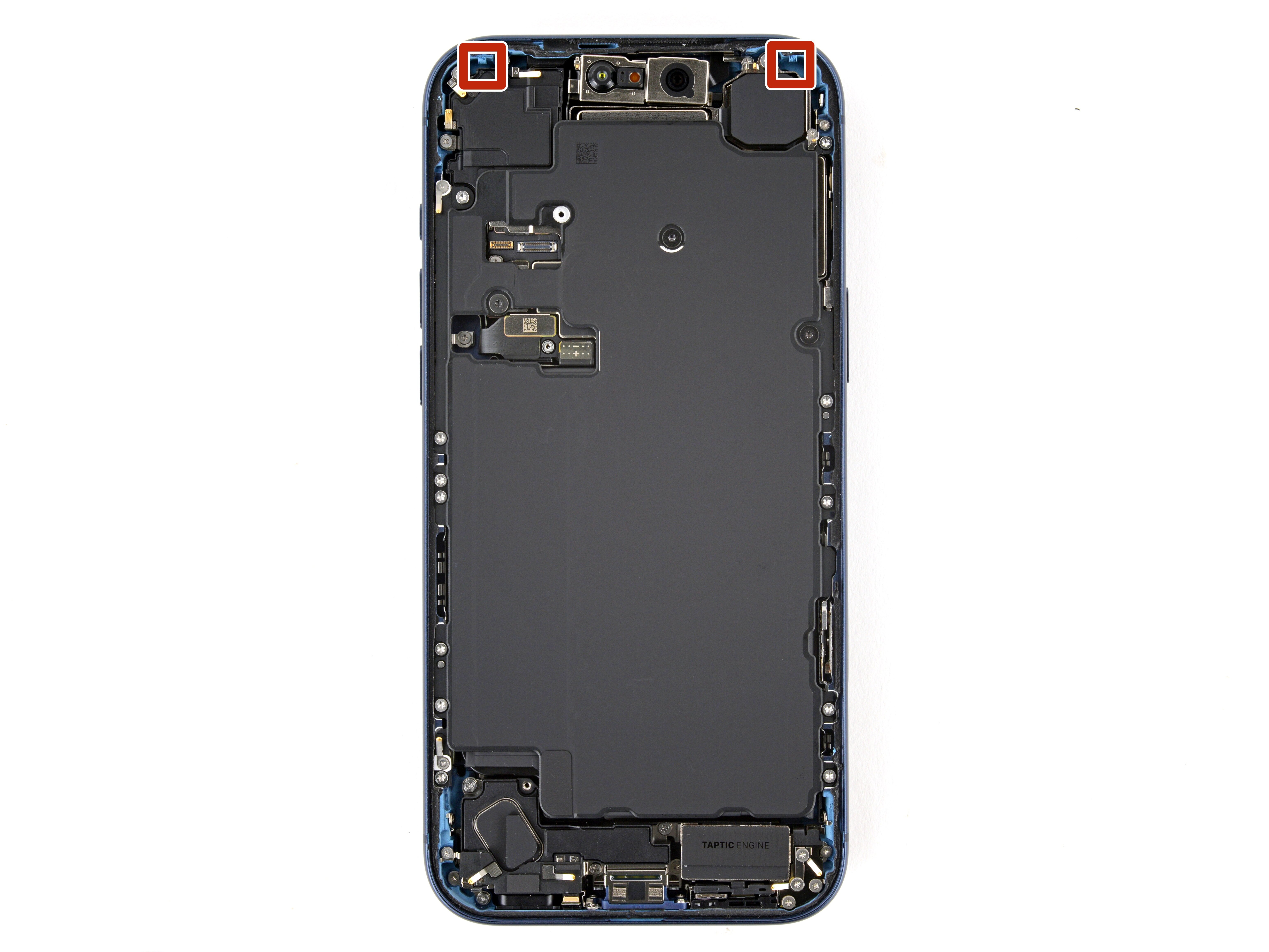

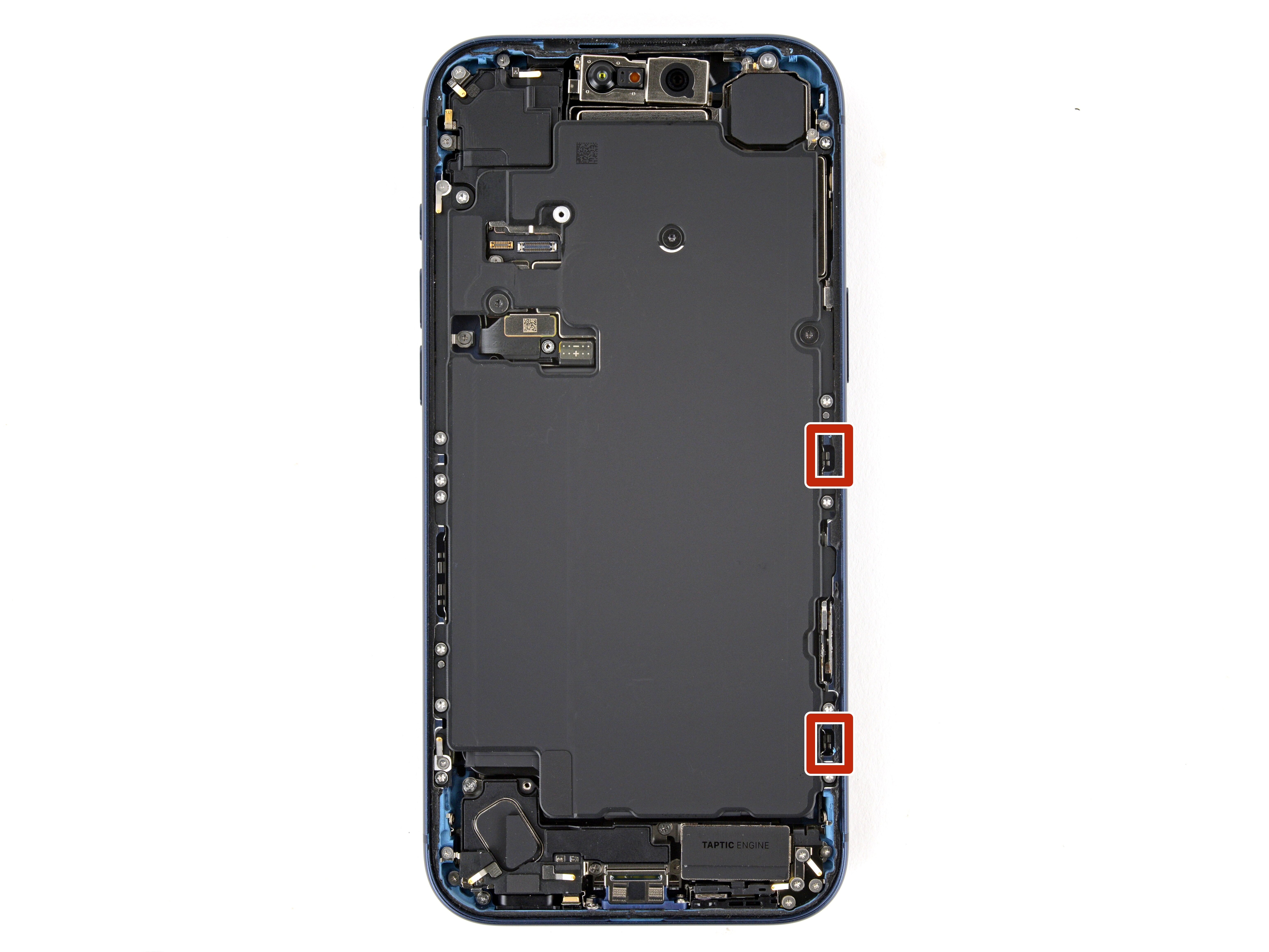

  3. iPhone 17 Pro Max Screen Replacement, Remove the pentalobe screws: crwdns2935265:03crwdnd2935265:01crwdnd2935265:02crwdne2935265:0 iPhone 17 Pro Max Screen Replacement, Remove the pentalobe screws: crwdns2935265:03crwdnd2935265:02crwdnd2935265:02crwdne2935265:0
    • Use a P2 pentalobe screwdriver to remove the two 7.5 mm‑long screws on either side of the charging port.

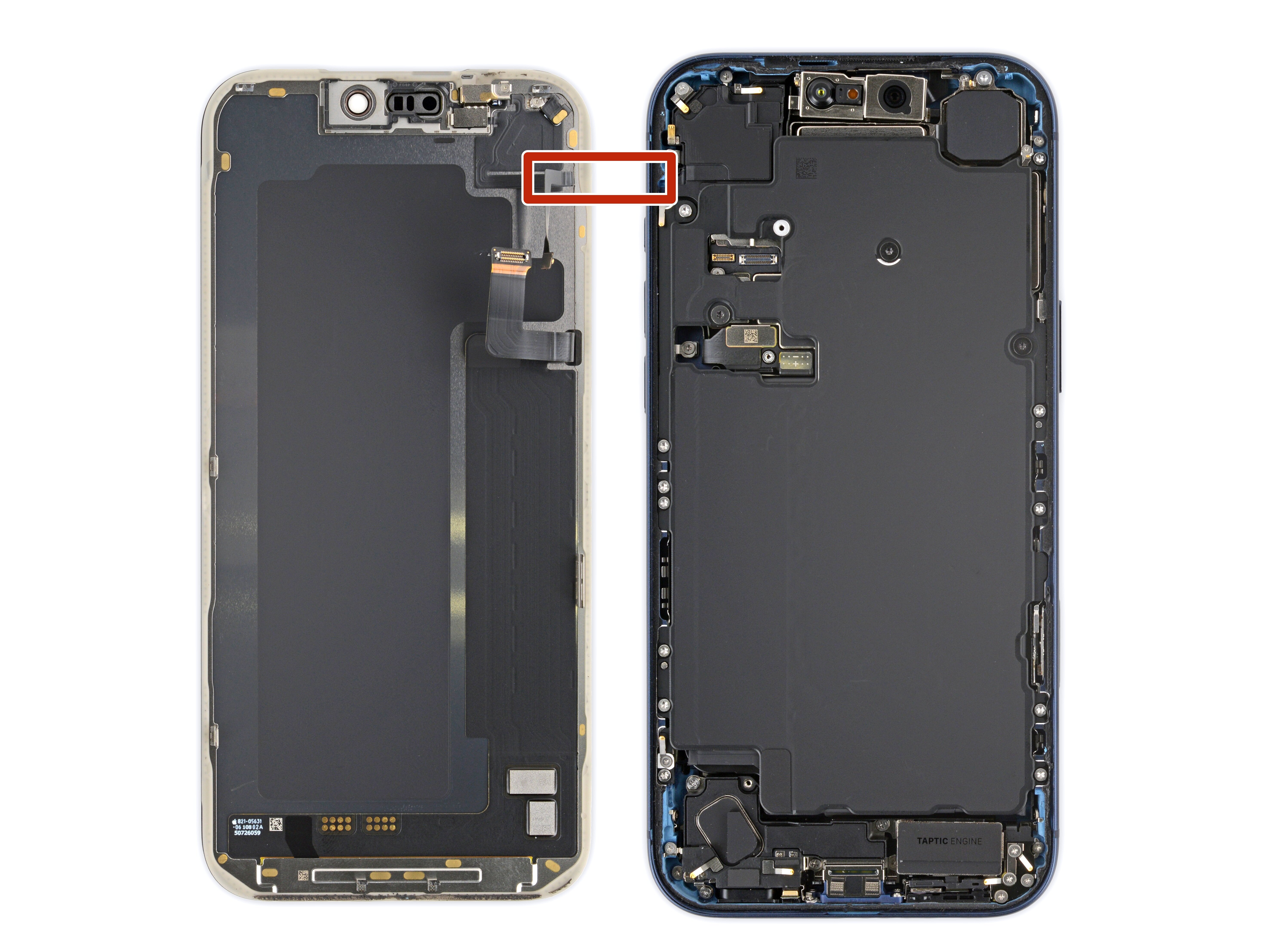

    • During the next step, make sure you're inserting your pick in the correct location:
    • There's a plastic bezel on the underside of the screen that sits on the frame. Insert your pick here, making sure it's completely under the bezel.
    • There's a seam between the plastic bezel and the display panel. Don't insert your pick here or you'll separate the two, complicating the repair.
  8. iPhone 17 Pro Max Screen Replacement, Insert an opening pick: crwdns2935265:08crwdnd2935265:01crwdnd2935265:03crwdne2935265:0 iPhone 17 Pro Max Screen Replacement, Insert an opening pick: crwdns2935265:08crwdnd2935265:02crwdnd2935265:03crwdne2935265:0 iPhone 17 Pro Max Screen Replacement, Insert an opening pick: crwdns2935265:08crwdnd2935265:03crwdnd2935265:03crwdne2935265:0
    • Pull up on the suction handle with strong, steady force until a gap forms between the screen and frame.
    • This may take significant force. If you're having trouble, reheat the screen and try again.
    • Insert the tip of an opening pick in the gap you just created.

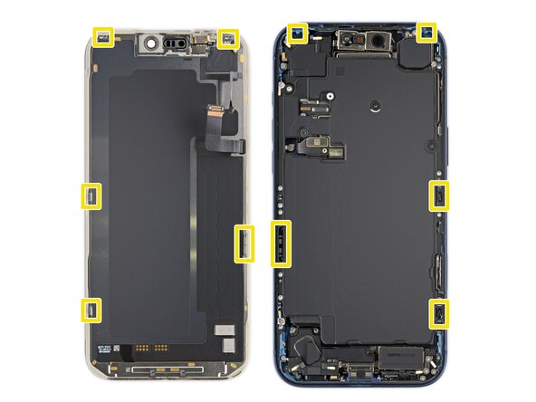

  9. iPhone 17 Pro Max Screen Replacement, Screen information: crwdns2935265:09crwdnd2935265:01crwdnd2935265:03crwdne2935265:0 iPhone 17 Pro Max Screen Replacement, Screen information: crwdns2935265:09crwdnd2935265:02crwdnd2935265:03crwdne2935265:0 iPhone 17 Pro Max Screen Replacement, Screen information: crwdns2935265:09crwdnd2935265:03crwdnd2935265:03crwdne2935265:0
    • Don't insert your pick more than 3 mm under the screen to avoid damaging the following components:
    • The screen and ambient light sensor cables are located near the volume and Action buttons.
    • There are delicate spring contacts around the perimeter of the phone.
    • The underside of the screen has thin, metal clips that go into corresponding slots on the frame.

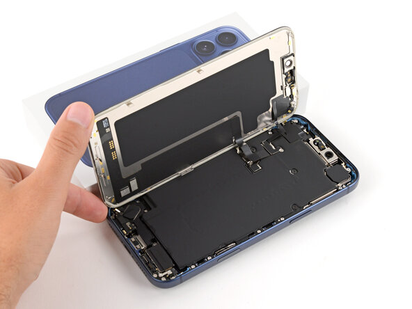

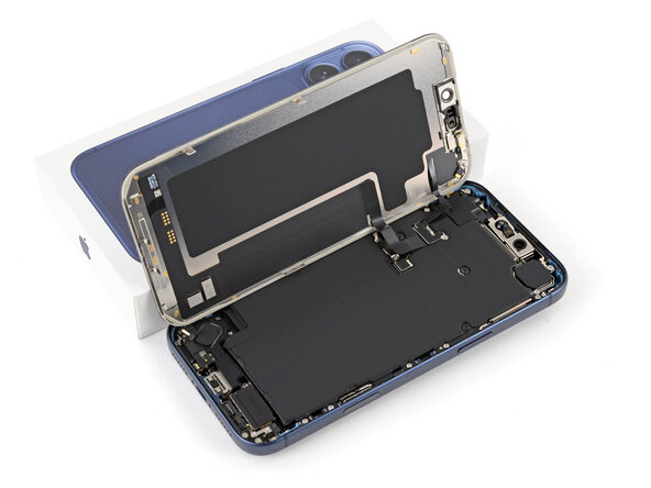

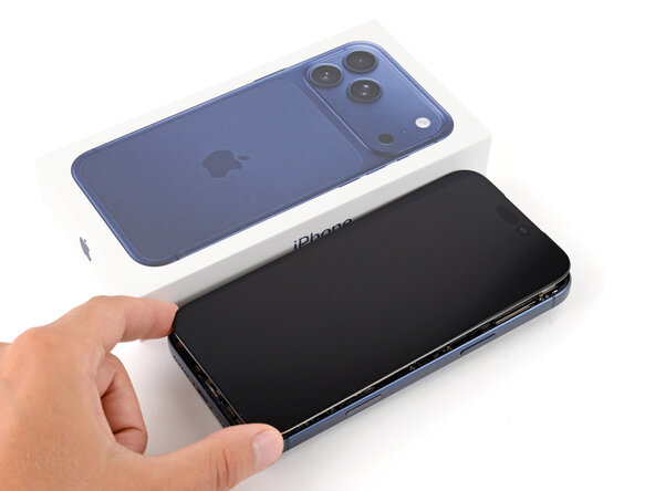

  18. iPhone 17 Pro Max Screen Replacement, Prop up the screen: crwdns2935265:018crwdnd2935265:01crwdnd2935265:03crwdne2935265:0 iPhone 17 Pro Max Screen Replacement, Prop up the screen: crwdns2935265:018crwdnd2935265:02crwdnd2935265:03crwdne2935265:0 iPhone 17 Pro Max Screen Replacement, Prop up the screen: crwdns2935265:018crwdnd2935265:03crwdnd2935265:03crwdne2935265:0
    • At this point, the screen should be completely detached from the frame. If it feels stuck, go back around the perimeter and separate any remaining adhesive or clips.
    • Lift the screen straight up and swing it over the left edge, propping it up against a sturdy box or stack of books so the cables aren't strained.
    • Alternatively, you can lay the screen down flat over the left side.

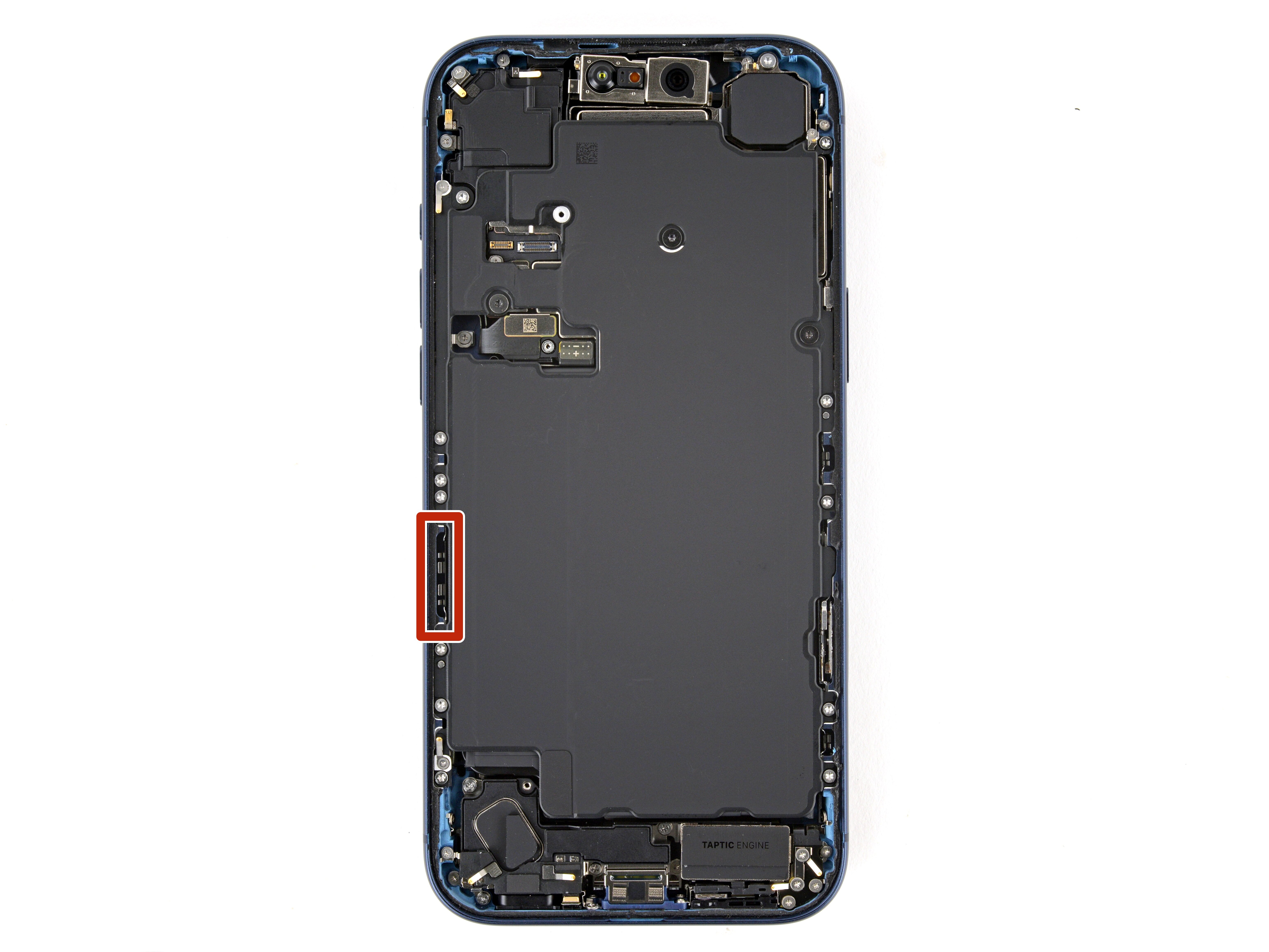

  19. iPhone 17 Pro Max Screen Replacement, Remove the cover screws: crwdns2935265:019crwdnd2935265:01crwdnd2935265:02crwdne2935265:0 iPhone 17 Pro Max Screen Replacement, Remove the cover screws: crwdns2935265:019crwdnd2935265:02crwdnd2935265:02crwdne2935265:0
    FixMat
    $31.41
    • Use a JIS 00 screwdriver to remove the two 1.2 mm‑long screws securing the battery and screen cable covers (one for each cover).
    • Small iFixit Phillips bits are designed to work with JIS screws. You can try Phillips drivers from other manufacturers, but you risk stripping the screw.

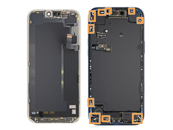

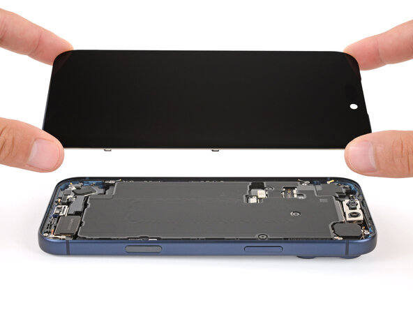

  23. iPhone 17 Pro Max Screen Replacement, Remove the screen: crwdns2935265:023crwdnd2935265:01crwdnd2935265:01crwdne2935265:0
    • Remove the screen.
    • During reassembly, follow this guide to apply adhesive and install your screen.
    • Be careful not to damage any of the spring contacts as you clean the frame.

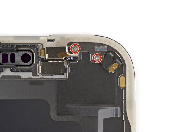

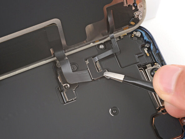

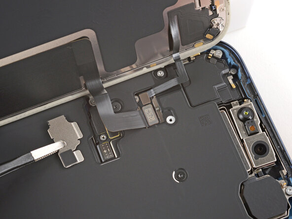

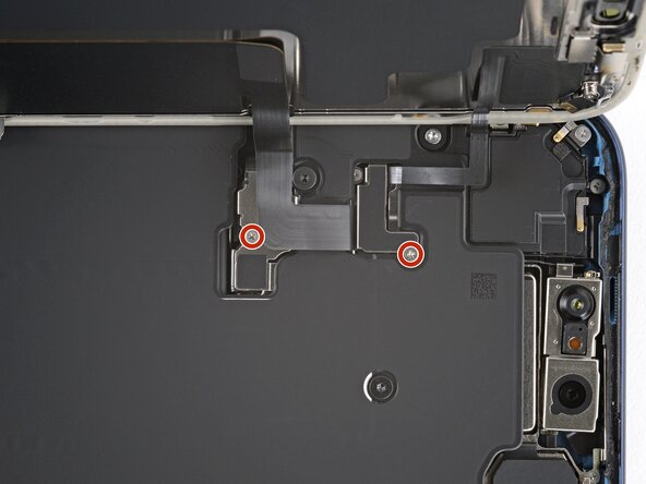

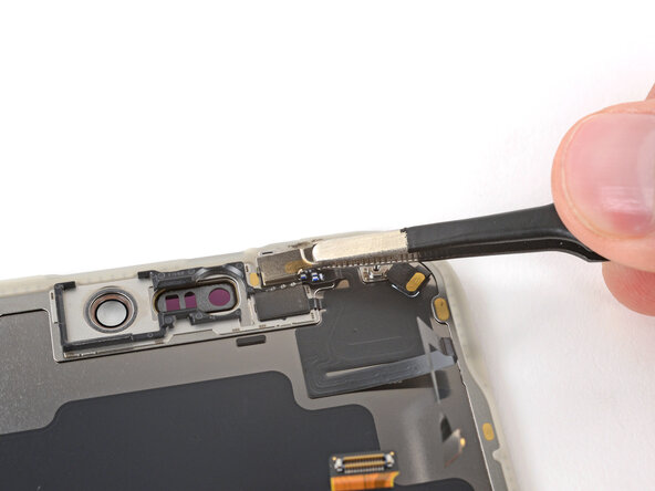

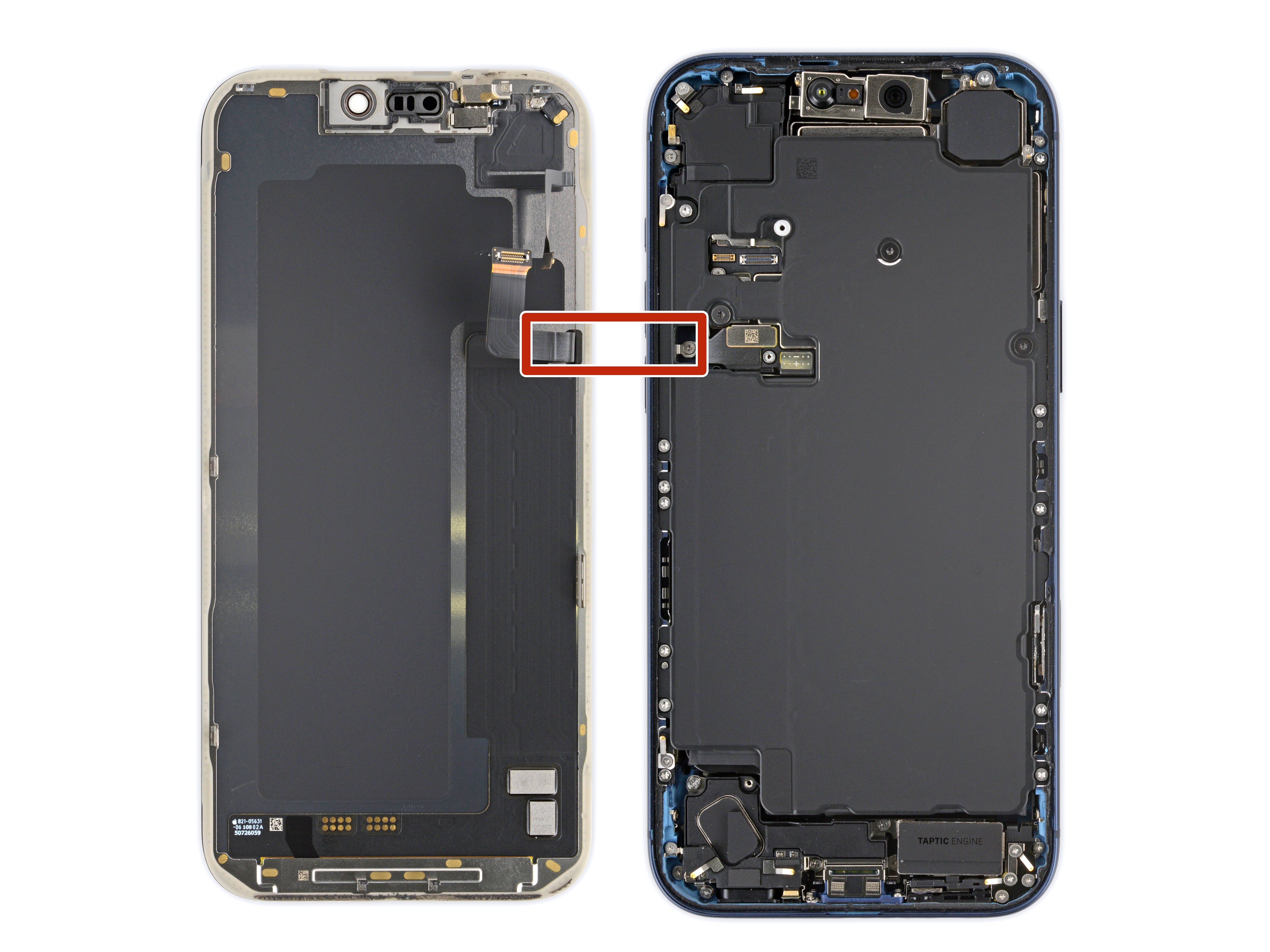

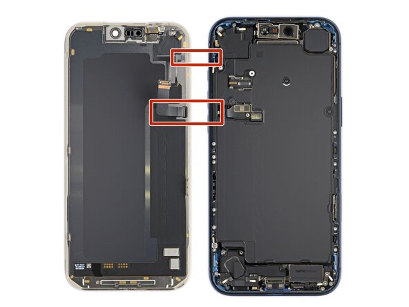

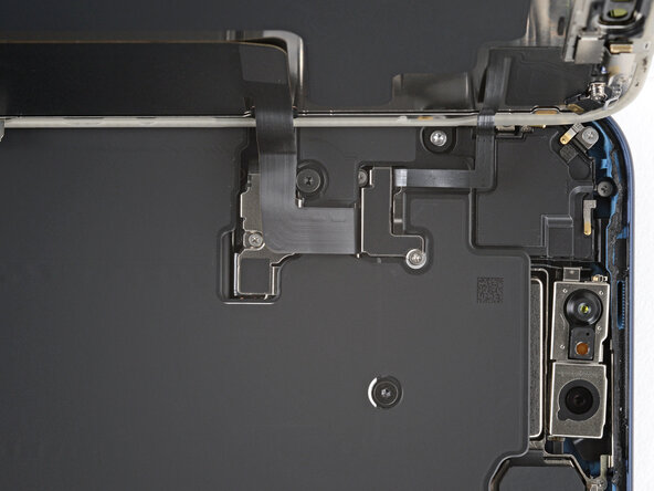

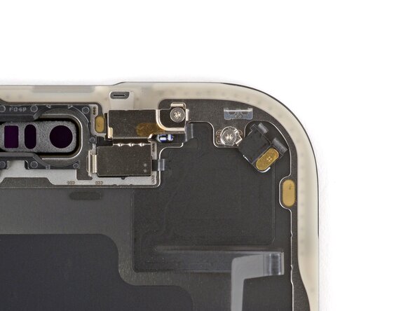

  24. iPhone 17 Pro Max Screen Replacement, Remove the front sensors screws: crwdns2935265:024crwdnd2935265:01crwdnd2935265:02crwdne2935265:0 iPhone 17 Pro Max Screen Replacement, Remove the front sensors screws: crwdns2935265:024crwdnd2935265:02crwdnd2935265:02crwdne2935265:0
    • If your replacement screen doesn't have front sensors installed, follow the next six steps to remove and transfer them.
    • Use a tri‑point Y000 screwdriver to remove the two 1.0 mm‑long front sensors screws.

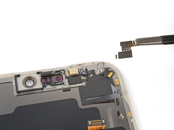

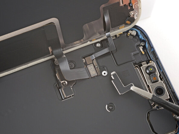

  25. iPhone 17 Pro Max Screen Replacement, Remove the bracket: crwdns2935265:025crwdnd2935265:01crwdnd2935265:02crwdne2935265:0 iPhone 17 Pro Max Screen Replacement, Remove the bracket: crwdns2935265:025crwdnd2935265:02crwdnd2935265:02crwdne2935265:0
    • Remove the front sensors bracket.

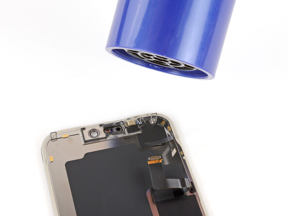

  26. iPhone 17 Pro Max Screen Replacement, Heat the front sensors: crwdns2935265:026crwdnd2935265:01crwdnd2935265:01crwdne2935265:0
    • Use a hair dryer or heat gun to heat the front sensors.
    • You can heat the sensor directly, or heat its corresponding spot on the front of the screen.

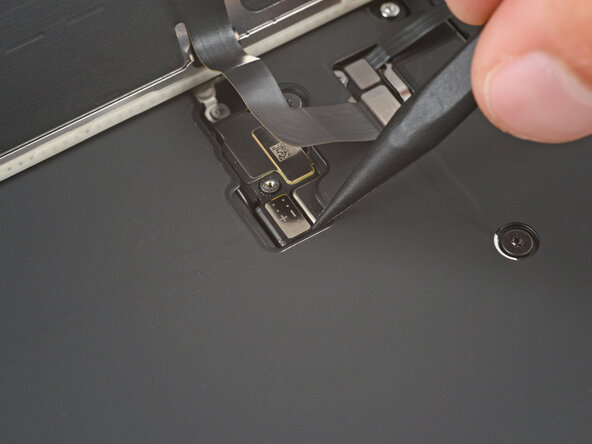

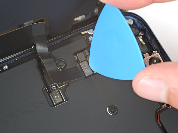

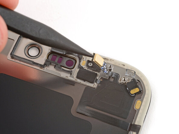

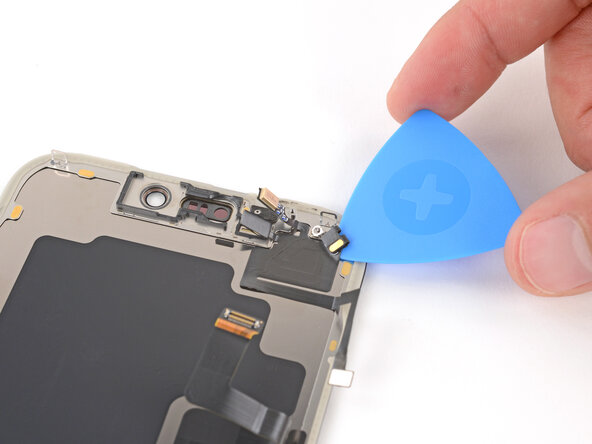

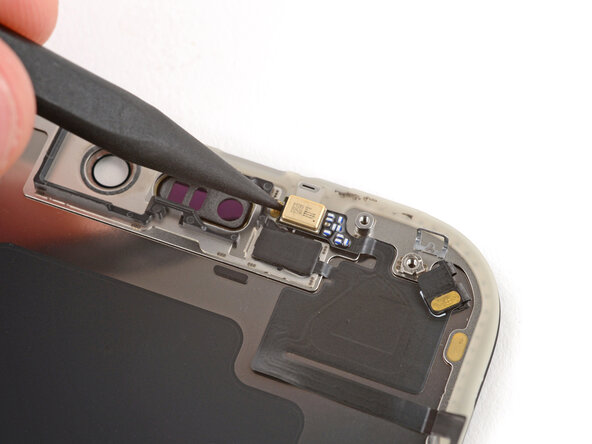

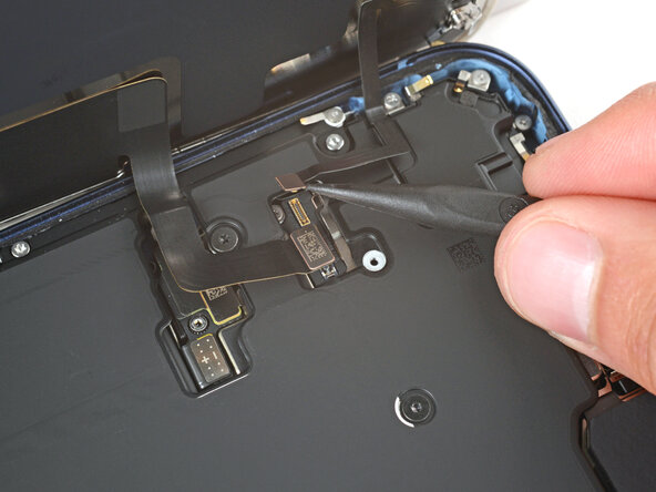

  27. iPhone 17 Pro Max Screen Replacement, Pry up the sensors: crwdns2935265:027crwdnd2935265:01crwdnd2935265:03crwdne2935265:0 iPhone 17 Pro Max Screen Replacement, Pry up the sensors: crwdns2935265:027crwdnd2935265:02crwdnd2935265:03crwdne2935265:0 iPhone 17 Pro Max Screen Replacement, Pry up the sensors: crwdns2935265:027crwdnd2935265:03crwdnd2935265:03crwdne2935265:0
    • The front sensors are very fragile and can easily rip—be very gentle while removing them. If you're having trouble, apply more heat and try again.
    • Use the point of a spudger to pry up both front sensors.
    • Pry on the tab under the sensors—not the sensors themselves—or you may damage them.

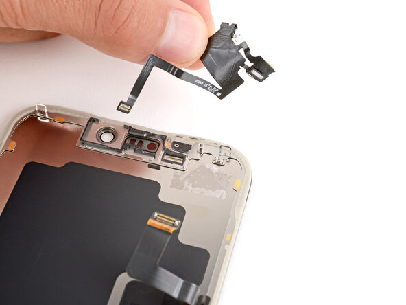

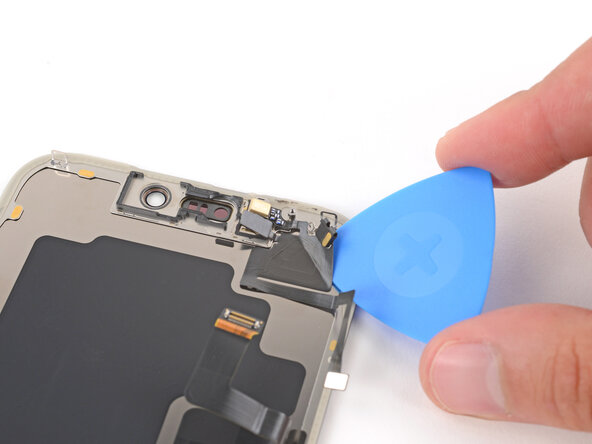

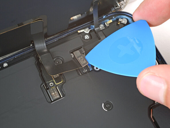

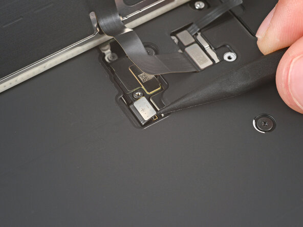

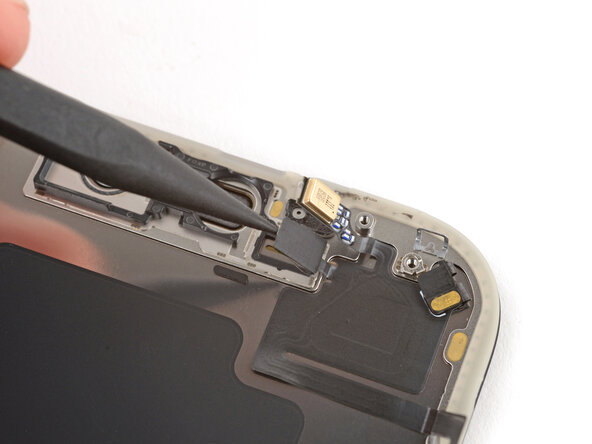

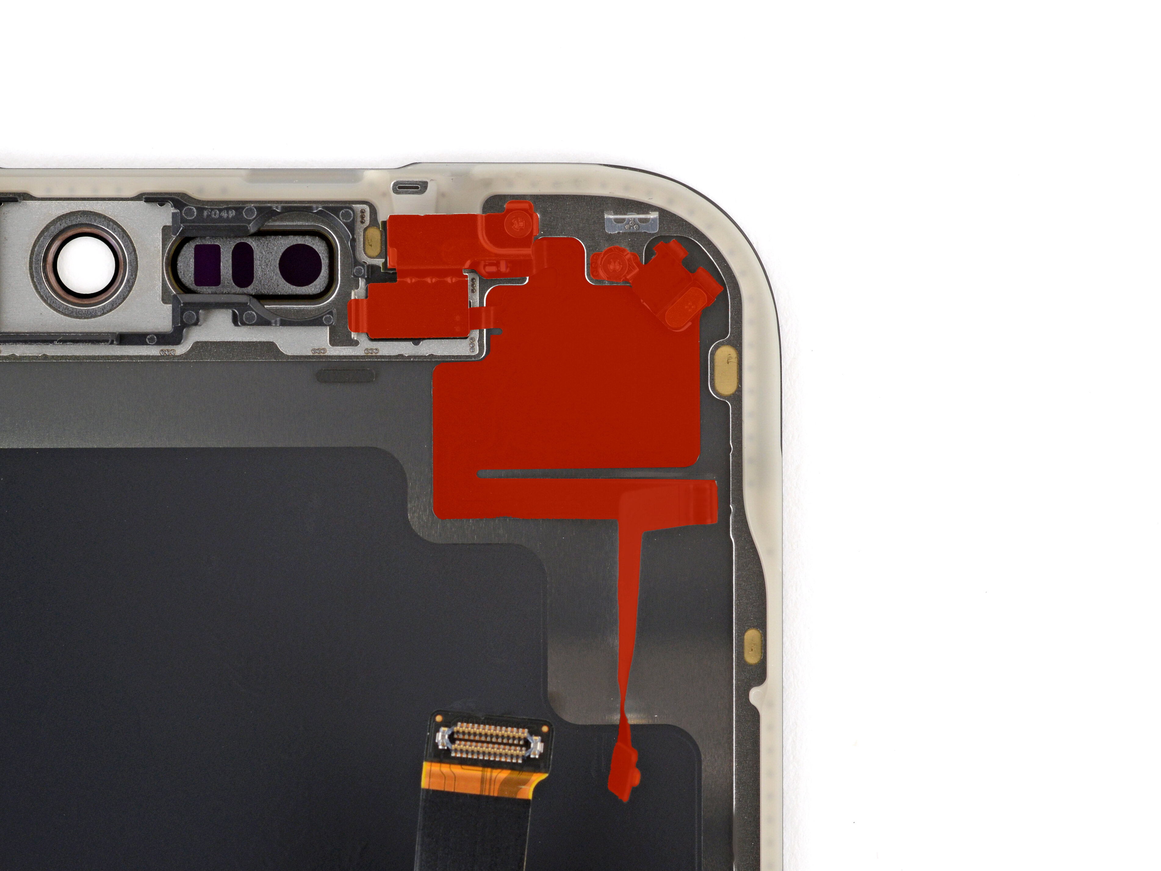

  28. iPhone 17 Pro Max Screen Replacement, Remove the sensors: crwdns2935265:028crwdnd2935265:01crwdnd2935265:03crwdne2935265:0 iPhone 17 Pro Max Screen Replacement, Remove the sensors: crwdns2935265:028crwdnd2935265:02crwdnd2935265:03crwdne2935265:0 iPhone 17 Pro Max Screen Replacement, Remove the sensors: crwdns2935265:028crwdnd2935265:03crwdnd2935265:03crwdne2935265:0
    • Insert the tip of an opening pick under the top right corner of the front sensors large, glued down cable.
    • Slowly slide the pick under the cable and lift until you can grip it with your fingers.
    • Use your fingers to peel up the cable and remove the sensors.
    • You can now transfer the sensors to your replacement screen.
