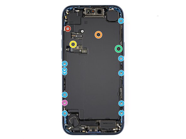

  24. iPhone 17 Pro Max Battery Replacement, Remove the battery screws: crwdns2935265:024crwdnd2935265:01crwdnd2935265:02crwdne2935265:0 iPhone 17 Pro Max Battery Replacement, Remove the battery screws: crwdns2935265:024crwdnd2935265:02crwdnd2935265:02crwdne2935265:0
    • Use a Torx Plus 4IP screwdriver to remove the 15 screws securing the battery tray:
    • One 7.5 mm‑long screw
    • One 5.9 mm‑long screw
    • One 3.5 mm‑long screw
    • One 2.4 mm‑long screw
    • Ten 3.7 mm‑long screws
    • One 3.7 mm‑long screw
    • iPhone models with a physical SIM card won't have this screw.

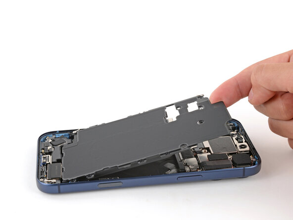

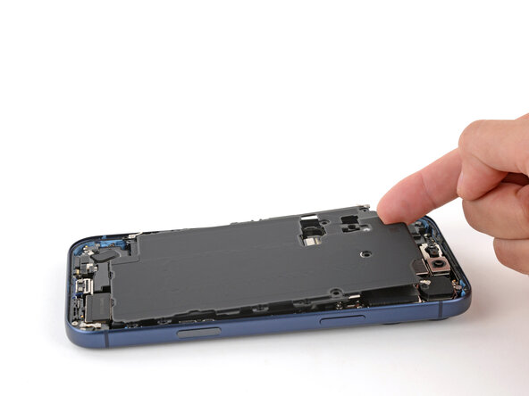

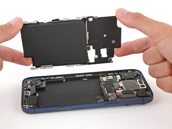

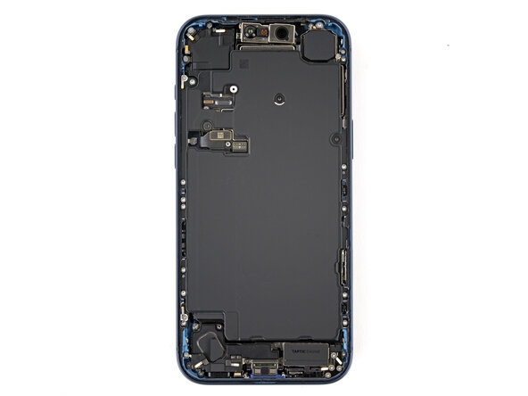

  25. iPhone 17 Pro Max Battery Replacement, Remove the battery: crwdns2935265:025crwdnd2935265:01crwdnd2935265:03crwdne2935265:0 iPhone 17 Pro Max Battery Replacement, Remove the battery: crwdns2935265:025crwdnd2935265:02crwdnd2935265:03crwdne2935265:0 iPhone 17 Pro Max Battery Replacement, Remove the battery: crwdns2935265:025crwdnd2935265:03crwdnd2935265:03crwdne2935265:0
    • Use your finger to lift the top left corner of the battery tray and remove it.
    • Be careful not to smudge the front camera.
After your repair, run Apple's Repair Assistant. Navigate to Settings General About Parts & Service History, tap Restart & Finish Repair, and follow the onscreen prompts.
Calibrate your newly installed battery after completing this guide.
