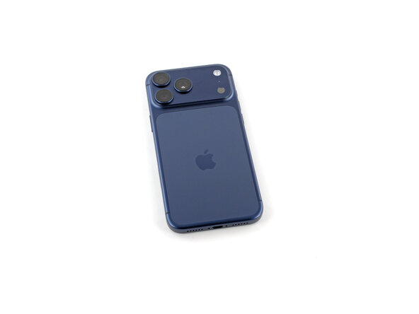

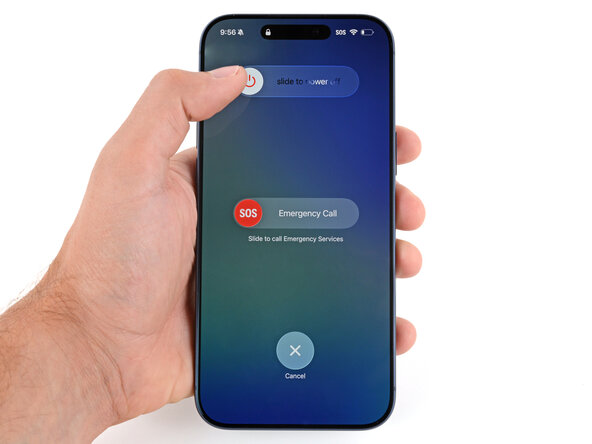

  1. iPhone 17 Pro Back Glass Replacement, Safety precautions: crwdns2935265:01crwdnd2935265:01crwdnd2935265:02crwdne2935265:0 iPhone 17 Pro Back Glass Replacement, Safety precautions: crwdns2935265:01crwdnd2935265:02crwdnd2935265:02crwdne2935265:0

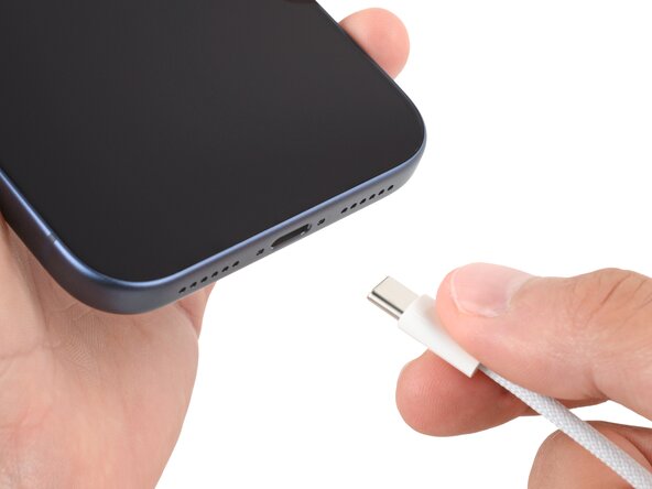

    • Let your iPhone's battery drain below 25% before starting this repair—a charged lithium‑ion battery may catch fire if damaged.
    • Unplug all cables from your phone.
    • Hold the power and either volume button and slide to power off your phone.

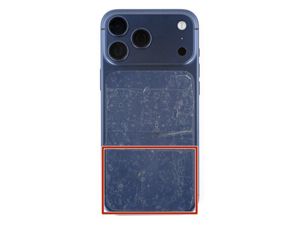

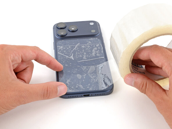

  2. iPhone 17 Pro Back Glass Replacement, Cracked glass preparation: crwdns2935265:02crwdnd2935265:01crwdnd2935265:03crwdne2935265:0 iPhone 17 Pro Back Glass Replacement, Cracked glass preparation: crwdns2935265:02crwdnd2935265:02crwdnd2935265:03crwdne2935265:0 iPhone 17 Pro Back Glass Replacement, Cracked glass preparation: crwdns2935265:02crwdnd2935265:03crwdnd2935265:03crwdne2935265:0
    iFixit Safety Glasses
    $7.99
    • Glass shards can complicate disassembly—or worse, cause injury. If your phone is cracked, follow this step.
    • Apply strips of packing tape to the cracked glass until it's completely covered—this will help keep the glass contained and allow the suction cup to stick.
    • Make sure there's a single strip of tape (not overlapping) across the bottom edge, big enough for a suction cup to fit on.
    • Only cover the glass itself—don't stick any tape to the frame.
    • Consider wearing safety glasses to protect your eyes from any glass shaken free during the repair.

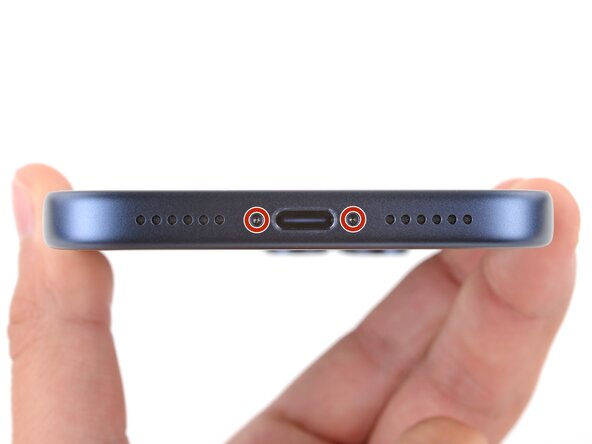

  3. iPhone 17 Pro Back Glass Replacement, Remove the pentalobe screws: crwdns2935265:03crwdnd2935265:01crwdnd2935265:02crwdne2935265:0 iPhone 17 Pro Back Glass Replacement, Remove the pentalobe screws: crwdns2935265:03crwdnd2935265:02crwdnd2935265:02crwdne2935265:0

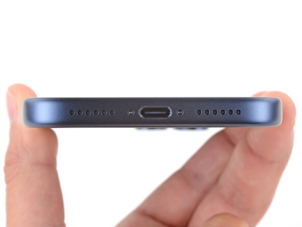

    • Use a P2 pentalobe screwdriver to remove the two 7.5 mm‑long screws on either side of the charging port.

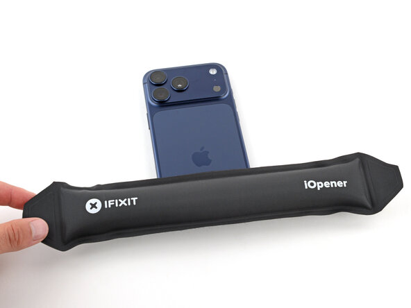

  4. iPhone 17 Pro Back Glass Replacement, Heat the bottom edge: crwdns2935265:04crwdnd2935265:01crwdnd2935265:02crwdne2935265:0 iPhone 17 Pro Back Glass Replacement, Heat the bottom edge: crwdns2935265:04crwdnd2935265:02crwdnd2935265:02crwdne2935265:0
    • Adhesive secures the back glass to the frame. Heating the glass softens the adhesive, making it easier to separate.
    • Heat an iOpener and lay it on the bottom edge of the back glass for two minutes.
    • Alternatively, you can use a hair dryer or heat gun to heat the back glass.
    • Improper use of a heat gun can destroy the wireless charging assembly and/or battery—follow the linked instructions carefully.

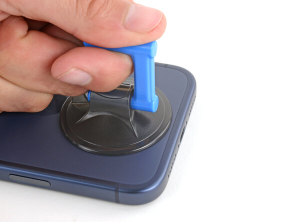

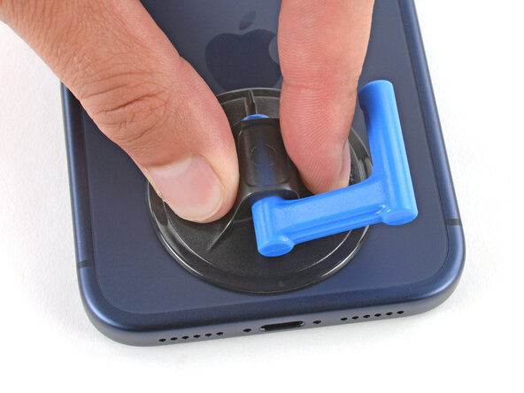

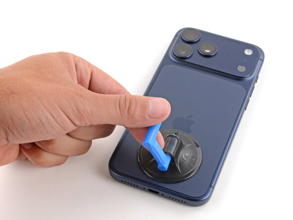

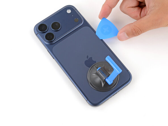

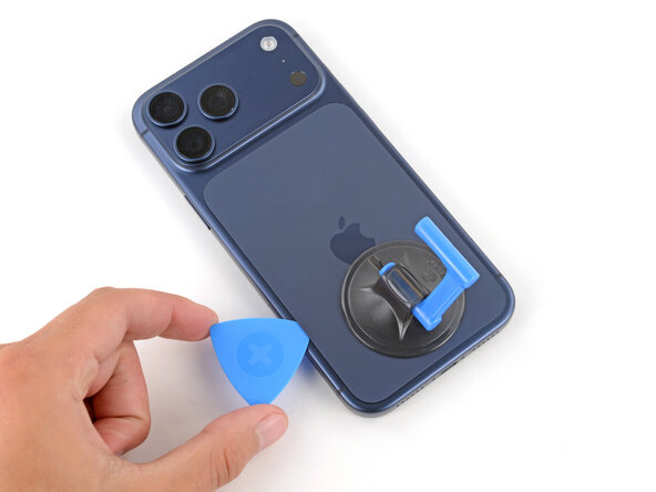

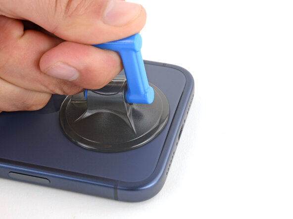

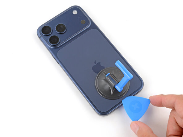

  5. iPhone 17 Pro Back Glass Replacement, Apply a suction handle: crwdns2935265:05crwdnd2935265:01crwdnd2935265:02crwdne2935265:0 iPhone 17 Pro Back Glass Replacement, Apply a suction handle: crwdns2935265:05crwdnd2935265:02crwdnd2935265:02crwdne2935265:0
    • Apply a suction handle to the bottom edge of the back glass, as close to the edge as possible.

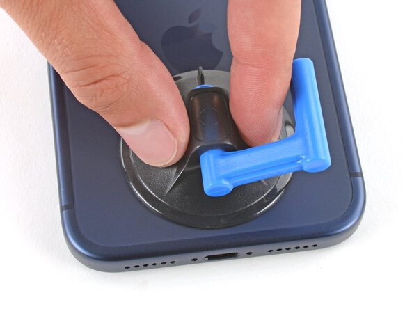

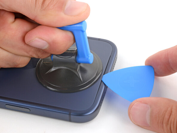

  6. iPhone 17 Pro Back Glass Replacement, Insert an opening pick: crwdns2935265:06crwdnd2935265:01crwdnd2935265:03crwdne2935265:0 iPhone 17 Pro Back Glass Replacement, Insert an opening pick: crwdns2935265:06crwdnd2935265:02crwdnd2935265:03crwdne2935265:0 iPhone 17 Pro Back Glass Replacement, Insert an opening pick: crwdns2935265:06crwdnd2935265:03crwdnd2935265:03crwdne2935265:0
    • Pull up on the suction handle with strong, steady force until a gap forms between the back glass and frame.
    • If you're having trouble, apply more heat and try again.
    • Insert the tip of an opening pick into the gap you just created.

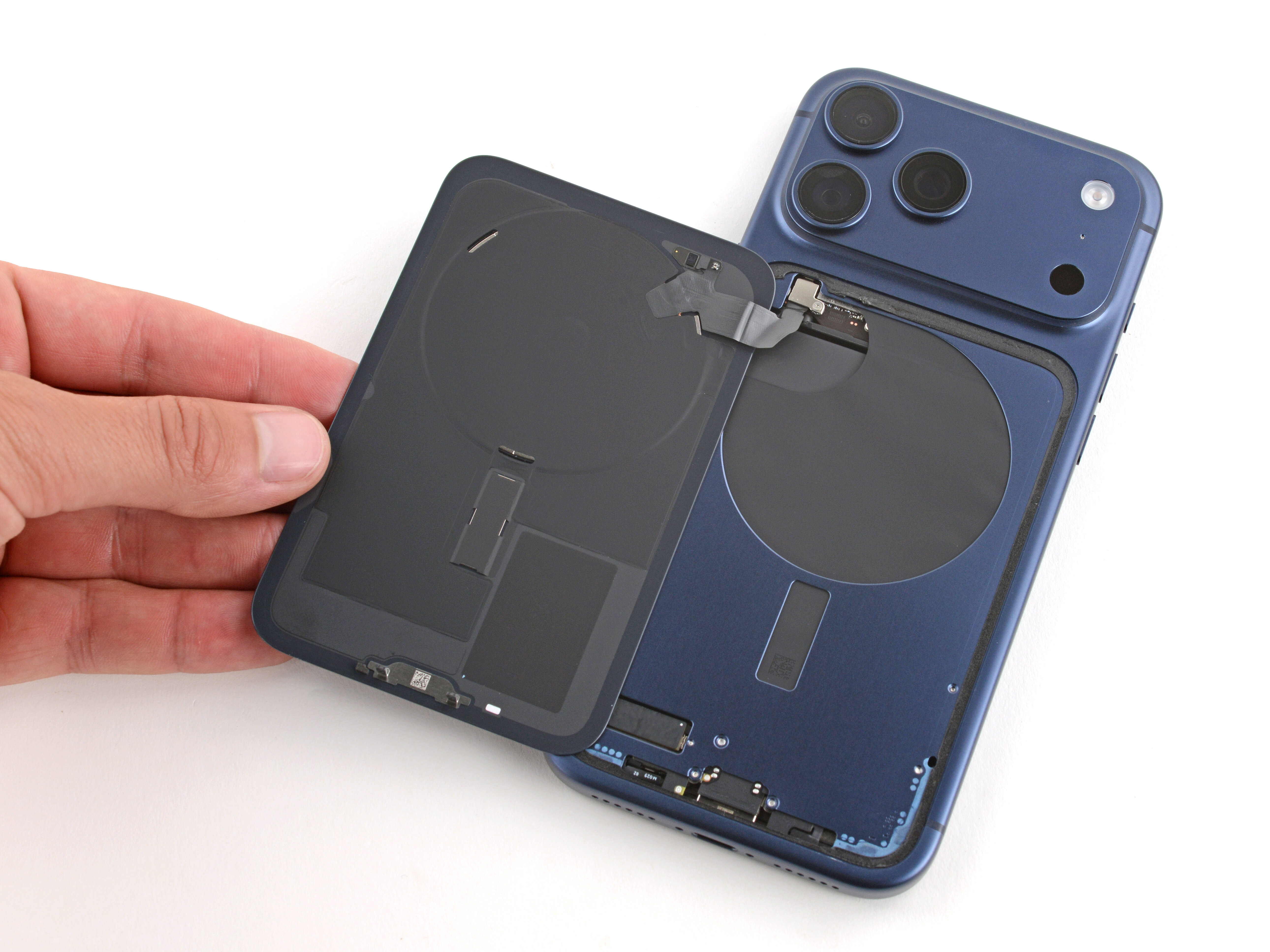

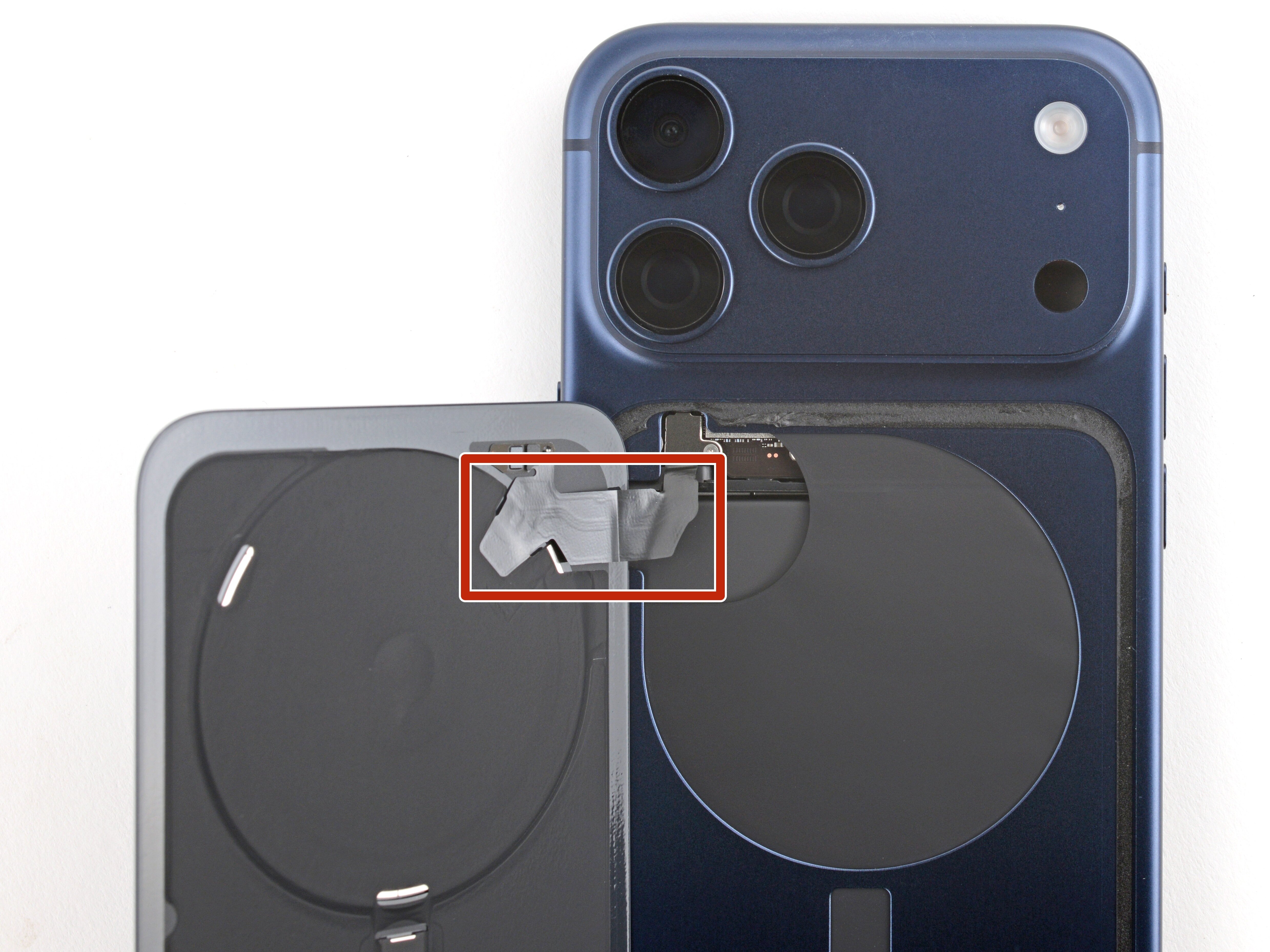

  7. iPhone 17 Pro Back Glass Replacement, Separate the adhesive: crwdns2935265:07crwdnd2935265:01crwdnd2935265:03crwdne2935265:0 iPhone 17 Pro Back Glass Replacement, Separate the adhesive: crwdns2935265:07crwdnd2935265:02crwdnd2935265:03crwdne2935265:0 iPhone 17 Pro Back Glass Replacement, Separate the adhesive: crwdns2935265:07crwdnd2935265:03crwdnd2935265:03crwdne2935265:0
    • Slide the opening pick around the perimeter of the back glass to separate all the adhesive securing it.
    • Only insert your pick slightly under the back glass near the top of the left edge. Otherwise, you may damage the wireless charging ribbon cable.

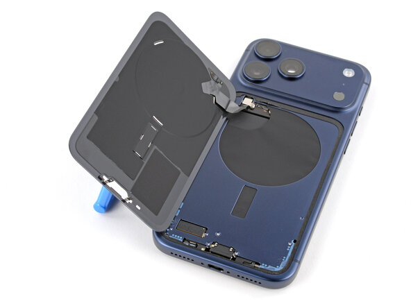

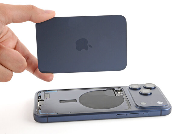

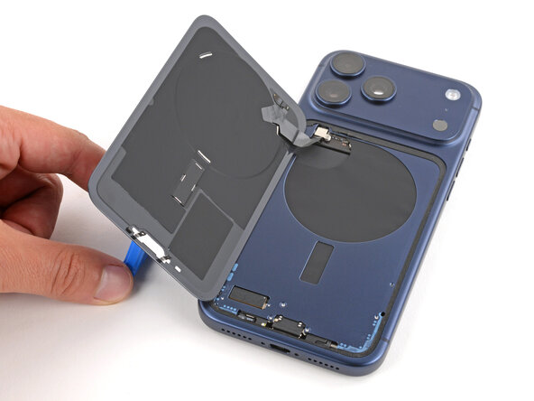

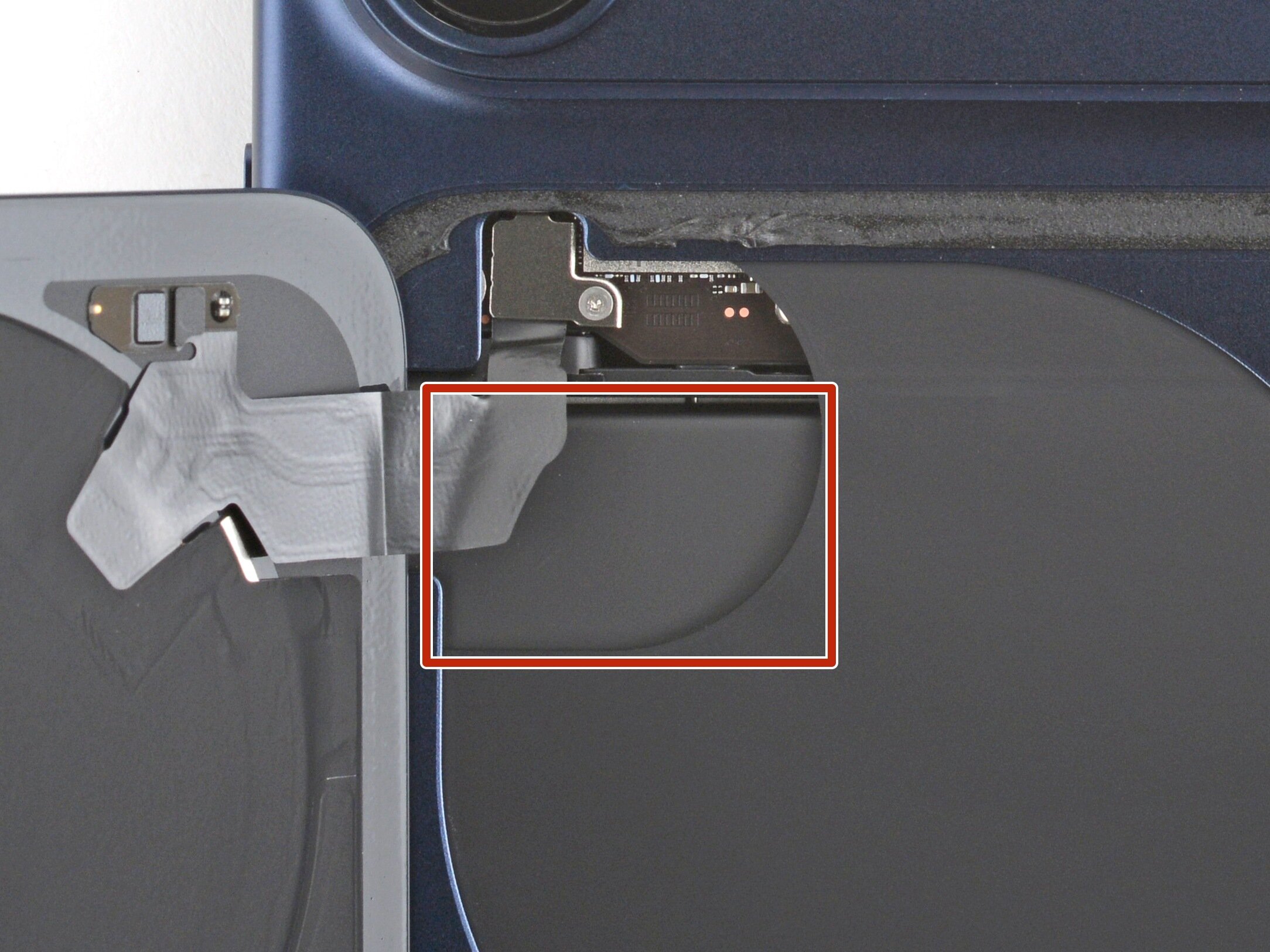

  8. iPhone 17 Pro Back Glass Replacement, Prop up the back glass: crwdns2935265:08crwdnd2935265:01crwdnd2935265:03crwdne2935265:0 iPhone 17 Pro Back Glass Replacement, Prop up the back glass: crwdns2935265:08crwdnd2935265:02crwdnd2935265:03crwdne2935265:0 iPhone 17 Pro Back Glass Replacement, Prop up the back glass: crwdns2935265:08crwdnd2935265:03crwdnd2935265:03crwdne2935265:0
    • At this point, the back glass should be completely separated from the frame. If it feels stuck, go back around the perimeter and separate any remaining adhesive.
    • Flip the back glass over the left edge and use the suction handle to prop it up.
    • Alternatively, you can lay the glass down flat over the left side.

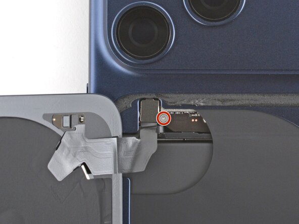

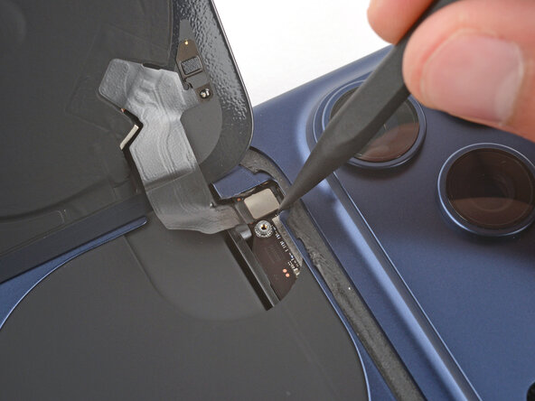

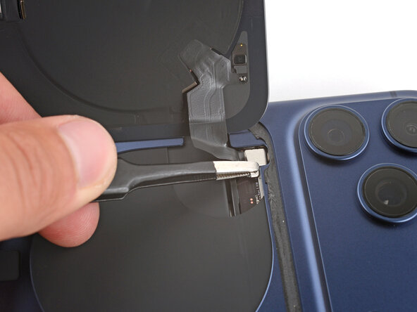

  9. iPhone 17 Pro Back Glass Replacement, Remove the cover screw: crwdns2935265:09crwdnd2935265:01crwdnd2935265:02crwdne2935265:0 iPhone 17 Pro Back Glass Replacement, Remove the cover screw: crwdns2935265:09crwdnd2935265:02crwdnd2935265:02crwdne2935265:0
    • Be careful not to damage the exposed battery with your tools during the next few steps.
    • Use a tri‑point Y000 screwdriver to remove the 1.0 mm‑long screw securing the wireless charging connector cover.

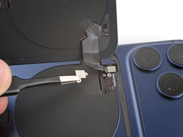

  10. iPhone 17 Pro Back Glass Replacement, Remove the cover: crwdns2935265:010crwdnd2935265:01crwdnd2935265:02crwdne2935265:0 iPhone 17 Pro Back Glass Replacement, Remove the cover: crwdns2935265:010crwdnd2935265:02crwdnd2935265:02crwdne2935265:0
    • Remove the cover.
    • During reassembly, make sure to hook the small tab on the cover under the frame.

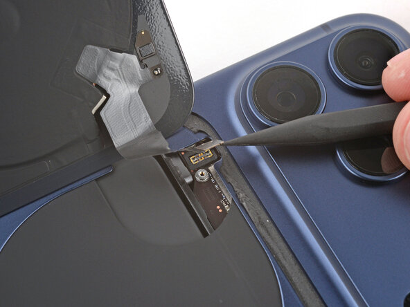

  11. iPhone 17 Pro Back Glass Replacement, Disconnect the back glass: crwdns2935265:011crwdnd2935265:01crwdnd2935265:02crwdne2935265:0 iPhone 17 Pro Back Glass Replacement, Disconnect the back glass: crwdns2935265:011crwdnd2935265:02crwdnd2935265:02crwdne2935265:0
    • Use the point of a spudger to pry up and disconnect the wireless charging press connector.

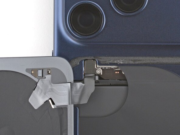

  12. iPhone 17 Pro Back Glass Replacement, Remove the back glass: crwdns2935265:012crwdnd2935265:01crwdnd2935265:01crwdne2935265:0
    • Remove the back glass.
