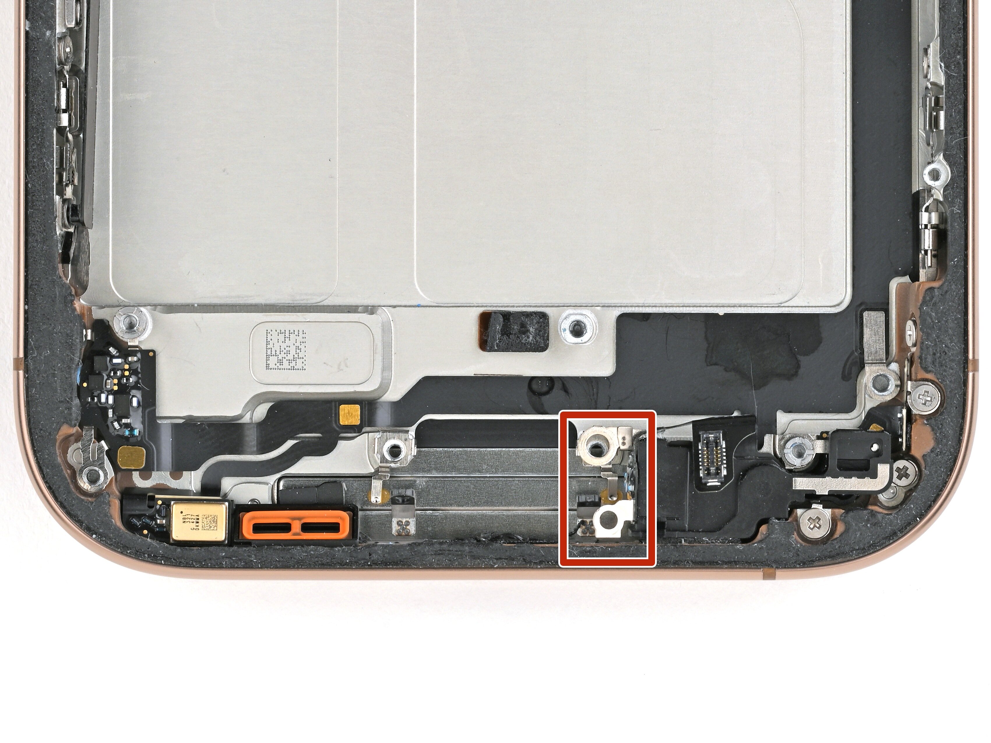

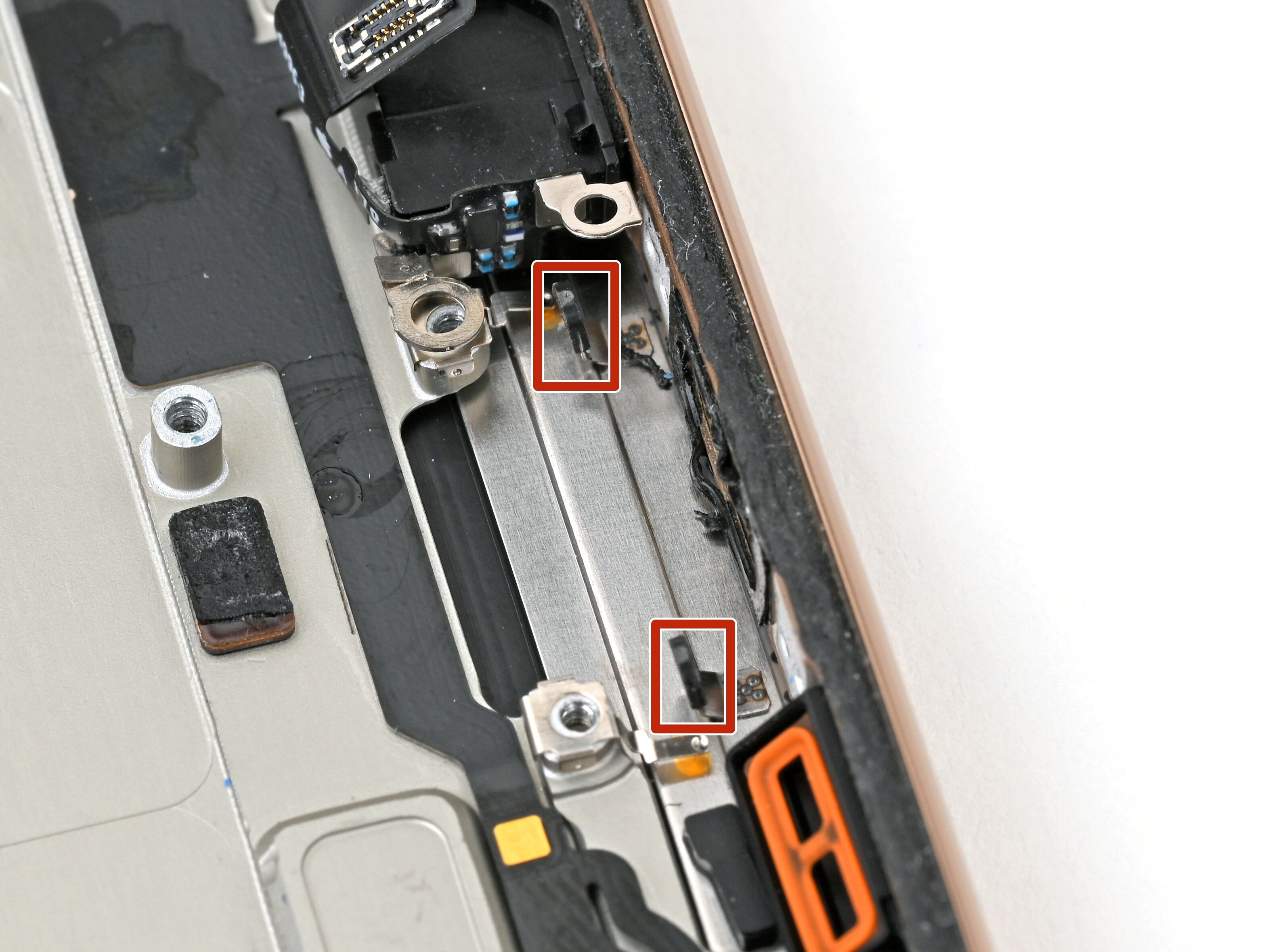

  8. iPhone 16 Pro Charging Port Replacement, Separate the bottom edge adhesive: crwdns2935265:08crwdnd2935265:01crwdnd2935265:03crwdne2935265:0 iPhone 16 Pro Charging Port Replacement, Separate the bottom edge adhesive: crwdns2935265:08crwdnd2935265:02crwdnd2935265:03crwdne2935265:0 iPhone 16 Pro Charging Port Replacement, Separate the bottom edge adhesive: crwdns2935265:08crwdnd2935265:03crwdnd2935265:03crwdne2935265:0
    • Don't insert your pick deeper than 5 mm on the bottom edge to avoid damaging the spring contact.
    • Slide your pick back and forth along the bottom edge to separate the adhesive.
    • Leave your pick inserted in the bottom right corner to prevent the adhesive from resealing.

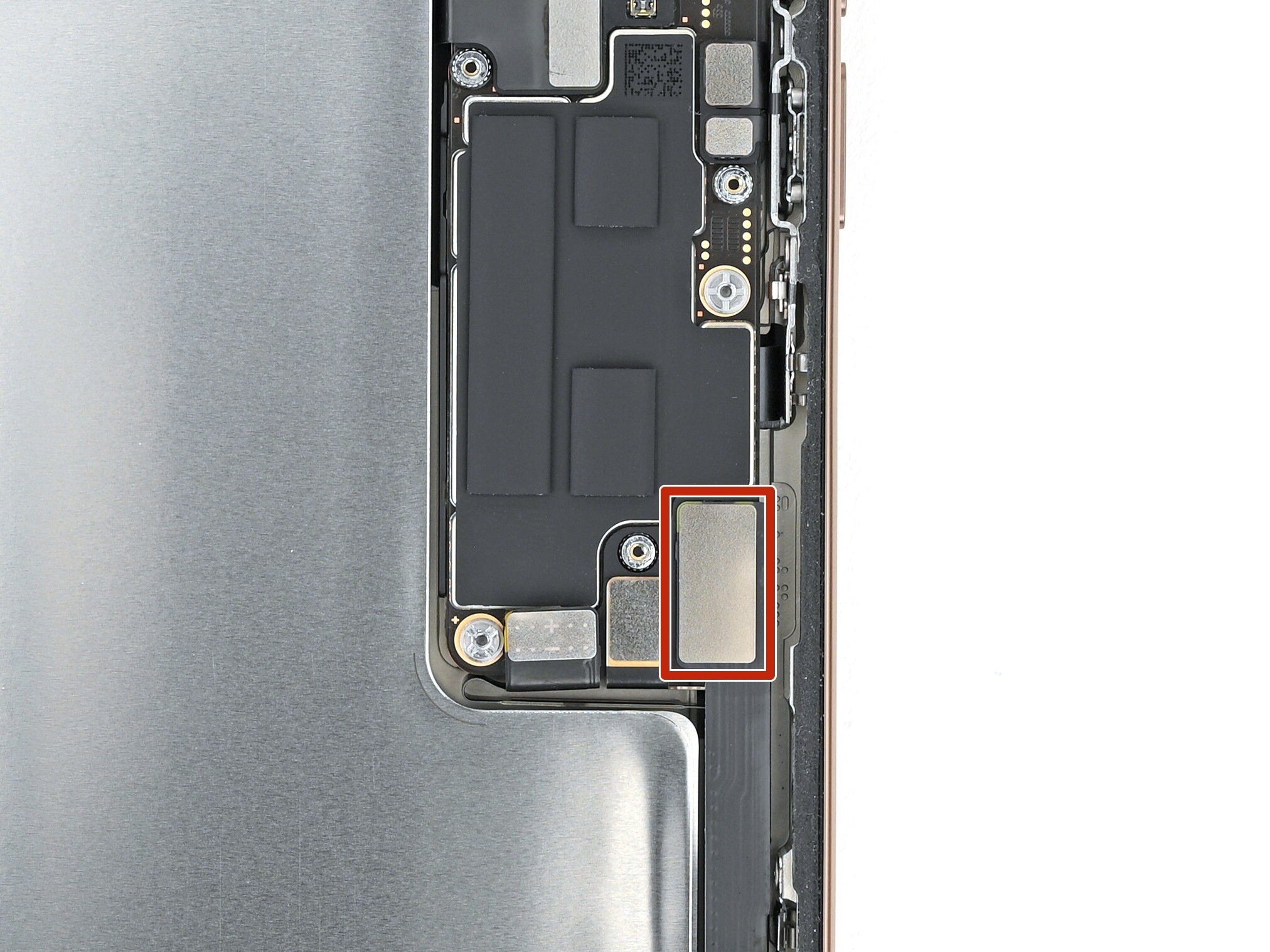

  33. iPhone 16 Pro Charging Port Replacement, Remove the loudspeaker: crwdns2935265:033crwdnd2935265:01crwdnd2935265:02crwdne2935265:0 iPhone 16 Pro Charging Port Replacement, Remove the loudspeaker: crwdns2935265:033crwdnd2935265:02crwdnd2935265:02crwdne2935265:0
    • Remove the four screws securing the loudspeaker:
    • Two 1.6 mm‑long Phillips screws
    • One 2.0 mm‑long Phillips screw
    • One 1.3 mm‑long tri-point Y000 screw
  34. iPhone 16 Pro Charging Port Replacement: crwdns2935265:034crwdnd2935265:01crwdnd2935265:03crwdne2935265:0 iPhone 16 Pro Charging Port Replacement: crwdns2935265:034crwdnd2935265:02crwdnd2935265:03crwdne2935265:0 iPhone 16 Pro Charging Port Replacement: crwdns2935265:034crwdnd2935265:03crwdnd2935265:03crwdne2935265:0
    • Insert the point of a spudger underneath the loudspeaker's bottom-right screw hole.
    • Pry up and remove the loudspeaker.

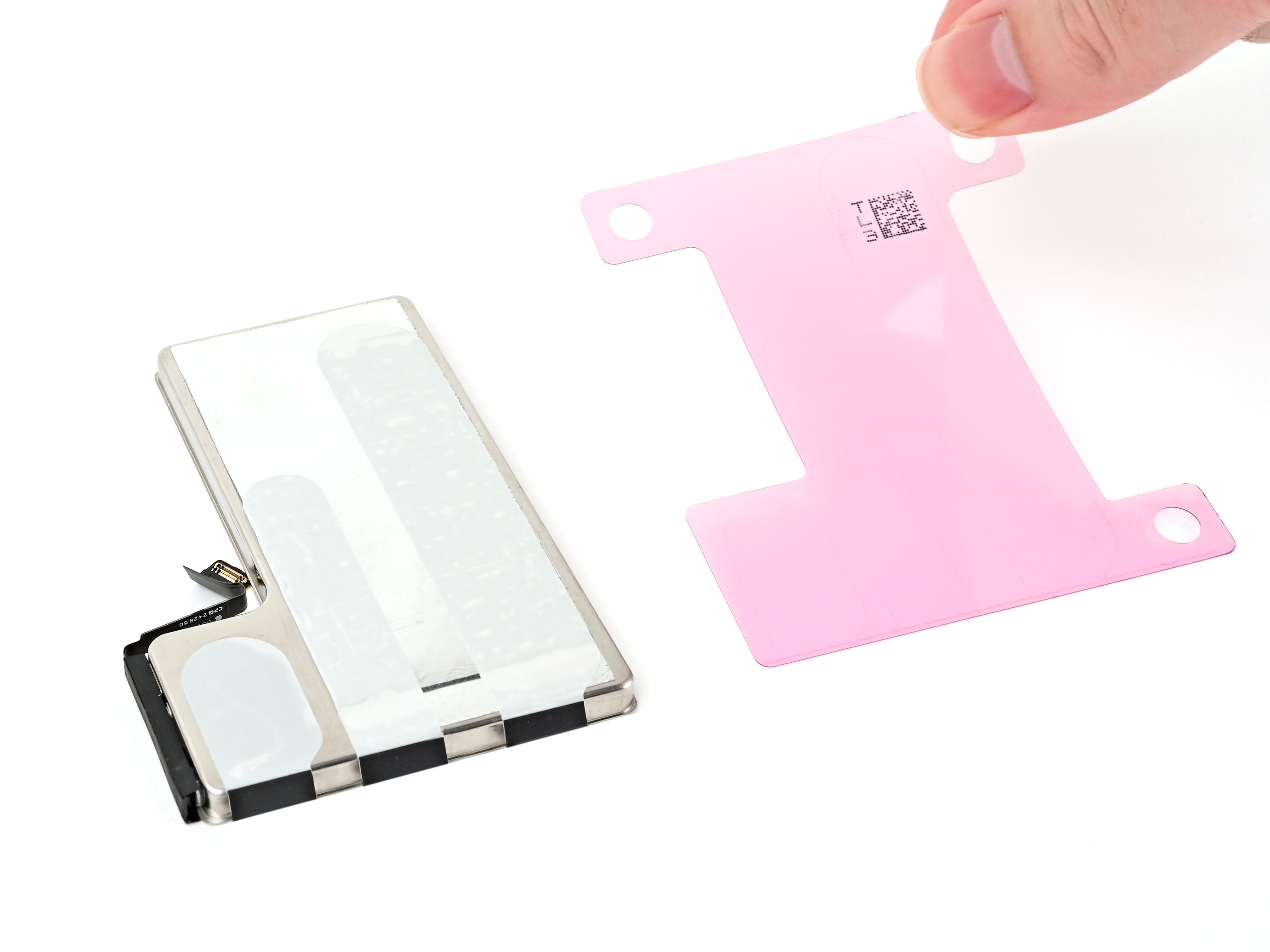

  35. iPhone 16 Pro Charging Port Replacement, Battery adhesive information: crwdns2935265:035crwdnd2935265:01crwdnd2935265:01crwdne2935265:0
    • The battery is secured with three stretch release adhesive strips. The next four steps show how to remove them and free the battery.
    • Be careful not to dent or puncture the battery. Even with its metal enclosure, the battery can catch fire if damaged.

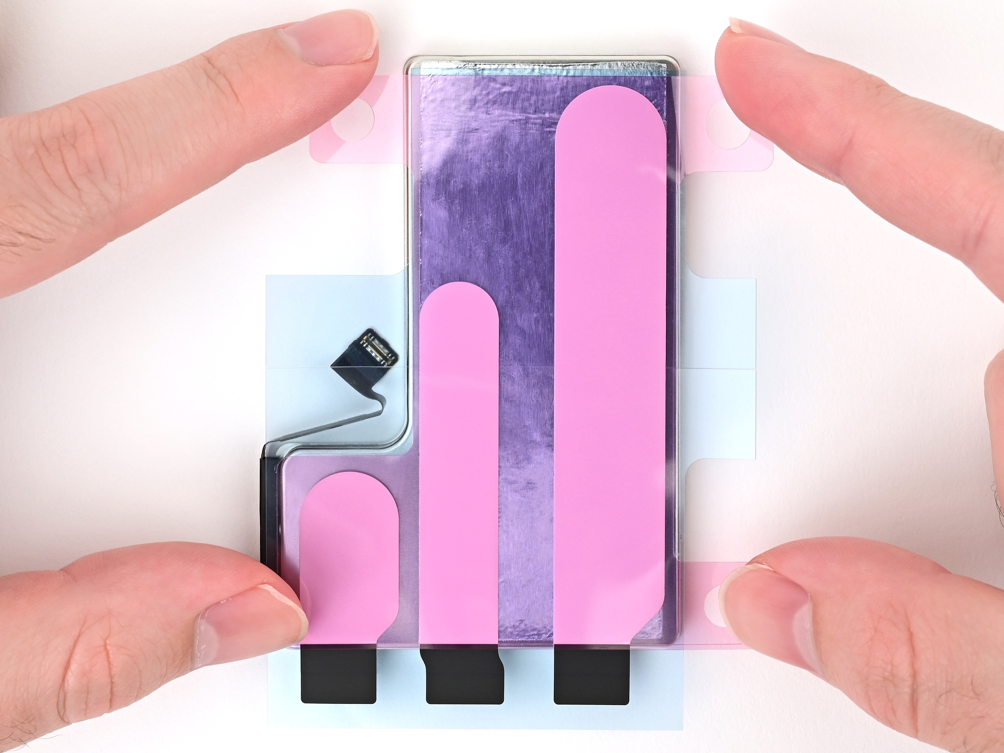

  36. iPhone 16 Pro Charging Port Replacement, Remove the battery: crwdns2935265:036crwdnd2935265:01crwdnd2935265:02crwdne2935265:0 iPhone 16 Pro Charging Port Replacement, Remove the battery: crwdns2935265:036crwdnd2935265:02crwdnd2935265:02crwdne2935265:0
    • Insert the tip of angled tweezers under one of the black pull tabs.
  37. iPhone 16 Pro Charging Port Replacement: crwdns2935265:037crwdnd2935265:01crwdnd2935265:03crwdne2935265:0 iPhone 16 Pro Charging Port Replacement: crwdns2935265:037crwdnd2935265:02crwdnd2935265:03crwdne2935265:0 iPhone 16 Pro Charging Port Replacement: crwdns2935265:037crwdnd2935265:03crwdnd2935265:03crwdne2935265:0
    • Use your tweezers to slice through the black tab and peel the tab off the top of the battery.
    • Don't try to pull the tab out from under the battery just yet.
  38. iPhone 16 Pro Charging Port Replacement: crwdns2935265:038crwdnd2935265:01crwdnd2935265:03crwdne2935265:0 iPhone 16 Pro Charging Port Replacement: crwdns2935265:038crwdnd2935265:02crwdnd2935265:03crwdne2935265:0 iPhone 16 Pro Charging Port Replacement: crwdns2935265:038crwdnd2935265:03crwdnd2935265:03crwdne2935265:0
    • Use tweezers or your fingers to grab the pull tab and pull it down so it's flat against the frame.
    • Slowly pull the adhesive out from under the battery at as low of an angle as possible.
    • Give the strip plenty of time to stretch and re-grip it as necessary. When the strip becomes too long, wrap it around your tweezers and continue pulling.
    • If the strip breaks off, try to retrieve it from under the battery. If you can't retrieve it, move onto the next strip.
  39. iPhone 16 Pro Charging Port Replacement: crwdns2935265:039crwdnd2935265:01crwdnd2935265:02crwdne2935265:0 iPhone 16 Pro Charging Port Replacement: crwdns2935265:039crwdnd2935265:02crwdnd2935265:02crwdne2935265:0
    • Repeat the procedure with the two remaining adhesive strips.

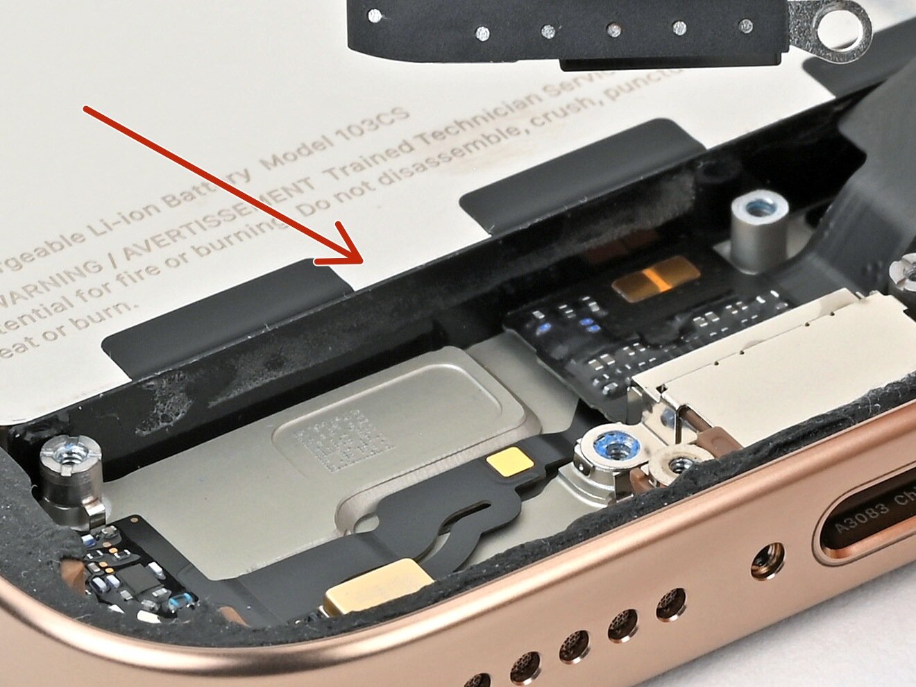

  41. iPhone 16 Pro Charging Port Replacement, Alternate method to remove the battery: crwdns2935265:041crwdnd2935265:01crwdnd2935265:01crwdne2935265:0
    • The next two steps show how to remove the battery if the adhesive strips broke.
    • Lift the bottom edge of the frame to tilt the phone.
    • Use a pipette or a syringe to apply 2–3 drops of high concentration (>90%) isopropyl alcohol along the bottom edge of the battery, close to where each broken adhesive strip came out.
    • Wait one minute for the isopropyl alcohol to flow under the battery and soften the adhesive.
  42. iPhone 16 Pro Charging Port Replacement: crwdns2935265:042crwdnd2935265:01crwdnd2935265:03crwdne2935265:0 iPhone 16 Pro Charging Port Replacement: crwdns2935265:042crwdnd2935265:02crwdnd2935265:03crwdne2935265:0 iPhone 16 Pro Charging Port Replacement: crwdns2935265:042crwdnd2935265:03crwdnd2935265:03crwdne2935265:0
    • Insert the tip of an opening pick between the bottom of the battery and the frame.
    • Insert a second opening pick between the left edge of the battery and the frame. Use this pick to pry the battery upwards slowly with steady force. Work your way up the edge of the battery, giving the adhesive time to release.
    • Don't bend or crease the battery. If it feels stubborn, apply a few more drops of isopropyl alcohol and try again.
    • Once the adhesive loosens, grab and remove the battery.
  43. iPhone 16 Pro Charging Port Replacement, Remove the charging port: crwdns2935265:043crwdnd2935265:01crwdnd2935265:01crwdne2935265:0
    • Use a standoff screwdriver to remove the 3.6 mm‑long screw securing the charging port to the frame.
  44. iPhone 16 Pro Charging Port Replacement: crwdns2935265:044crwdnd2935265:01crwdnd2935265:03crwdne2935265:0 iPhone 16 Pro Charging Port Replacement: crwdns2935265:044crwdnd2935265:02crwdnd2935265:03crwdne2935265:0 iPhone 16 Pro Charging Port Replacement: crwdns2935265:044crwdnd2935265:03crwdnd2935265:03crwdne2935265:0
    • Use a Phillips screwdriver to remove the two 3.4 mm‑long screws securing the charging port to the frame.
    • These screws are tight and can be difficult to reach. Angle your screwdriver at as shallow of an angle as you can.
  45. iPhone 16 Pro Charging Port Replacement: crwdns2935265:045crwdnd2935265:01crwdnd2935265:01crwdne2935265:0
    • Use a tri-point Y000 screwdriver to remove the 1.3 mm‑long screw securing the charging port to the frame.
  46. iPhone 16 Pro Charging Port Replacement: crwdns2935265:046crwdnd2935265:01crwdnd2935265:02crwdne2935265:0 iPhone 16 Pro Charging Port Replacement: crwdns2935265:046crwdnd2935265:02crwdnd2935265:02crwdne2935265:0
    • The charging port has an adhesive gasket that seals it against the bottom and edge of the frame. It's also tucked behind two prongs, which prevents you from pulling the port away from the frame.
    • Insert the point of a spudger under one side of the charging port.
    • Pry up gently to separate the gasket and lift the port up.
  47. iPhone 16 Pro Charging Port Replacement: crwdns2935265:047crwdnd2935265:01crwdnd2935265:03crwdne2935265:0 iPhone 16 Pro Charging Port Replacement: crwdns2935265:047crwdnd2935265:02crwdnd2935265:03crwdne2935265:0 iPhone 16 Pro Charging Port Replacement: crwdns2935265:047crwdnd2935265:03crwdnd2935265:03crwdne2935265:0
    • Don't pull the port directly away from its cut-out in the frame. There are two prongs holding it in place.
    • Pull the charging port away from the microphone.
    • Remove the charging port.
  48. iPhone 16 Pro Charging Port Replacement, Disassembly complete: crwdns2935265:048crwdnd2935265:01crwdnd2935265:01crwdne2935265:0
    • Congratulations on completing disassembly! The remaining steps will show how to reassemble your iPhone. Some of the reassembly photos show the Pro Max model, but the procedure is correct for the Pro.
  49. iPhone 16 Pro Charging Port Replacement, Reassembly tips: crwdns2935265:049crwdnd2935265:01crwdnd2935265:03crwdne2935265:0 iPhone 16 Pro Charging Port Replacement, Reassembly tips: crwdns2935265:049crwdnd2935265:02crwdnd2935265:03crwdne2935265:0 iPhone 16 Pro Charging Port Replacement, Reassembly tips: crwdns2935265:049crwdnd2935265:03crwdnd2935265:03crwdne2935265:0
    • Grounding clips clip on top of both screw posts under the charging port. Make sure they're still clipped in place. The clips should face towards the bottom edge of the iPhone.
    • Make sure the two black prongs on either side of the charging port are standing straight up. If they were bent when you removed the port, use the point of a spudger to carefully straighten them.
    • If you have replacement adhesive, use tweezers to remove all of the original adhesive securing the port to the frame before installing it.
    • If you don't have new adhesive, you can leave the old adhesive in place, but the phone will no longer be water-resistant.

  57. iPhone 16 Pro Charging Port Replacement, Install new adhesive: crwdns2935265:057crwdnd2935265:01crwdnd2935265:03crwdne2935265:0 iPhone 16 Pro Charging Port Replacement, Install new adhesive: crwdns2935265:057crwdnd2935265:02crwdnd2935265:03crwdne2935265:0 iPhone 16 Pro Charging Port Replacement, Install new adhesive: crwdns2935265:057crwdnd2935265:03crwdnd2935265:03crwdne2935265:0
    Stretch Release Battery Adhesive
    $3.99
    • The next four steps show how to apply custom-cut adhesive to the battery. If your battery comes with adhesive pre-installed, skip the next four steps.
    • If needed, follow this guide to apply generic stretch release adhesive strips instead. Ensure the position of these strips lines up with the adhesive wells in the phone's frame. Use this photo as a reference.
    • Align the new adhesive with your battery to see how it needs to be applied. Set all strips fully on the battery, and align the top edges of the black pull tabs with the bottom edge of the battery.
    • Your adhesive may look slightly different or have different liners.
    • If the battery‑side of your adhesive has two liners, remove the top liner.
    • If the battery‑side of your adhesive has one liner, remove it.
  58. iPhone 16 Pro Charging Port Replacement: crwdns2935265:058crwdnd2935265:01crwdnd2935265:02crwdne2935265:0 iPhone 16 Pro Charging Port Replacement: crwdns2935265:058crwdnd2935265:02crwdnd2935265:02crwdne2935265:0
    • Lay the adhesive onto the battery and press each strip firmly into place.
  59. iPhone 16 Pro Charging Port Replacement: crwdns2935265:059crwdnd2935265:01crwdnd2935265:03crwdne2935265:0 iPhone 16 Pro Charging Port Replacement: crwdns2935265:059crwdnd2935265:02crwdnd2935265:03crwdne2935265:0 iPhone 16 Pro Charging Port Replacement: crwdns2935265:059crwdnd2935265:03crwdnd2935265:03crwdne2935265:0
    • If the battery‑side of your adhesive still has a bottom liner on it, remove it now, and press each strip firmly into place.
  60. iPhone 16 Pro Charging Port Replacement: crwdns2935265:060crwdnd2935265:01crwdnd2935265:01crwdne2935265:0
    • Use your finger to fold each black pull tab around the bottom edge of the battery and press it into place.

  67. iPhone 16 Pro Charging Port Replacement, Install the Taptic Engine: crwdns2935265:067crwdnd2935265:01crwdnd2935265:02crwdne2935265:0 iPhone 16 Pro Charging Port Replacement, Install the Taptic Engine: crwdns2935265:067crwdnd2935265:02crwdnd2935265:02crwdne2935265:0
    • Use blunt-nose tweezers or your fingers to align the Taptic Engine with its screw posts and place it in the frame.
  68. iPhone 16 Pro Charging Port Replacement: crwdns2935265:068crwdnd2935265:01crwdnd2935265:02crwdne2935265:0 iPhone 16 Pro Charging Port Replacement: crwdns2935265:068crwdnd2935265:02crwdnd2935265:02crwdne2935265:0
    • Use a Phillips screwdriver to install the 1.9 mm‑long screw securing the Taptic Engine, located on its right edge.
