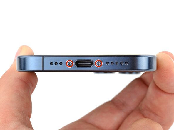

    1. iPhone 15 Pro Max Back Glass Replacement, Remove the pentalobe screws: crwdns2935265:04crwdnd2935265:01crwdnd2935265:01crwdne2935265:0
      • Use a P2 pentalobe driver to remove the two 7.2 mm-long screws on either side of the charging port.

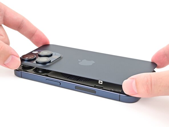

    12. iPhone 15 Pro Max Back Glass Replacement, Swing open the back glass: crwdns2935265:016crwdnd2935265:01crwdnd2935265:03crwdne2935265:0 iPhone 15 Pro Max Back Glass Replacement, Swing open the back glass: crwdns2935265:016crwdnd2935265:02crwdnd2935265:03crwdne2935265:0 iPhone 15 Pro Max Back Glass Replacement, Swing open the back glass: crwdns2935265:016crwdnd2935265:03crwdnd2935265:03crwdne2935265:0
      • Gently swing open the back glass over the right edge of the phone.
      • If the back glass feels stuck, go back around the perimeter to check for missed sections of adhesive or stuck clips.
      • Rest the back glass against a box or similar object so it doesn't strain the cable.

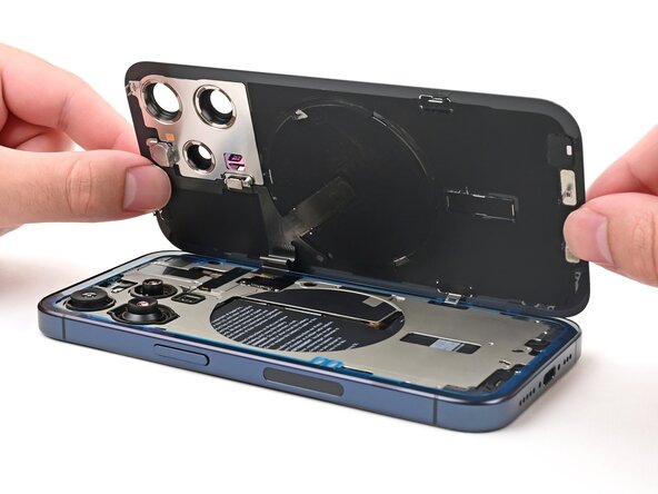

    13. iPhone 15 Pro Max Back Glass Replacement, Remove the wireless charging connector cover: crwdns2935265:017crwdnd2935265:01crwdnd2935265:03crwdne2935265:0 iPhone 15 Pro Max Back Glass Replacement, Remove the wireless charging connector cover: crwdns2935265:017crwdnd2935265:02crwdnd2935265:03crwdne2935265:0 iPhone 15 Pro Max Back Glass Replacement, Remove the wireless charging connector cover: crwdns2935265:017crwdnd2935265:03crwdnd2935265:03crwdne2935265:0
      • Use a tri-point Y000 driver to remove the 1.0 mm‑long screw securing the wireless charging connector cover.
      • Use tweezers to slide the cover out of its slot on the logic board and remove it.
    14. iPhone 15 Pro Max Back Glass Replacement, Disconnect the wireless charging coil: crwdns2935265:018crwdnd2935265:01crwdnd2935265:02crwdne2935265:0 iPhone 15 Pro Max Back Glass Replacement, Disconnect the wireless charging coil: crwdns2935265:018crwdnd2935265:02crwdnd2935265:02crwdne2935265:0
      • Use the tip of an opening pick to pry up and disconnect the wireless charging coil press connector.
      • To reconnect a press connector, align it over its socket and gently press down on one side until it clicks into place, then press down on the other side.

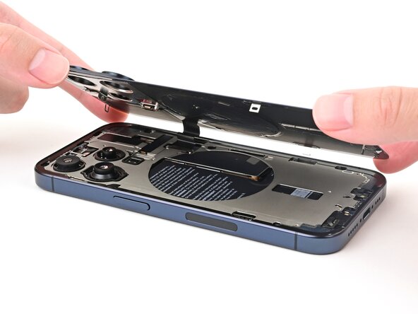

    15. iPhone 15 Pro Max Back Glass Replacement, Remove the back glass: crwdns2935265:019crwdnd2935265:01crwdnd2935265:02crwdne2935265:0 iPhone 15 Pro Max Back Glass Replacement, Remove the back glass: crwdns2935265:019crwdnd2935265:02crwdnd2935265:02crwdne2935265:0
      • Remove the back glass.

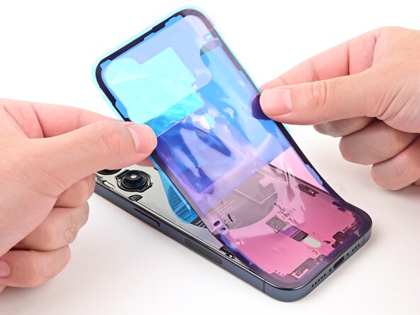

    4. iPhone 15 Pro Max Back Glass Replacement, Orient the replacement adhesive: crwdns2935265:024crwdnd2935265:01crwdnd2935265:01crwdne2935265:0
      • Without peeling any liners, lay the adhesive sheet over the frame to determine its orientation.
      • Use features such as the camera cutout and notches along the edges to visualize how the adhesive will lay on the frame.
    5. iPhone 15 Pro Max Back Glass Replacement, Apply the replacement adhesive: crwdns2935265:025crwdnd2935265:01crwdnd2935265:01crwdne2935265:0
      • Grab the large tab in the bottom corner of the adhesive sheet and begin peeling off the liner that exposes the side that sticks to the frame. Don't remove it all the way.
      • The exposed adhesive is very sticky. Don't let it touch anything until you're ready to apply it to the frame.
      • If your adhesive has multiple liners, peel the liner that exposes the side that sticks to the frame.

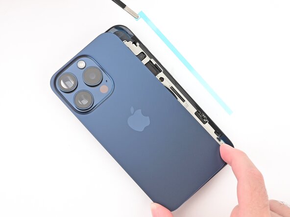

    6. iPhone 15 Pro Max Back Glass Replacement: crwdns2935265:026crwdnd2935265:01crwdnd2935265:03crwdne2935265:0 iPhone 15 Pro Max Back Glass Replacement: crwdns2935265:026crwdnd2935265:02crwdnd2935265:03crwdne2935265:0 iPhone 15 Pro Max Back Glass Replacement: crwdns2935265:026crwdnd2935265:03crwdnd2935265:03crwdne2935265:0
      • Once the adhesive is set into place, you can't reposition it—you'll have to remove it and start over with new adhesive.
      • While holding the back liner out of the way, carefully align the exposed edge of the adhesive to the bottom edge of the iPhone's frame.
      • When the adhesive is aligned, set it down along the bottom edge.

    2. iPhone 15 Pro Max Back Glass Replacement: crwdns2935265:042crwdnd2935265:01crwdnd2935265:03crwdne2935265:0 iPhone 15 Pro Max Back Glass Replacement: crwdns2935265:042crwdnd2935265:02crwdnd2935265:03crwdne2935265:0 iPhone 15 Pro Max Back Glass Replacement: crwdns2935265:042crwdnd2935265:03crwdnd2935265:03crwdne2935265:0
      • If you don't have the iPhone's original box, follow the these two steps for another method to evenly compress the screen.
      • Place the iPhone screen-side-down on a soft, flat surface.
      • Apply tape to the back glass to protect its finish.
      • Place three layers of coins or similarly thick objects on the tape along the edges of the back glass.
      • Evenly distribute the coins and make sure they are at least as thick as the camera bump.
    3. iPhone 15 Pro Max Back Glass Replacement: crwdns2935265:043crwdnd2935265:01crwdnd2935265:01crwdne2935265:0
      • Stack multiple books or other heavy objects on your iPhone.
      • The coins may leave an impression on the bottom object, so don't use anything valuable.
      • Leave the objects in place for at least thirty minutes, ideally overnight.
