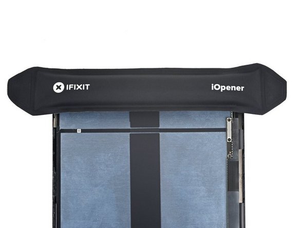

    3. iPad Pro 11" 4th Gen Screen Replacement, Heat the Right Edge: crwdns2935265:03crwdnd2935265:01crwdnd2935265:01crwdne2935265:0
      Clampy - Anti-Clamp
      $24.95
      • Apply a heated iOpener to the right edge of the screen for two minutes.
      • You may use a hair dryer or heat gun but extreme caution should be used because you don't want to over heat any one part of the display.

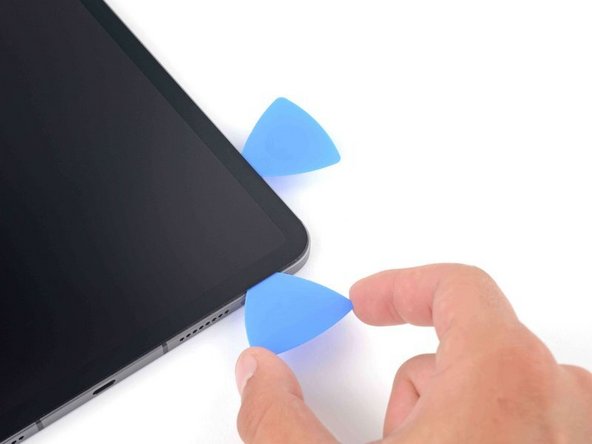

    5. iPad Pro 11" 4th Gen Screen Replacement, Separate the right edge adhesive: crwdns2935265:05crwdnd2935265:01crwdnd2935265:02crwdne2935265:0 iPad Pro 11" 4th Gen Screen Replacement, Separate the right edge adhesive: crwdns2935265:05crwdnd2935265:02crwdnd2935265:02crwdne2935265:0
      • Insert another opening pick right next to the original.
      • Slide the new pick along the right edge to separate the adhesive.
      • When you get close to the volume buttons make sure the pick isn't inserted more than 2mm
      • Leave the pick in the top right corner.
    6. iPad Pro 11" 4th Gen Screen Replacement, Heat the Top Edge: crwdns2935265:06crwdnd2935265:01crwdnd2935265:01crwdne2935265:0
      • Apply the heated iOpener to the top edge of the iPad for two minutes.

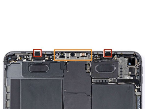

    7. iPad Pro 11" 4th Gen Screen Replacement, Important Information: Top Edge: crwdns2935265:07crwdnd2935265:01crwdnd2935265:02crwdne2935265:0 iPad Pro 11" 4th Gen Screen Replacement, Important Information: Top Edge: crwdns2935265:07crwdnd2935265:02crwdnd2935265:02crwdne2935265:0
      • The top edge contains the camera module, two ambient light sensors, the proximity sensor, and the front microphone. All of these components are fragile and easily damaged if an opening pick is inserted too far.
      • This color indicates the location of the ambient light sensors. Avoid inserting the opening pick more than 2mm to avoid damaging the sensors.
      • This color indicates the location of the camera module, proximity sensor and microphone. Avoid inserting the opening pick more that 1mm to avoid damage.

    10. iPad Pro 11" 4th Gen Screen Replacement, Separate the Bottom Edge Adhesive: crwdns2935265:010crwdnd2935265:01crwdnd2935265:02crwdne2935265:0 iPad Pro 11" 4th Gen Screen Replacement, Separate the Bottom Edge Adhesive: crwdns2935265:010crwdnd2935265:02crwdnd2935265:02crwdne2935265:0
      • Insert pick #4 in the bottom right corner below the original pick.
      • Slide the pick around the bottom right corner taking caution not to insert more than 2mm.

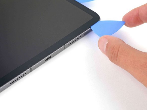

      • Slide the opening pick along the bottom edge, taking care just above the USB-C port.
      • Once the pick has made it to the opposite corner, leave pick #4 right above the USB-C port.
      • Insert opening pick #5 above opening pick #4 and take #5 the rest of the length of the bottom edge and around the left corner. Leave #5 at just above the corner.

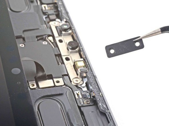

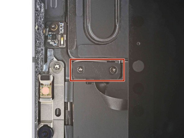

    17. iPad Pro 11" 4th Gen Screen Replacement: crwdns2935265:017crwdnd2935265:01crwdnd2935265:02crwdne2935265:0 iPad Pro 11" 4th Gen Screen Replacement: crwdns2935265:017crwdnd2935265:02crwdnd2935265:02crwdne2935265:0
      • Use a Phillips screwdriver to remove the two screws securing the ambient light sensor bracket to the logic board.
      • One 1.3 mm screw
      • One 2.0 mm screw
      • Use a pair of tweezers or your fingers to remove the bracket.

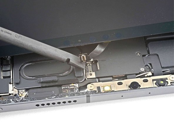

    18. iPad Pro 11" 4th Gen Screen Replacement, Disconnect the Ambient Light Sensor Cable: crwdns2935265:018crwdnd2935265:01crwdnd2935265:02crwdne2935265:0 iPad Pro 11" 4th Gen Screen Replacement, Disconnect the Ambient Light Sensor Cable: crwdns2935265:018crwdnd2935265:02crwdnd2935265:02crwdne2935265:0
      • Use the flat end of a spudger to disconnect the ambient light sensor cable by lifting straight up on the press connectors.

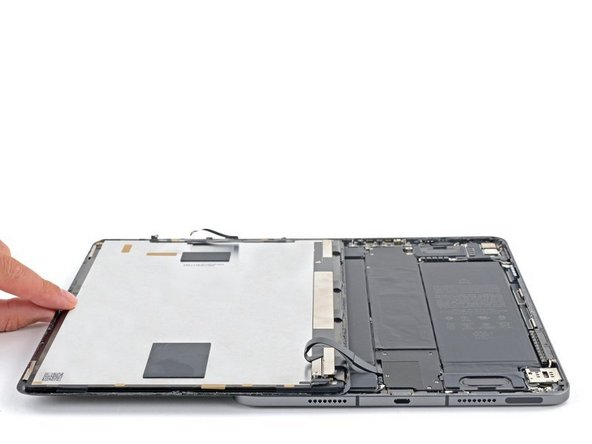

    19. iPad Pro 11" 4th Gen Screen Replacement, Reposition the Screen: crwdns2935265:019crwdnd2935265:01crwdnd2935265:03crwdne2935265:0 iPad Pro 11" 4th Gen Screen Replacement, Reposition the Screen: crwdns2935265:019crwdnd2935265:02crwdnd2935265:03crwdne2935265:0 iPad Pro 11" 4th Gen Screen Replacement, Reposition the Screen: crwdns2935265:019crwdnd2935265:03crwdnd2935265:03crwdne2935265:0
      • The screen is still attached by one more ribbon cable - do not try to remove it yet.
      • Holding the right edge of the screen, open the iPad like a book.
      • In order to not strain the ribbon cable let the screen rest over the left side of the iPad.

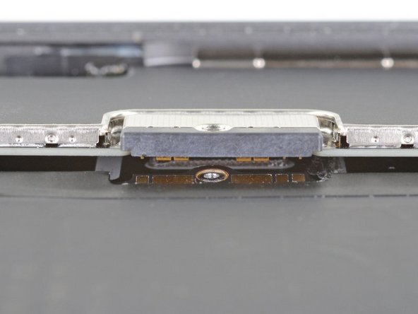

    21. iPad Pro 11" 4th Gen Screen Replacement, Unscrew Battery Connector: crwdns2935265:021crwdnd2935265:01crwdnd2935265:01crwdne2935265:0
      • Use a Phillips screwdriver to remove the 1.8 mm screw securing the battery connector to the logic board.

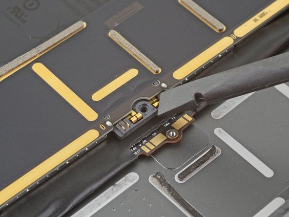

    22. iPad Pro 11" 4th Gen Screen Replacement, Important Information: Battery Reference: crwdns2935265:022crwdnd2935265:01crwdnd2935265:03crwdne2935265:0 iPad Pro 11" 4th Gen Screen Replacement, Important Information: Battery Reference: crwdns2935265:022crwdnd2935265:02crwdnd2935265:03crwdne2935265:0 iPad Pro 11" 4th Gen Screen Replacement, Important Information: Battery Reference: crwdns2935265:022crwdnd2935265:03crwdnd2935265:03crwdne2935265:0
      • These photos show what the battery connector looks like underneath the logic board. Use these photos as a reference while you safely disconnect the battery.
      • Notice that the battery connector has cantilever springs on the logic board that press against the battery contact pads. Since both the logic board and battery are glued down, you'll need to slide something thin and flexible between the contact points to disconnect the battery.

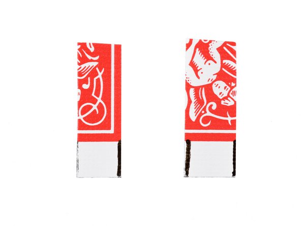

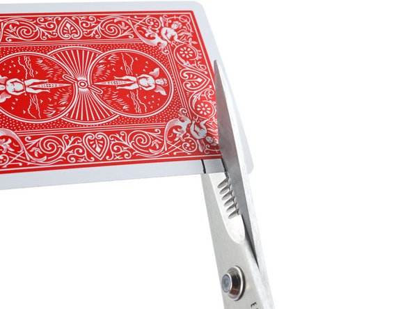

    23. iPad Pro 11" 4th Gen Screen Replacement, Create a battery blocker: crwdns2935265:023crwdnd2935265:01crwdnd2935265:03crwdne2935265:0 iPad Pro 11" 4th Gen Screen Replacement, Create a battery blocker: crwdns2935265:023crwdnd2935265:02crwdnd2935265:03crwdne2935265:0 iPad Pro 11" 4th Gen Screen Replacement, Create a battery blocker: crwdns2935265:023crwdnd2935265:03crwdnd2935265:03crwdne2935265:0
      • You need to place a barrier between the battery connector and logic board to disconnect the battery. Follow this step to create a battery blocker out of a playing card.
      • Cut two 6 mm-wide strips from a playing card to block the connections to the battery.

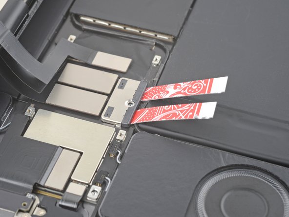

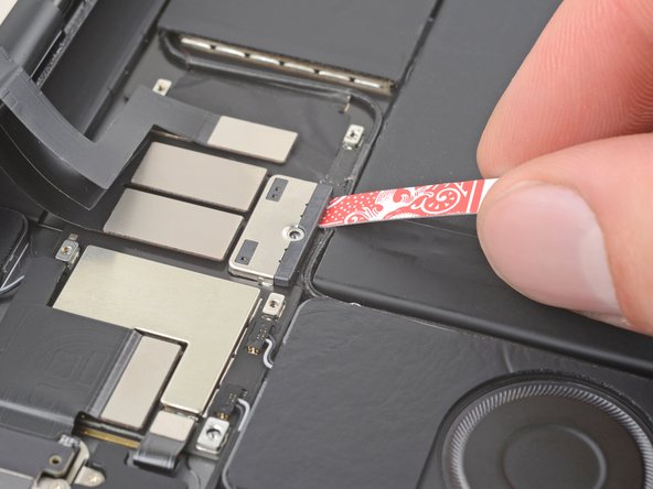

    24. iPad Pro 11" 4th Gen Screen Replacement, Insert the card strips: crwdns2935265:024crwdnd2935265:01crwdnd2935265:03crwdne2935265:0 iPad Pro 11" 4th Gen Screen Replacement, Insert the card strips: crwdns2935265:024crwdnd2935265:02crwdnd2935265:03crwdne2935265:0 iPad Pro 11" 4th Gen Screen Replacement, Insert the card strips: crwdns2935265:024crwdnd2935265:03crwdnd2935265:03crwdne2935265:0
      • Insert the card strips under each side of the battery connector.
      • If you can't slide the cards under the battery connector, use an opening pick to gently lift the connector to help insert the card strips.
      • Don't pry or lift the connector too much—it's soldered onto the logic board and may break if stressed.

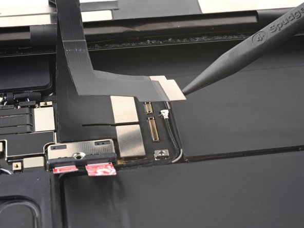

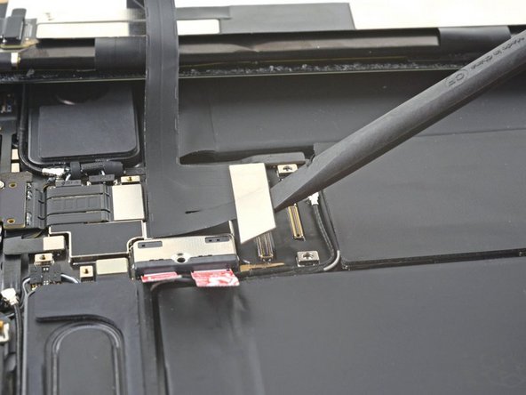

    25. iPad Pro 11" 4th Gen Screen Replacement, Disconnect Display Cables: crwdns2935265:025crwdnd2935265:01crwdnd2935265:03crwdne2935265:0 iPad Pro 11" 4th Gen Screen Replacement, Disconnect Display Cables: crwdns2935265:025crwdnd2935265:02crwdnd2935265:03crwdne2935265:0 iPad Pro 11" 4th Gen Screen Replacement, Disconnect Display Cables: crwdns2935265:025crwdnd2935265:03crwdnd2935265:03crwdne2935265:0
      • Using the pointed end of a spudger, disconnect the bottom two display cables.
      • Using the pointed end of a spudger disconnect the top two display cables.

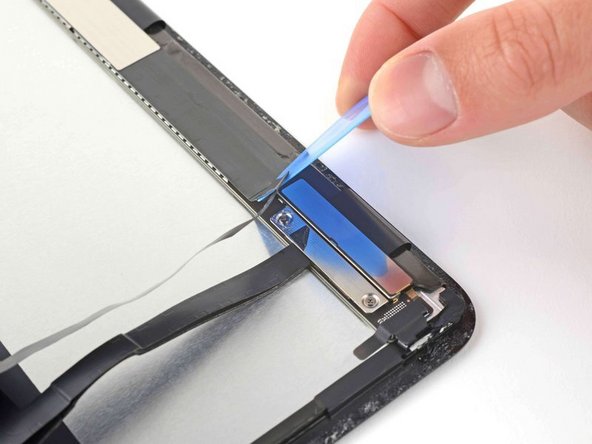

    27. iPad Pro 11" 4th Gen Screen Replacement, LiDAR Removal: crwdns2935265:027crwdnd2935265:01crwdnd2935265:02crwdne2935265:0 iPad Pro 11" 4th Gen Screen Replacement, LiDAR Removal: crwdns2935265:027crwdnd2935265:02crwdnd2935265:02crwdne2935265:0
      • The LiDAR sensor assembly is paired to the Face ID hardware. You'll need to transfer it to your replacement screen to keep Face ID functionality. The following steps show how to remove the sensor assembly and install it on your replacement screen.
      • Ambient Light Sensors (2)
      • Microphone
      • Proximity Sensor
      • The ribbon cable that connects these sensors is very thin and delicate, take your time and be careful with removal.
      • Prepare an iOpener. Leave it in place at the top of the display for two minutes.

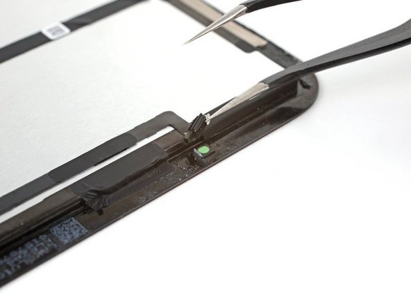

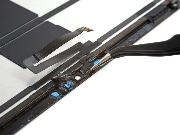

    28. iPad Pro 11" 4th Gen Screen Replacement, Ambient Light Sensors: crwdns2935265:028crwdnd2935265:01crwdnd2935265:02crwdne2935265:0 iPad Pro 11" 4th Gen Screen Replacement, Ambient Light Sensors: crwdns2935265:028crwdnd2935265:02crwdnd2935265:02crwdne2935265:0
      • Using a pair of tweezers, insert one arm between the ambient light sensor and the screen.
      • Gently pry the sensor up from the screen. This may take considerable force.
      • Repeat these steps with the other ambient light sensor.

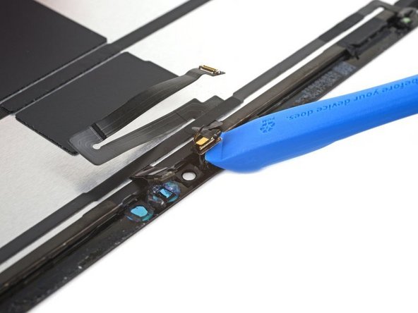

    29. iPad Pro 11" 4th Gen Screen Replacement, Proximity Sensor: crwdns2935265:029crwdnd2935265:01crwdnd2935265:02crwdne2935265:0 iPad Pro 11" 4th Gen Screen Replacement, Proximity Sensor: crwdns2935265:029crwdnd2935265:02crwdnd2935265:02crwdne2935265:0
      • Reheat & reapply your iOpener
      • Using the same method that we used with the ambient light sensor, use one arm of the tweezers to slip under the ribbon cable and gently pry up.
    30. iPad Pro 11" 4th Gen Screen Replacement, Microphone: crwdns2935265:030crwdnd2935265:01crwdnd2935265:02crwdne2935265:0 iPad Pro 11" 4th Gen Screen Replacement, Microphone: crwdns2935265:030crwdnd2935265:02crwdnd2935265:02crwdne2935265:0
      • There may be tape covering the microphone.
      • Slide the opening tool under the microphone to separate the adhesive.
      • Pry up to separate the microphone from the screen.

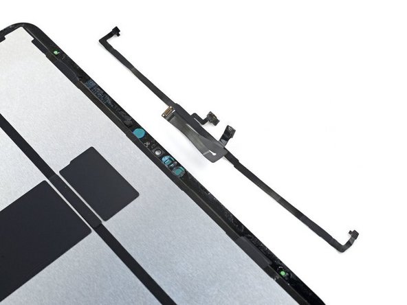

    31. iPad Pro 11" 4th Gen Screen Replacement, LiDar Cable Removal Procedure: crwdns2935265:031crwdnd2935265:01crwdnd2935265:01crwdne2935265:0
      • Slide an opening pick under the LiDAR sensor assembly cable to separate it from the screen.
      • Exercise caution while separating this cable to avoid tearing it.
    32. iPad Pro 11" 4th Gen Screen Replacement, Remove the LiDAR Cable: crwdns2935265:032crwdnd2935265:01crwdnd2935265:02crwdne2935265:0 iPad Pro 11" 4th Gen Screen Replacement, Remove the LiDAR Cable: crwdns2935265:032crwdnd2935265:02crwdnd2935265:02crwdne2935265:0
      • Continue to use the opening pick to separate the LiDAR cable from the screen.

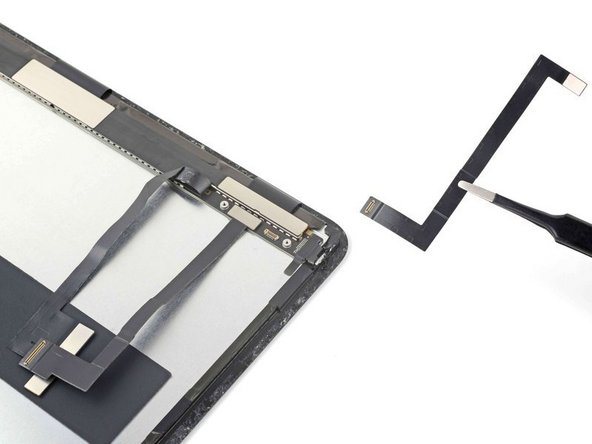

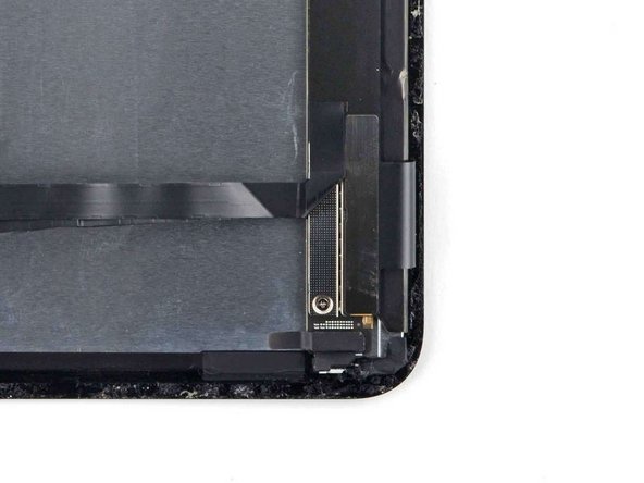

    33. iPad Pro 11" 4th Gen Screen Replacement, Lower Display Cable Transfer: crwdns2935265:033crwdnd2935265:01crwdnd2935265:02crwdne2935265:0 iPad Pro 11" 4th Gen Screen Replacement, Lower Display Cable Transfer: crwdns2935265:033crwdnd2935265:02crwdnd2935265:02crwdne2935265:0
      • Some display replacements come without display cables attached. If this is the case, you will need to remove the display cables from your original display.
      • The bracket in the bottom right corner of the display is covering the display cable connectors.
    34. iPad Pro 11" 4th Gen Screen Replacement, Separate Display Cable: crwdns2935265:034crwdnd2935265:01crwdnd2935265:02crwdne2935265:0 iPad Pro 11" 4th Gen Screen Replacement, Separate Display Cable: crwdns2935265:034crwdnd2935265:02crwdnd2935265:02crwdne2935265:0
      • Use an opening pick to remove the small section of the upper display cable that is attached to the bracket.

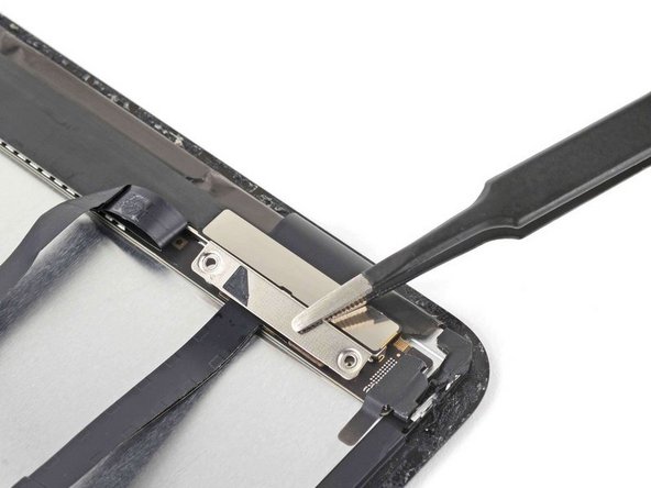

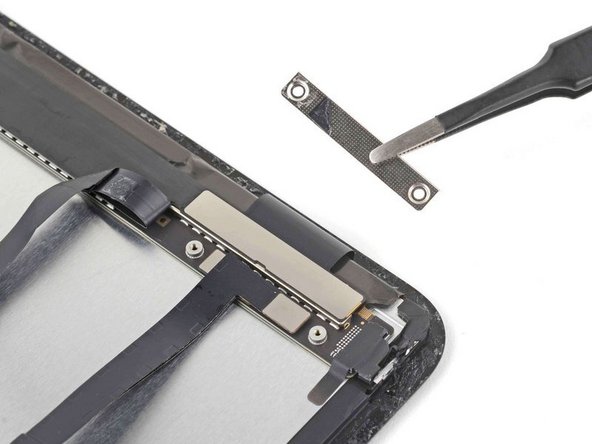

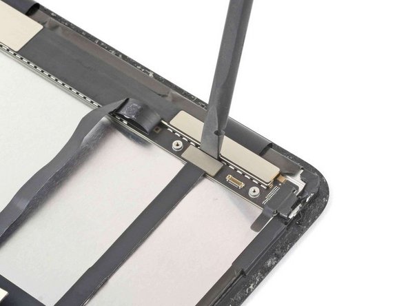

    35. iPad Pro 11" 4th Gen Screen Replacement, Remove the Bracket: crwdns2935265:035crwdnd2935265:01crwdnd2935265:03crwdne2935265:0 iPad Pro 11" 4th Gen Screen Replacement, Remove the Bracket: crwdns2935265:035crwdnd2935265:02crwdnd2935265:03crwdne2935265:0 iPad Pro 11" 4th Gen Screen Replacement, Remove the Bracket: crwdns2935265:035crwdnd2935265:03crwdnd2935265:03crwdne2935265:0
      • Use a Phillips screwdriver to remove the two 1.2mm screws securing the display cable bracket.
      • Using a pair of tweezers remove the lower display cable bracket.
    36. iPad Pro 11" 4th Gen Screen Replacement, Disconnect & Remove Display Cables: crwdns2935265:036crwdnd2935265:01crwdnd2935265:03crwdne2935265:0 iPad Pro 11" 4th Gen Screen Replacement, Disconnect & Remove Display Cables: crwdns2935265:036crwdnd2935265:02crwdnd2935265:03crwdne2935265:0 iPad Pro 11" 4th Gen Screen Replacement, Disconnect & Remove Display Cables: crwdns2935265:036crwdnd2935265:03crwdnd2935265:03crwdne2935265:0
      • Using flat end of a spudger, pry up and disconnect the narrow display cable.
      • Set the cable aside to connect to your new display.
      • Repeat this process with the wider display cable.
