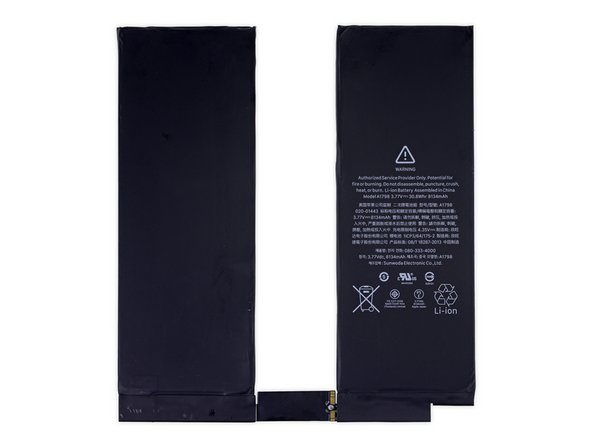

  13. iPad Pro 10.5" Teardown: crwdns2935265:013crwdnd2935265:01crwdnd2935265:03crwdne2935265:0 iPad Pro 10.5" Teardown: crwdns2935265:013crwdnd2935265:02crwdnd2935265:03crwdne2935265:0 iPad Pro 10.5" Teardown: crwdns2935265:013crwdnd2935265:03crwdnd2935265:03crwdne2935265:0
    • Because of the pull-tab adhesive securing its battery, we deemed the original iPad Pro the first really recyclable iPad. Hoping for lightning to strike twice, we apprehensively peel up some tape on the edge of the battery.
    • Foiled! More plastic spacers, and only nasty gooey adhesive instead of nice clean peel-out stickums.
    • How about next time Apple? Cherry on top?
    • This Pro gets a 3.77 V, 8134 mAh, 30.8 Wh battery—a slight downsize from the 38.8 Wh battery found in the 12.9", but an upgrade from the 27.91 Wh battery in the 9.7".
