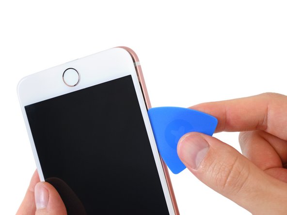

    • Apple may have gotten rid of the headphone jack, but clearly stays loyal to the Pentalobe. Two now-familiar screws guard each side of the Lightning connector.
    • Eager to see past the rose gold exterior, we perform some forceful iSclack-ing and a great deal of prying to get past the intense adhesive.
    • The adhesive strip sealing the 7 Plus is considerably stronger than the strip we found in its predecessor. Could this be our first sign of waterproofing?
  5. iPhone 7 Plus Teardown: crwdns2935265:05crwdnd2935265:01crwdnd2935265:02crwdne2935265:0 iPhone 7 Plus Teardown: crwdns2935265:05crwdnd2935265:02crwdnd2935265:02crwdne2935265:0
    • What is this madness? The 7 Plus bizarrely opens to the side, despite the familiar clips at the top of the phone that help align the display as in previous models.
    • We got lucky and didn't rip the display cables along the middle-right side. Thankfully, the top cable has some slack.
    • Subtle design changes like this are where repair guides come in handy.
    • Opening the 7 Plus reveals lots of black and white gooey adhesives running along the perimeter of the phone.
    • Our bet is that this penguin-themed stickiness is part of Apple's efforts to add water resistance. Then again, Apple's engineers might just really love glue.

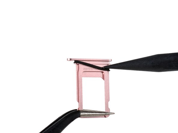

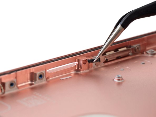

  19. iPhone 7 Plus Teardown: crwdns2935265:020crwdnd2935265:01crwdnd2935265:03crwdne2935265:0 iPhone 7 Plus Teardown: crwdns2935265:020crwdnd2935265:02crwdnd2935265:03crwdne2935265:0 iPhone 7 Plus Teardown: crwdns2935265:020crwdnd2935265:03crwdnd2935265:03crwdne2935265:0
    • Water resistance has been touted as a big new feature in the iPhone 7 Plus—but what actually makes it water resistant? The evidence is everywhere:
    • Figures 1 and 2: a plastic SIM eject plug with a rubber gasket.
    • Figure 3: a rubber gasket on the SIM tray.
    • Rubber gaskets and plugs aren't new technology, but they are effective at keeping liquids and dust out of your phone. But there's a cost—when you replace a component you'll need to make sure you get the gasket in place and that it creates a good seal, which tends to be an extra, finicky step.
