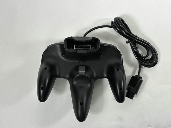

    • Turn the controller face down.
    • Use a Phillips #00 screwdriver to remove the eight screws on the back of the controller.

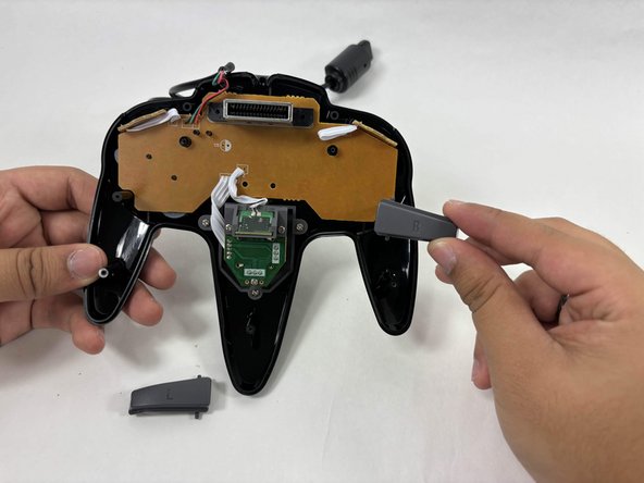

  3. iNNEXT N64 Classic Controller Joystick Cover Replacement, Shoulder Buttons: crwdns2935265:03crwdnd2935265:01crwdnd2935265:02crwdne2935265:0 iNNEXT N64 Classic Controller Joystick Cover Replacement, Shoulder Buttons: crwdns2935265:03crwdnd2935265:02crwdnd2935265:02crwdne2935265:0
    • To remove the shoulder buttons, lift the buttons labelled with "L" and "R" upwards and out of the controller. There should not be any resistance coming out.
    • To add the new buttons, put the top notch of the shoulder buttons into the hole right above the control circuit. There should not be any resistance going in. Once done, you can put the back of the controller back on

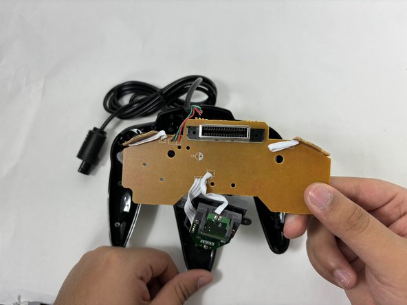

    • Use a Phillips screwdriver to remove the 6 screws securing the joystick assembly to the top of the controller.
    • Gently lift the control panel and joystick assembly from the top cover of the controller.
    • Flip the control panel along with the attached joystick assembly over so that they are facing you.

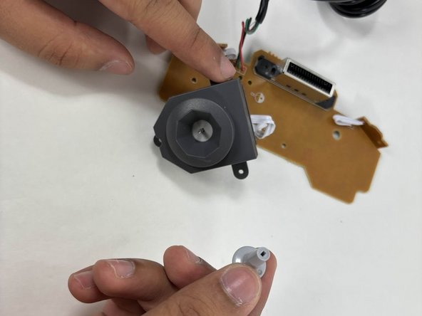

    • Pull the joystick cover straight up from the joystick assembly.
    • It should come off with very little resistance.
    • Once the cover has been removed there should be an exposed rod.
