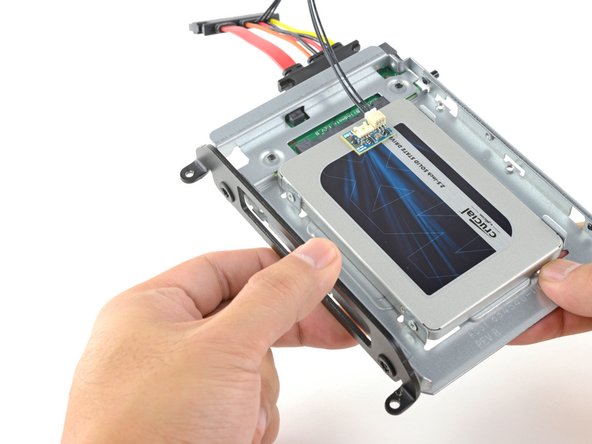

    1. iMac Intel 27" Retina 5K Display Hard Drive Replacement, Replace the hard drive with an SSD: crwdns2935265:032crwdnd2935265:01crwdnd2935265:03crwdne2935265:0 iMac Intel 27" Retina 5K Display Hard Drive Replacement, Replace the hard drive with an SSD: crwdns2935265:032crwdnd2935265:02crwdnd2935265:03crwdne2935265:0 iMac Intel 27" Retina 5K Display Hard Drive Replacement, Replace the hard drive with an SSD: crwdns2935265:032crwdnd2935265:03crwdnd2935265:03crwdne2935265:0
      • Follow the remaining steps if you are replacing your hard drive with an SSD kit.
      • If your SSD enclosure looks like the first image, follow this guide instead.
      • Line up the SSD connectors with the metal enclosure's sockets.
      • Press the drive against the enclosure sockets until the SSD is firmly seated.
      • The SSD connects with the enclosure in only one direction. If the connectors don't line up, rotate the SSD and try again.
    2. iMac Intel 27" Retina 5K Display Hard Drive Replacement: crwdns2935265:033crwdnd2935265:01crwdnd2935265:03crwdne2935265:0 iMac Intel 27" Retina 5K Display Hard Drive Replacement: crwdns2935265:033crwdnd2935265:02crwdnd2935265:03crwdne2935265:0 iMac Intel 27" Retina 5K Display Hard Drive Replacement: crwdns2935265:033crwdnd2935265:03crwdnd2935265:03crwdne2935265:0
      • Use a Phillips screwdriver to install the four silver screws (two on each side) along the edges of the SSD to secure it to the enclosure.
    3. iMac Intel 27" Retina 5K Display Hard Drive Replacement: crwdns2935265:034crwdnd2935265:01crwdnd2935265:02crwdne2935265:0 iMac Intel 27" Retina 5K Display Hard Drive Replacement: crwdns2935265:034crwdnd2935265:02crwdnd2935265:02crwdne2935265:0
      • Plug the included sensor-enabled combo cable into the enclosure's port.
      • The cable is keyed to connect in only one orientation. If you can't connect the cable, rotate it 180° and try again.
    4. iMac Intel 27" Retina 5K Display Hard Drive Replacement: crwdns2935265:035crwdnd2935265:01crwdnd2935265:03crwdne2935265:0 iMac Intel 27" Retina 5K Display Hard Drive Replacement: crwdns2935265:035crwdnd2935265:02crwdnd2935265:03crwdne2935265:0 iMac Intel 27" Retina 5K Display Hard Drive Replacement: crwdns2935265:035crwdnd2935265:03crwdnd2935265:03crwdne2935265:0
      • Peel the white liner off the back of the small temperature sensor board in order to expose the adhesive.
      • Adhere the temperature sensor board to an exposed, metal surface of the SSD, close to the SATA connector.
      • Fold the excess temperature sensor wires so that they are out of the way while you install the enclosure.
    5. iMac Intel 27" Retina 5K Display Hard Drive Replacement: crwdns2935265:036crwdnd2935265:01crwdnd2935265:02crwdne2935265:0 iMac Intel 27" Retina 5K Display Hard Drive Replacement: crwdns2935265:036crwdnd2935265:02crwdnd2935265:02crwdne2935265:0
      • Use a T8 driver to install the mounting pins from the old hard drive onto the sides of the enclosure.
    6. iMac Intel 27" Retina 5K Display Hard Drive Replacement: crwdns2935265:037crwdnd2935265:01crwdnd2935265:02crwdne2935265:0 iMac Intel 27" Retina 5K Display Hard Drive Replacement: crwdns2935265:037crwdnd2935265:02crwdnd2935265:02crwdne2935265:0
      • Attach any mounting brackets removed from the old hard drive onto the enclosure.
    7. iMac Intel 27" Retina 5K Display Hard Drive Replacement: crwdns2935265:038crwdnd2935265:01crwdnd2935265:02crwdne2935265:0 iMac Intel 27" Retina 5K Display Hard Drive Replacement: crwdns2935265:038crwdnd2935265:02crwdnd2935265:02crwdne2935265:0
      • Connect the iMac's combo cable to the new temperature-enabled combo cable.
    8. iMac Intel 27" Retina 5K Display Hard Drive Replacement: crwdns2935265:039crwdnd2935265:01crwdnd2935265:03crwdne2935265:0 iMac Intel 27" Retina 5K Display Hard Drive Replacement: crwdns2935265:039crwdnd2935265:02crwdnd2935265:03crwdne2935265:0 iMac Intel 27" Retina 5K Display Hard Drive Replacement: crwdns2935265:039crwdnd2935265:03crwdnd2935265:03crwdne2935265:0
      • The images used in this step come from a 2017 iMac. Your cables may look slightly different, but the procedure remains the same.
      • Slide the SSD enclosure into the space previously occupied by the hard drive.
      • Route the cables so that they will not interfere with any other components.
      • Try to keep the cables free from any sharp bends, and route them such that they are not pinched.
